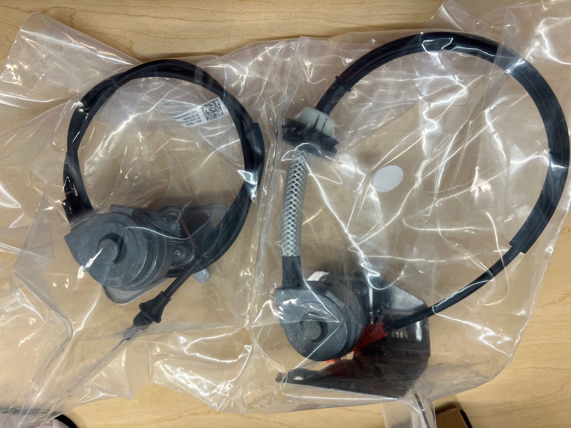

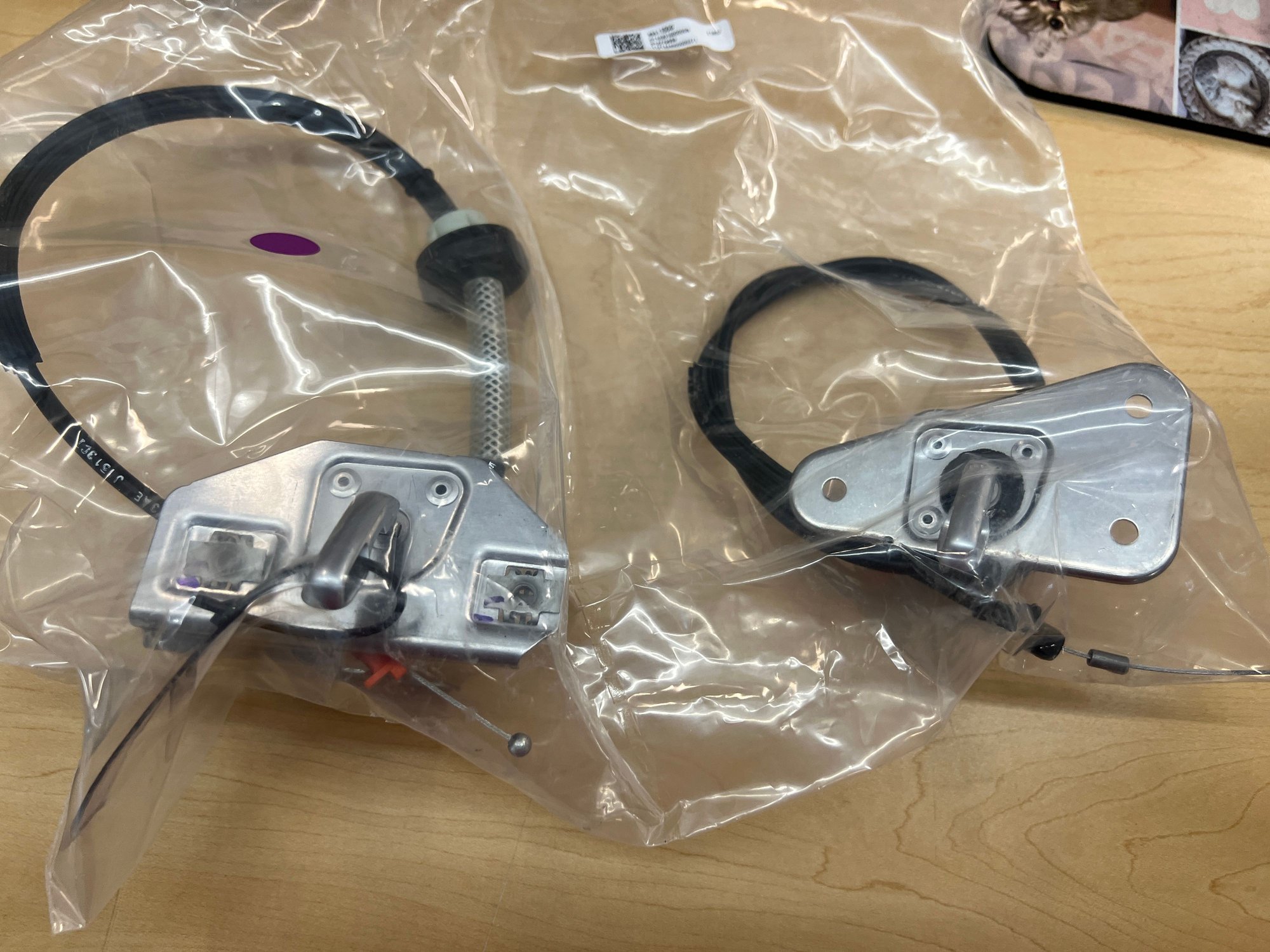

Here is GM #85511550 - apparently it contains TWO emergency latch assemblies - guessing the 3 hole version is for convertible (?) and the 2 hole is for coupe?
Does anyone have a MY22 convertible or coupe to confirm how it is attached?

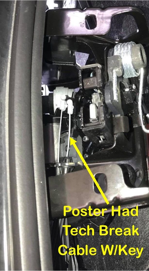

Since you already pulled the truck liner back (as Tech did to repair my latch without removing the bumper) you can see where the "improved approach" outlined below might be easy to implement. Instead of cables or twine use a ~3/32-inch diameter ridged rod. Attach to the Kiddy Pull behind the Trunk Liner and thru small holes in the truck liner and right rear wheel well liner. It will probably have to be bent slightly but as it's a ridged rod not a problem. Still just pull the protruding end to unlatch. Could bend exposed end down if desired.
I don't see a big security problem as an issue as expect many would not be using this approach AND agree GM would not implement. Crooks are not likely to remove a wheel to see it one is installed! In addition, no need to typically store valuables, which can be put in the Frunk. Gaining access to the truck does NOT gain access to the passenger compartment.

1605411743[/url]]Here is GM #85511550 - apparently it contains TWO emergency latch assemblies - guessing the 3 hole version is for convertible (?) and the 2 hole is for coupe?
Will try to find a diagram but have not been successful yet.
It looks like it comes with a key already in the lock mechanism?

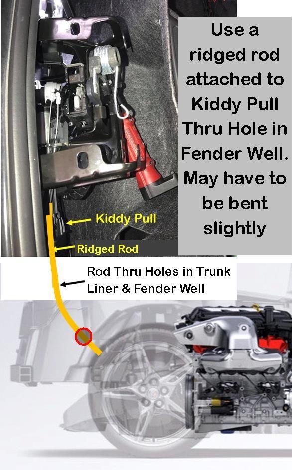

This is the solution proposed for 2023 folks today. Should not be hard to fabricate.
Top pic made when Tech was replacing the key parts of my 2020 latch when it failed to open. Suggstion is using a rodbehind the truck liner attached to the Kiddy Pull and tip extending out the rear fender well.
Yes - both assemblies have keys.
The sealed plastic back has a QR code for GM #85511550.
But the two assemblies appear to be GM #85511550 AND GM
84811998 (?) - I'm going by visual.
The 84811998 is not marked on the plastic bag.
Any idea how it is keyed? Is it keyed to your car by VIN? I Wonder why they sent two assemblies.
I just opened the 3 hole assembly. Different key - not keyed using my VIN. Tested my key just for grins - doesn't turn cylinder.
