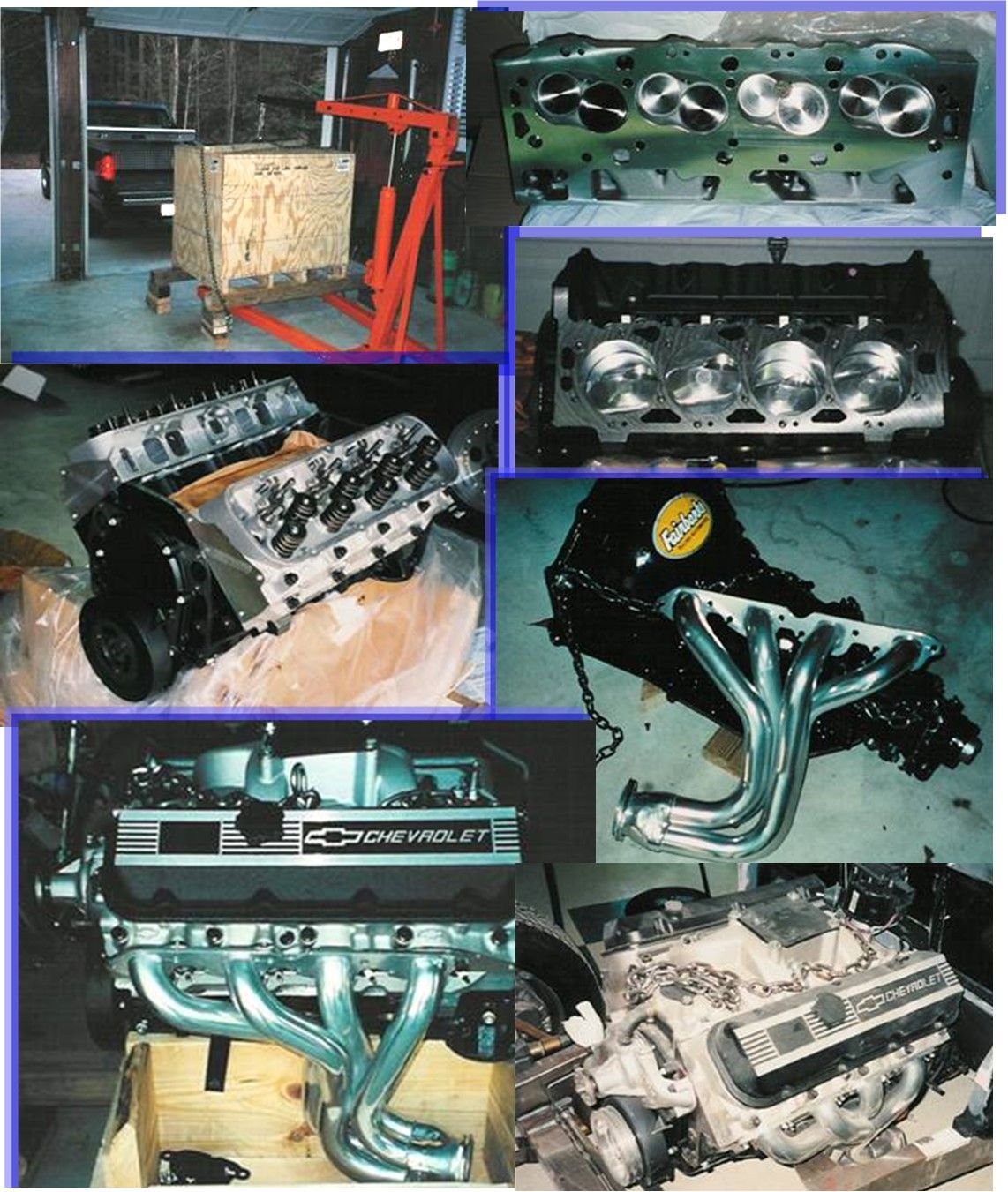

Now engineers can use other than standard starter motors. Below is a pic of the GM ZZ502 8.2 Liter high compression engine in my street rod. They know folks (as I did) use long tube headers that hug the engine, close to the starter. In fact mine are so close I installed insulated blanket around the starter motor sold for the purpose. It uses a small diameter starter motor How do they get enough torque to start that high compression 502 cid engine? By having a 5:1 gear ratio compared to no gear on a standard starter motor. More money but no issue turning over that BB when it's hot!
Pic of opposite side of 8,2 Liter GM Crate Motor than where the starter motor is located. The long tube headers fit close to the block and are close to the starter motor. Starter motor a small diameter and uses a 5:1 gear ratio to increase torque.
