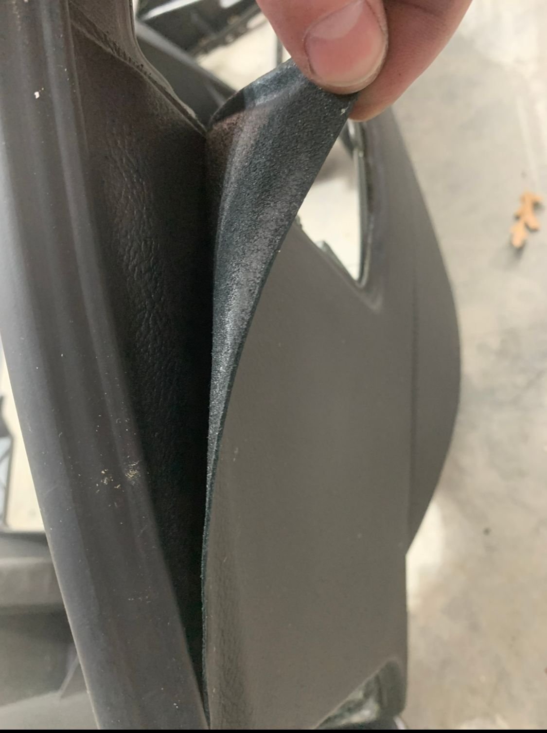

Wonder if anyone has posted any pictures of the backing of the leather used in the 3LT trim?
Is the bonded leather backed with a cloth material? Is the backer coming delaminated from the "leather" or is it failing at the adhesive between the plastic panel and the backing of the bonded leather?
There's a crap ton of postings about dash peeling / delamination for 3LT and lots of pictures, but I don't see any detailed pictures showing the backside of the leather or the adhesive itself.

This is my C6 so can't comment if the backing on the C8 is the same. My dash had evidence of 4-5 thin lines of adhesive across the entire dash, that was it. The front edge wasn't wrapped but actually cut short of the edge of the dash and covered by this rubber trim piece.
contrast that to the a-pillars that are both wrapped and stapled.
