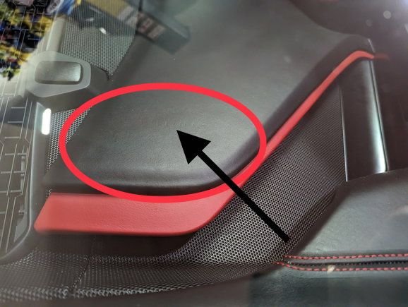

My dash has fixed itself out in the sun, was going to use a needle with epoxy but the bubble is not visible at all.
bubble
no bubble

mine started out that way depending on temperature, eventually it got worse. Just get it replaced before warranty is over and save the hassle.You saving GM money won't help the situation.

it looks like this line is the issue. It's what mine looked like before it started coming up.
My C6 3LZ dash.

that's where the dash slopes up which is where the leather pulls hardest from the surface,

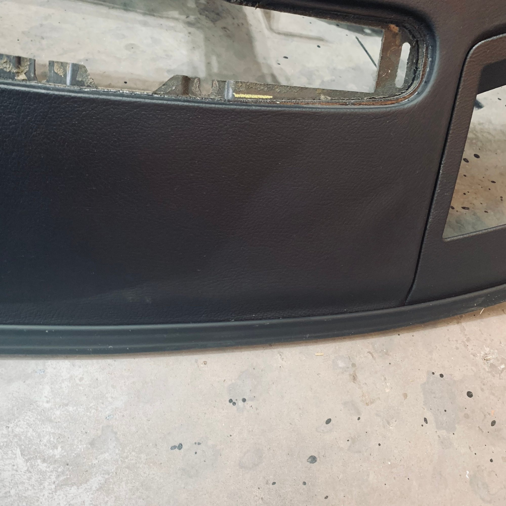

I had the dash bubbling issue also, 3LT with black HXO interior, both on the dash panel above the instrument cluster and on the upper left side of the passenger dash panel. My dealer replaced both panels under warranty.
The passenger side air bag also was replaced - evidently the original airbag cannot be reused after the passenger side dash panel is pulled off.
Normally I park in the garage, but last year we had extensive home renovations and my garage was filled with construction equipment/supplies. So, I parked in the driveway all spring and summer in the Florida heat. The issue occurred around the end of summer.
I first contacted my dealer about the issue in September. The dealer's initial response was that they would need to inspect the dash to determine whether any chemicals had been applied to the leather and, if so, it would not be covered under warranty - evidently chemicals applied to the leather contribute to the issue. I had used leather cleaner/conditioner on it, so I thought I might be in for a battle. My manual says to clean the leather with soap and water, but does not specify what type of soap to use. My position is that most people cleaning leather in an expensive car are going to use a cleaning agent specifically formulated for leather, and thus my leather was cleaned in accordance with the manual.
The dealer where I bought my car is about an hour a way, and a dealer closer to me did not want to deal with the issue since I bought the car elsewhere. So, I ended up kicking the can down the road until it was time for my next free oil change where I bought the car. I scheduled an appointment for the oil change and for the dash to be inspected. With me I brought a printout of the pertinent pages of the manual and the leather cleaner/conditioner I had used, prepared for battle over the warranty issue. To my pleasant surprise, the service advisor took one look at the dash and said it was covered under warranty, with no further questions asked. Moreover, they had the dash panels for my interior in stock. I did end up having to wait a couple of days for them to get a new airbag, though.
Between the time I first contacted the dealer and the time I took my car in for service, the dealer's position on covering the dash under warranty seems to have softened. Perhaps it is a known issue, and perhaps GM issued a service bulletin. I don't know. Anyway, I am glad to have it fixed, and glad that it went smoothly without any hassle other than having to leave the car overnight.

Mine was garaged when not used. Started bubbling about 6 months from warranty expiration. It is NOT and early failure. 3 pieces ordered plus the airbag. Took a month to come in and 1 day install,
My C7 started bubbling right after the expiration. Took the case to the zone office and was eventually fixed under warranty.
