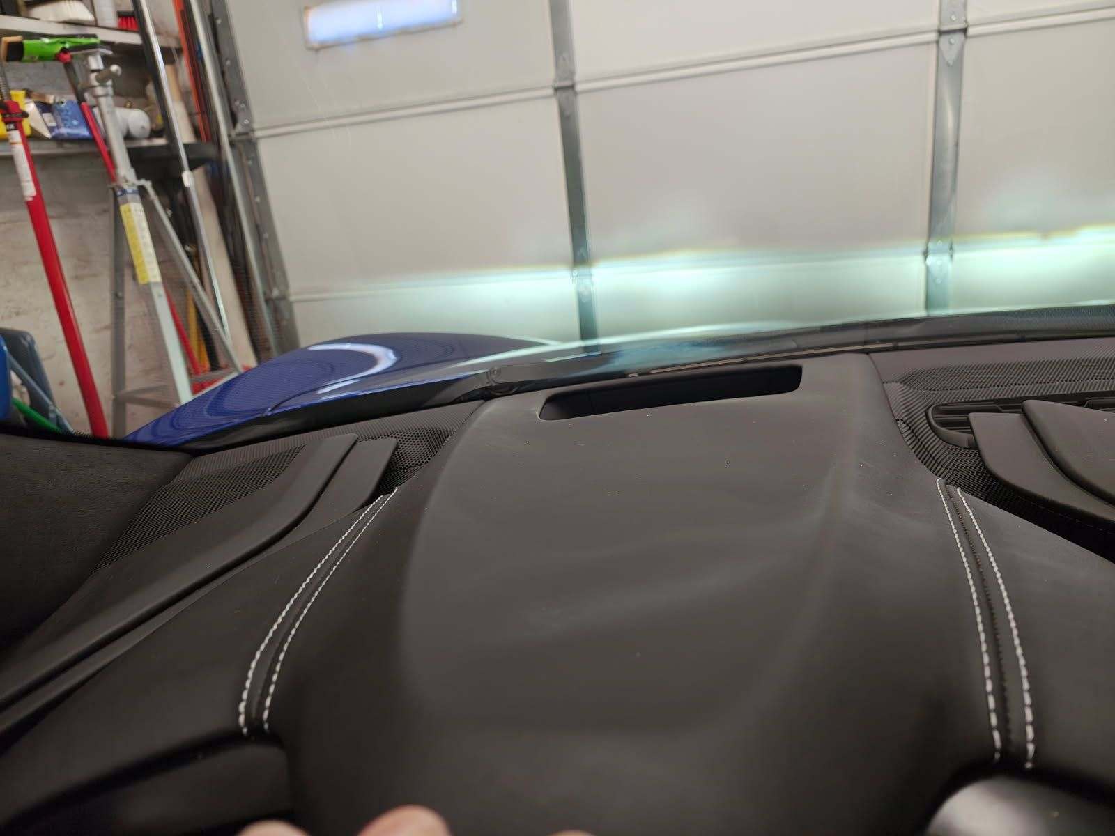

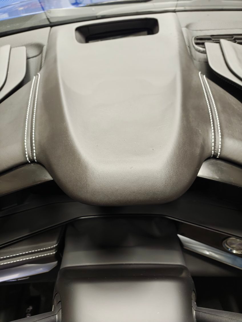

Here is the before and after photos. I will probably get the LT2 cover in the future.
Before, Somehow I missed it when I looked at the dash.
After no-bubbles. Works for now.
After no-bubbles. I think I can make the holes disappear with little heat. Works for now.
