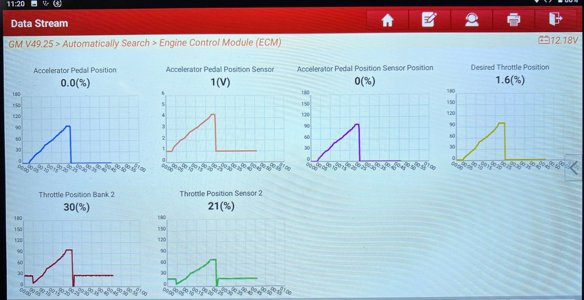

I finally got around to datalogging a few things with the Soler Throttle Controller. These were captured on my scanner while making a steady and constant rate sweep of the pedal from closed throttle to WOT.
The first two show the controller set to OEM. The last was captured with the controller set to sport 2.
I had a battery tender hooked up and just powered the car on - I guess in my mode. So, this was all done with the key on, engine off. Two things should be apparent: with no correction in OEM, it looks like the throttle position follows the pedal position in a linear fashion and in sport 2, all the logs show a faster response, but then there is an area where all the parameters drop and it takes a fair amount of pedal travel to get back to the drop off point which would seem to give a corresponding amount of dead pedal where nothing is happening.
Anyway, here they are:

What you're seeing is what it's programmed to do. It can be remapped in seconds.
It interesting to show folks what it doesn't do too .
As you can see the do not cure throttle lag as many people often mistake.
You can't cure throttle lag by signal manipulation. 2x0=0.
But what they do is remove linearity....aka the ability to modulate the throttle. Not a good thing for actual performance driving but great for puttsing around town and giving it 30 percent accelerator pressure and feeling 50 percent throttle opening.
Not disparaging them at all as I can see the allure for some people.
It's a cool illustration of how I explain they work to folks.

Not quite…. Remember this was done with the engine not running. There is a breakpoint between closed/no throttle and part throttle. With the engine not running, the throttles are held open a small amount. Once the engine fires and exceeds a minimum engine speed, the ECM transitions from crank mode to running mode and the throttle position is then controlled to give a desired RPM. The drop in the throttle position you see on the graphs is not lag, rather it is the point of transition from idle to part throttle. The graph would look different with the engine running.

Ive programmed them. What you're seeing there youll see with the engine running. These are voltage modifiers. They modify the OEM voltage signal. They can't remove tip in delay. They can increase ramp up on the signal. They definitely do what they're intended which is to feel the immediate power by just lightly touching the pedal.
