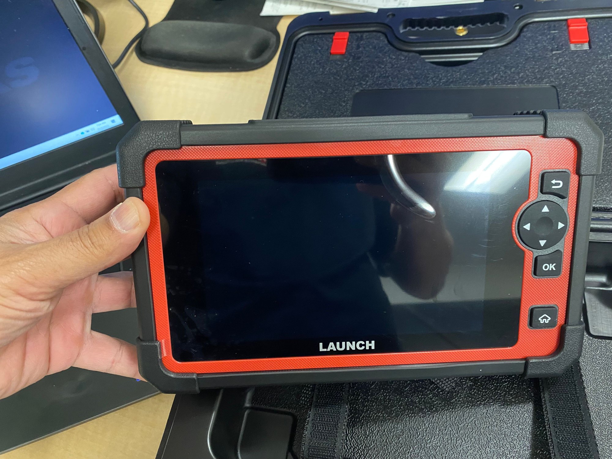

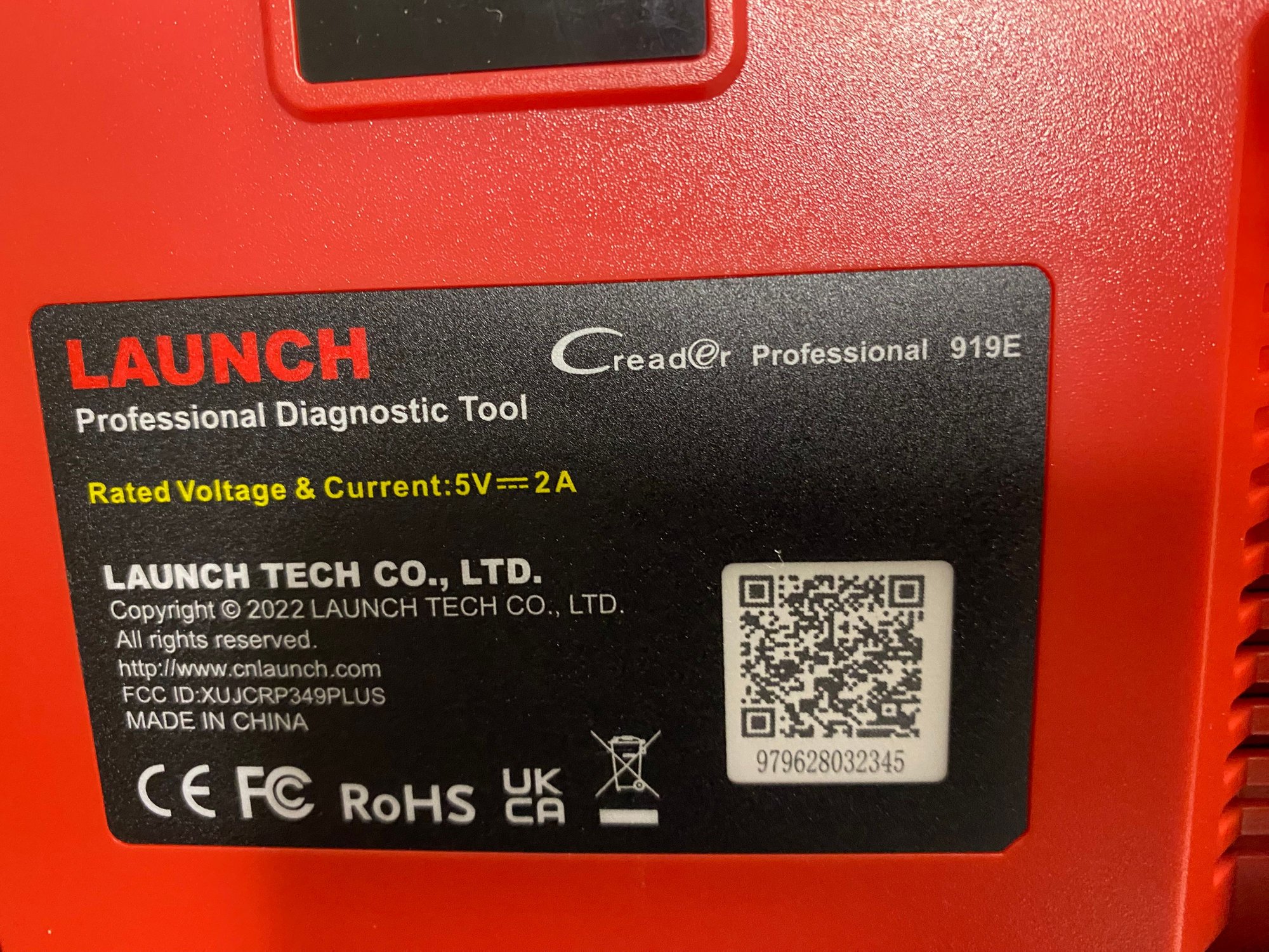

Default Launch CRP919E
This is the Launch model X431 CRP919E sold on Amazon currently for $465.00.
However, tech support from KINGBOLIN informed me that this model will only do HSF for the 2023 and 2024 C8 Corvettes.

Ended up buying DCT filter through Amazon. When it comes in I will perform HSF.
Gotta love Amazon with same day delivery.
OK guys, I got everything in hand. I already took off rear cradle shear plate just to speed things up for tomorrows video. I am going to drive car tomorrow to bring transmission up to temp (122 degrees) per PDF directions. Then I will start making video from point of plugging in Launch CRP919E scanner to OBDII port.

UNSUCCESSFUL guys. Took car out and got the trans up to 145 degrees. Plugged in OBDII as soon as I got back from drive. As I was making the video and started my car with my aftermarket exhaust is so loud you would not be able to hear me. The CRP919E didn't do ****. It had all the prompts that popped up, when conditions were met step by step, but car did not go to 2000 rpm's as stated in PDF. No change is sound or in gauges. I tried attempting HSF two times. Save your money on buying this unit until they come out with something reliable and tested.
