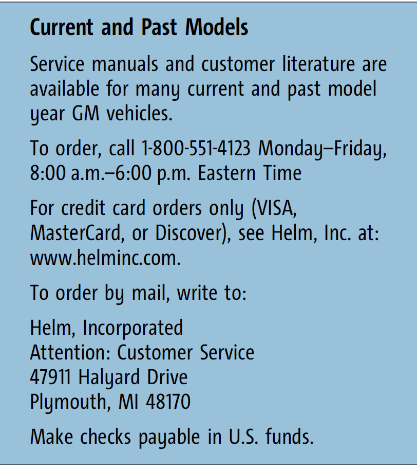

How do we go about acquiring a printed copy of the Service Manual?
Old Oct 22, 2023 | 12:53 PM
Andybump's Avatar
Andybump
Joined: Mar 2007
Posts: 11,446
Likes: 8,609
In the Owner's Manual. Helm inc. You can also access Helm inc on line. Looks like maybe Alldata provides access to it - I know nothing about it though.
Ebay has them sometimes - they are not necessarily up to date - I do not know about the validity of the pedigree for ebay versions.
Thank you. Don't have my car yet, as its on hold in BG waiting on an option apparently on constraint after GM accepted my order. Since I don't have the car, I don't have a user manual yet. This is helpful, thanks.
The Helms website is only showing User Manuals for the 2023 and 2024 Corvette.
You can go here to download the Owner's Manual right now.
https://www.chevrolet.com/support/ve...model=Corvette

Got it thanks. Any whereabouts for the legit Service Manual?

I see they have the service manual for 2021, for $349. Has anyone bought the manual from Helm? I've seen so many halfazzed manuals that I'm hesitant. "Back in the day" you knew you were getting an official factory service manual, like what the techs supposedly referred to.
Helm IS the official source for GM and many other Manuals. From their 2020 C8:
Price: $475.00 In Stock 2020 Chevrolet Corvette Service Manual Set Contains Factory Authorized Service information written by General Motors. It contains Diagnostic Information and Procedures, Schematics and Routing Diagrams, Component Locator, Repair Instructions, Description and Operation, Specifications, and Special Tools and equipment. Service information on HVAC, Body & Accessories, Restraints, Steering, Suspension, Driveline/Axle, Brakes, Engine and Transmission/Transaxle.
The PC version is $329.
I have the 4 volume C7 printed manuals. Each is 8 1/2 X 11 and ~2 inches think. However it tells a tech what to do not necessarily just what a Flush is doing. Mine has some cryptic info on for example transmission operation but not a great deal of detail. It's meant for a Chevy Tech (or DIYer) to work on an item NOT design it!
