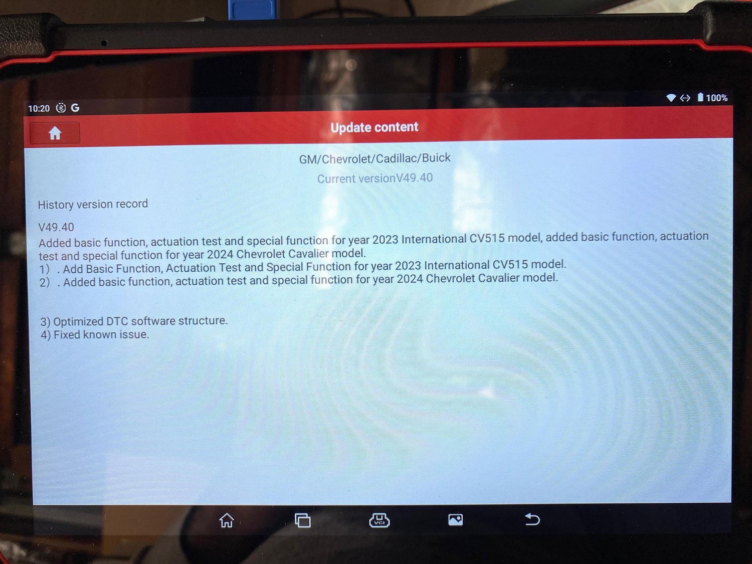

The latest Launch update has what appears to be the automated DCT hydraulic flush procedure. Several software versions prior had the flush procedure, but listed the individual steps instead.
Next filter change I am going to remove the filter on the car now, install a new one and then run this procedure with this clean filter. Afterwards, I'll remove this filter I used for the flush only and then cut it open for inspection.
This bidirectional scanner is the Launch X-431 Torque Link.
Older software version
New software update

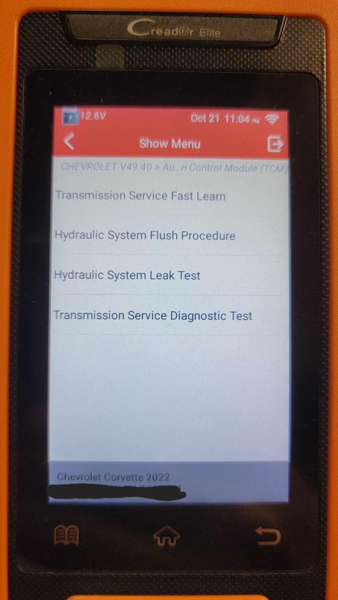

Default CREADER Elite got the update too
Old Oct 22, 2023 | 08:08 AM
Andybump's Avatar
Andybump
Joined: Mar 2007
Posts: 11,409
Likes: 8,568
Originally Posted by 22c8z51
Did the Creader also retain the 7 individual cleaning procedures ?

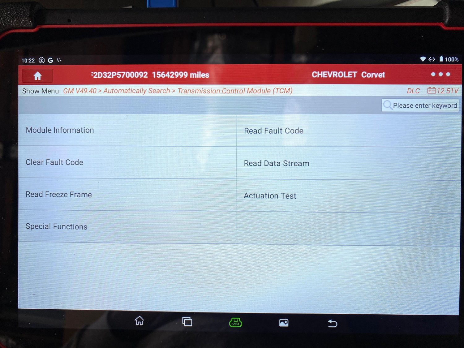

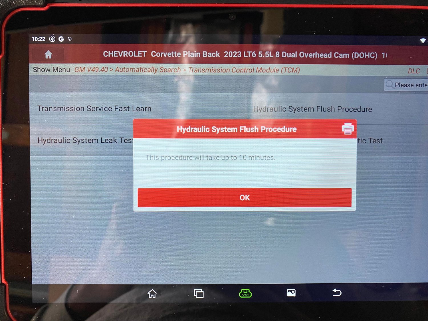

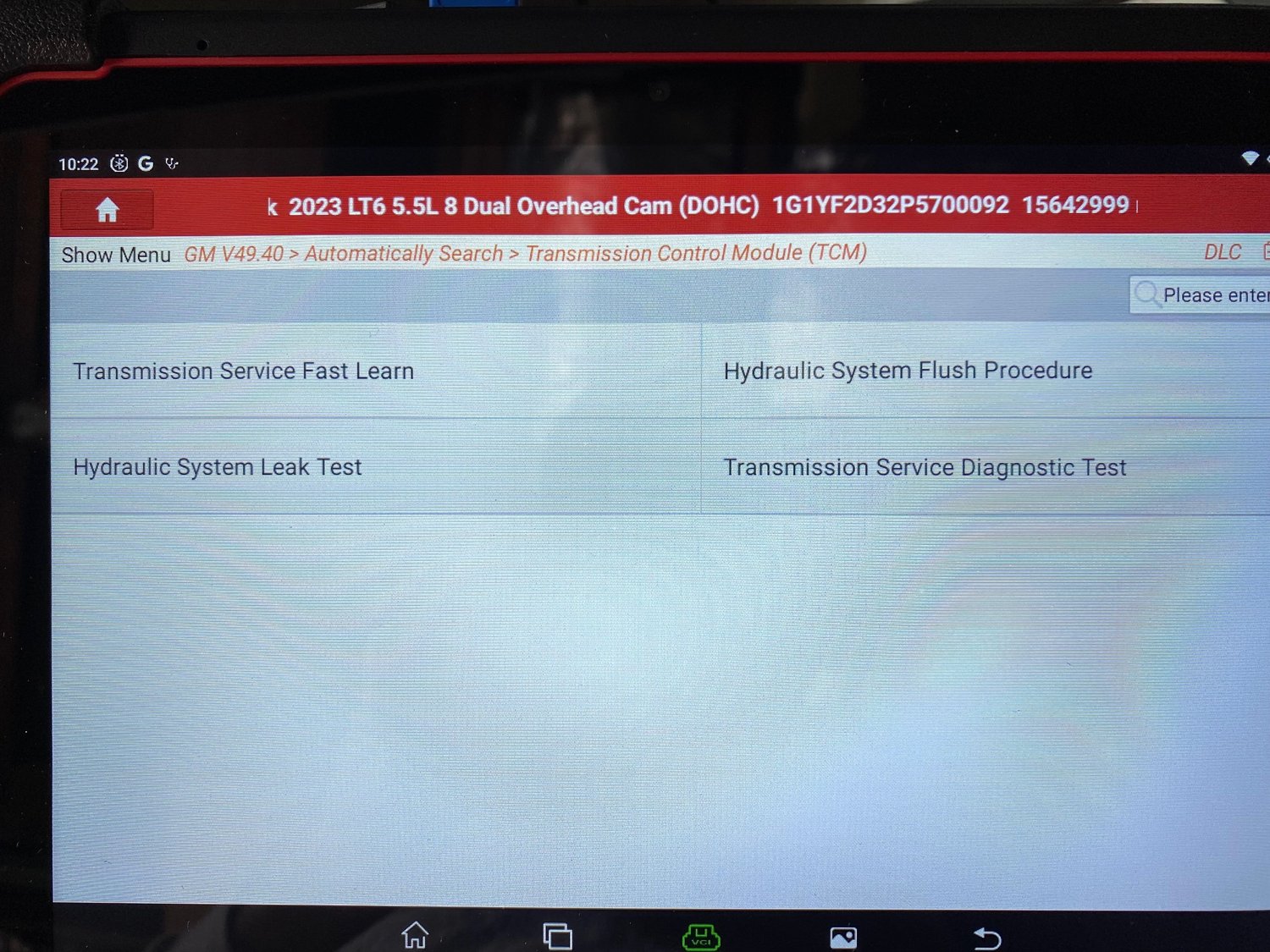

Here are a few more screen shots:
This is a description of the software update
Selecting transmission control module brings you here
Selecting special functions brings you here
Selecting hydraulic system flush procedure brings you here. Note the time to run this - which is the same time as the MDI 2 the dealer uses.
The seven individual steps by themselves are no longer listed.
These are the four transmission procedures I have been asking Launch to incorporate into their software.

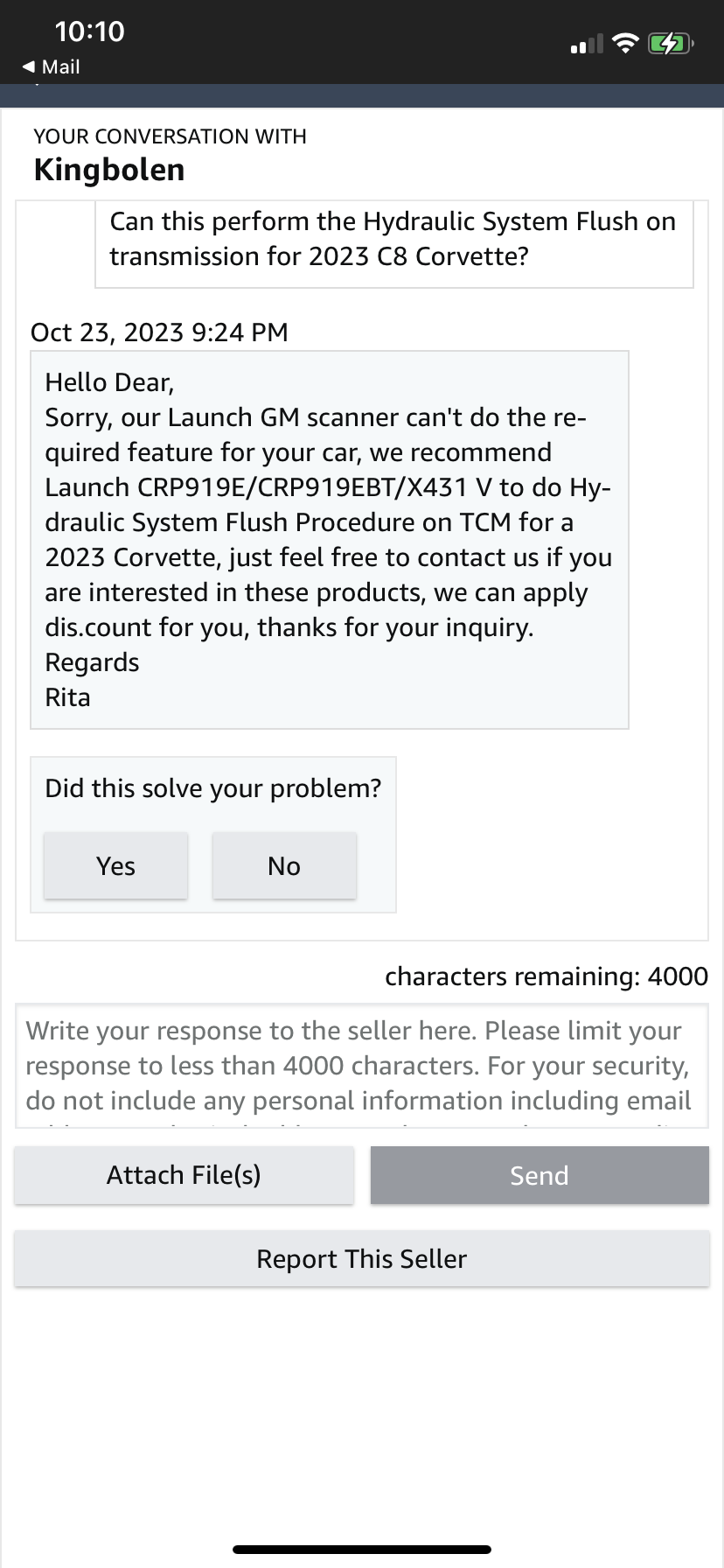

I just received reply back from Kingbolen who sells the Launch X431. She stated this model (X431) will not perform HSF on corvette. It also looks like Mitchell B uses the Launch Tech X431 Torque Link model, which is $2,000. I also thought it would be worth mentioning that Launch and Launch Tech USA are two different companies. Launch who makes the $160 X431 C reader elite that is sold on Amazon is an overseas company. Launch Tech USA makes the legit one that MItchell B is using. Now I know 22c8Z51 posted a screen shot of the Hydraulic flush on the Launch X431 small version. However, after asking "Launch" they stated the small handheld X431 will not perform HSF. Launch models CRP919E ($372.00) / CRP919EBT ($455.00) / X431V ($860.00) will be able to perform the HSF per reply in screen shot. I contacted Launch Tech earlier and they confirmed that they do not sell their scanners on Amazon or Ebay.

Originally Posted by joecbrzx
I just received reply back from Kingbolen who sells the Launch X431. She stated this model (X431) will not perform HSF on corvette. It also looks like Mitchell B uses the Launch Tech X431 Torque Link model, which is $2,000. I also thought it would be worth mentioning that Launch and Launch Tech USA are two different companies. Launch who makes the $160 X431 C reader elite that is sold on Amazon is an overseas company. Launch Tech USA makes the legit one that MItchell B is using. Now I know 22c8Z51 posted a screen shot of the Hydraulic flush on the Launch X431 small version. However, after asking "Launch" they stated the small handheld X431 will not perform HSF. Launch models CRP919E ($372.00) / CRP919EBT ($455.00) / X431V ($860.00) will be able to perform the HSF per reply in screen shot. I contacted Launch Tech earlier and they confirmed that any Launch scanners on Amazon or Ebay is NOT their products.
If it is not on listed in this line up card, then it is not a Launch Tech tool.
https://redirect.viglink.com/?format....com%2Fcatalog
