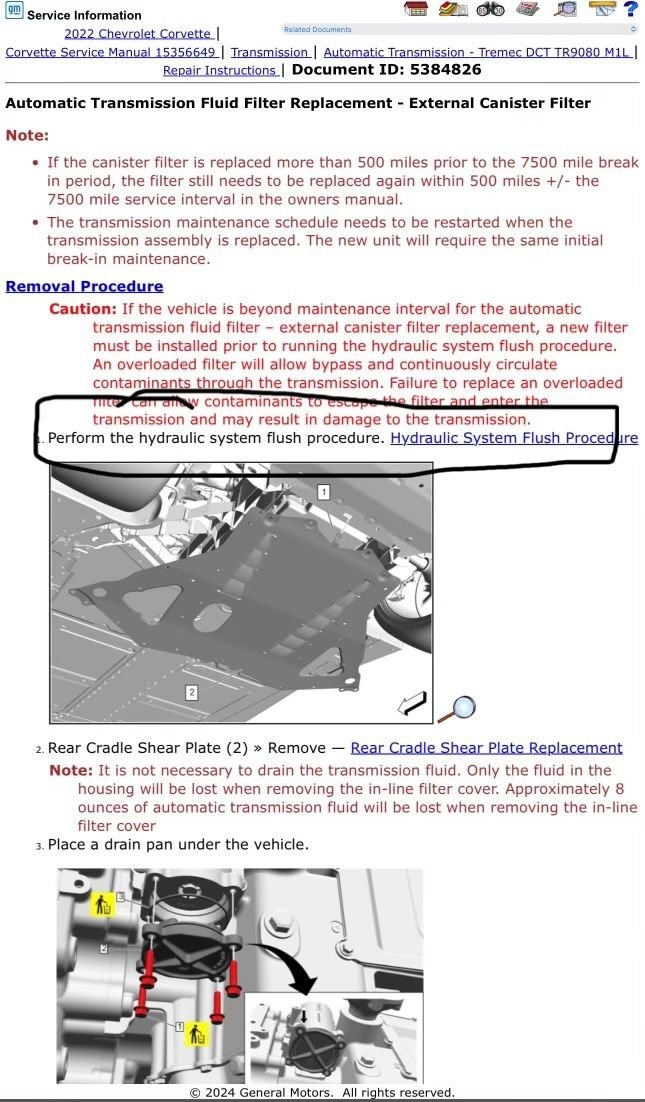

Originally Posted by tsigwing
The flush procedure is not a requirement. Don't overthink it.
It’s quite literally the first step in the service procedure. Is there a way for them to prove it wasn’t done, likely not. But I don’t know if I’d say it’s not a requirement.

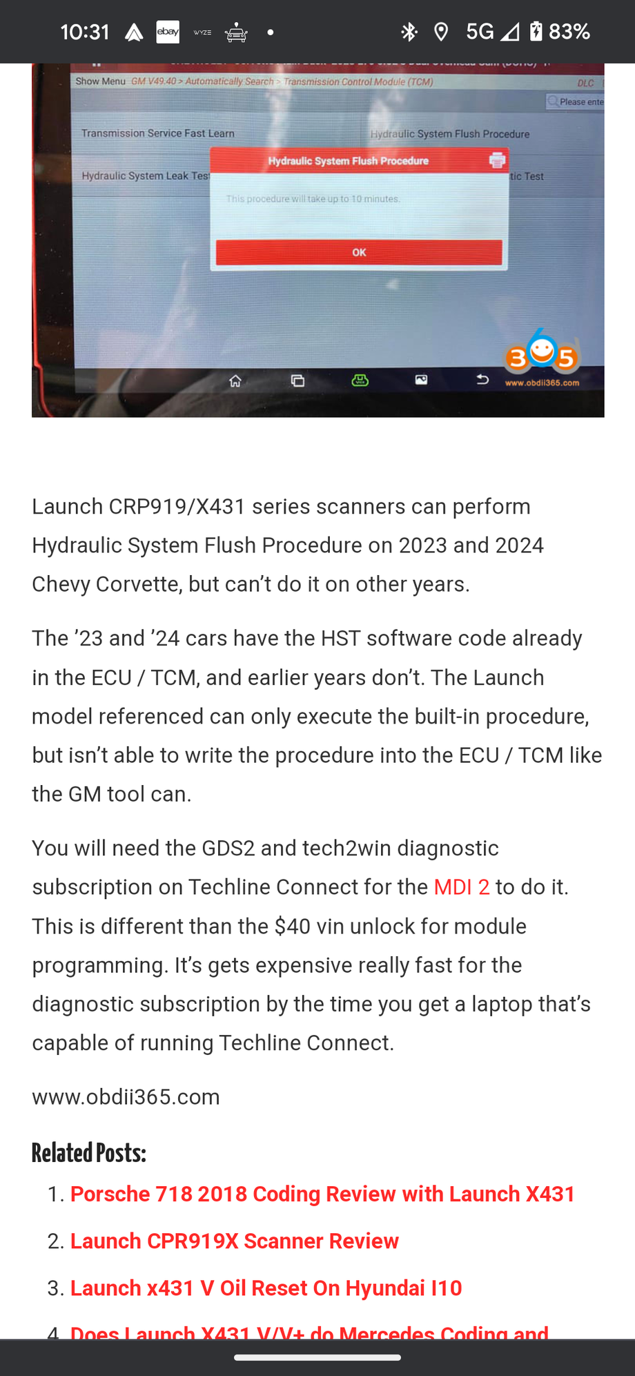

Just so I'm understanding this correctly but if you have a 23 and up vette the x431 series can do the full and partial flushes for the maintenance intervals because it's embedded on the tcm then?
Search around this site, there is a video from GM saying that for DIY, this is not necessary. GM does it because they can.

I Can confirm the NT510 works on my 2023 Z51, Just using tool, no internet, No subscription, just the tool.

Yes Wadejsu, for 23 and up the third party scanners should work. The module architecture is different than in the 22 and earlier model years. I'm looking around for a second hand Bosch mdi2 and if i can't find one I'll bite the bullet. In the long run the subscription and the tool will run less than a dealer visit.
