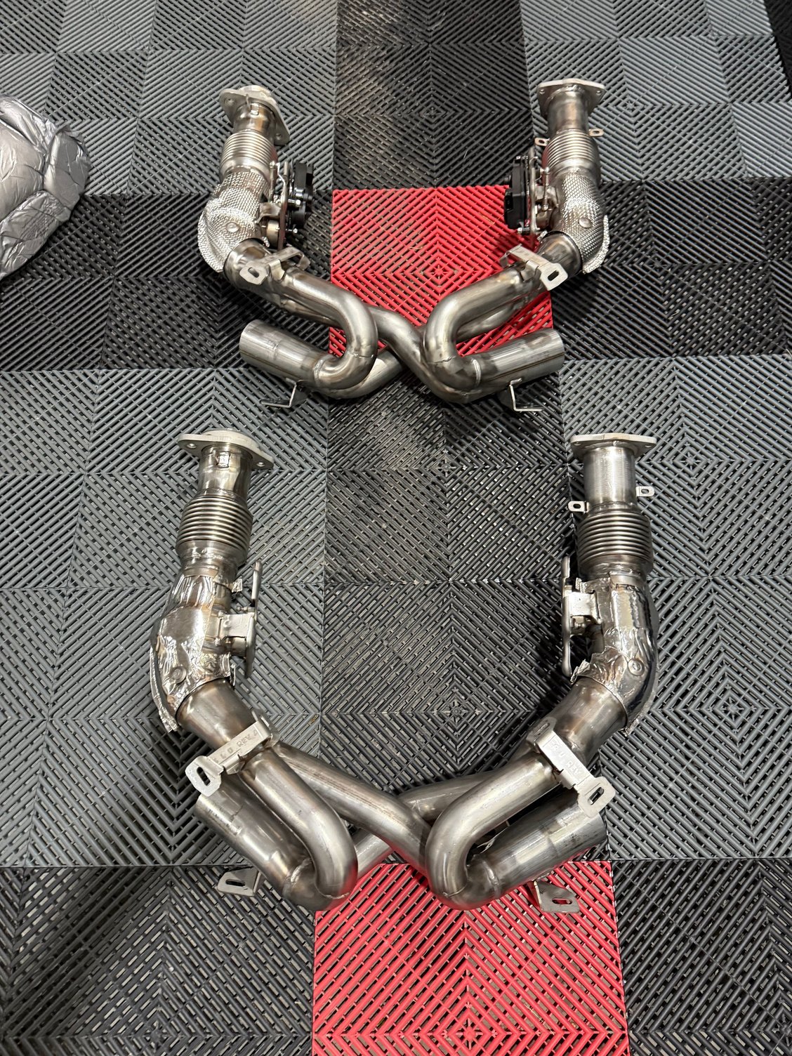

installing GM borla on my 2023 tomorrow and have a quick question. It does come with 2 front pipes section according to Borla 20-21 have AFM and 22-25 have DFM. How do I know which one is correct for my 2023.

i have gm version and it came with 2 front pipes section, they look identical but the valves support to be different, i need to know which one i need to install on my 2023
GM part number 19433781

both look identical. I think I got 2 as mistake. Different heat shield but the valves inside are same.

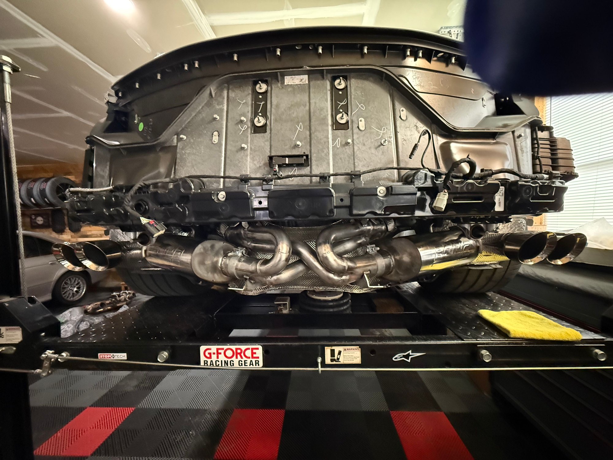

The images you posted show the AFM actuators installed on one of them. Did you do that? You did not receive it that way right?

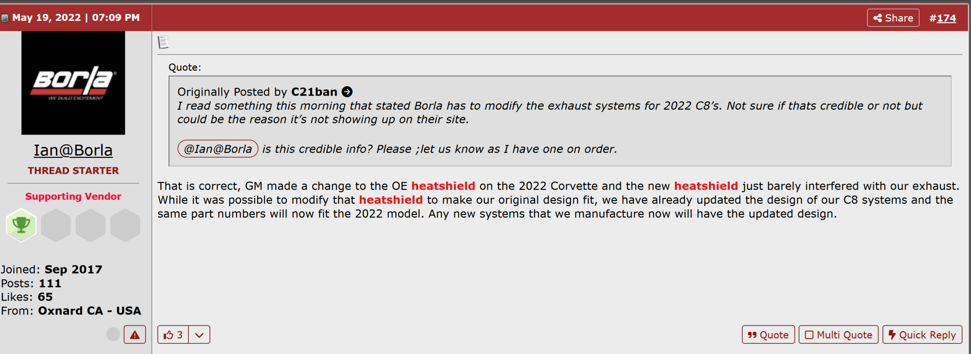

Default Found It! - Borla heat shield change
There was a heat shield issue with 2022 models that caused Borla to change the design. Turns out I had clipped that post and saved it in my files. Has nothing to do with AFM vs DFM of course. And does not explain why the OP received two versions.
excellent find. That explains some
of the differences in exhaust systems over the years.
I swapped from my other exhaust
The mounting tabs at the bottom (relative to the photo) look different. Not identical. I think only one of these is actually going to fit your car. No idea which one, though.
