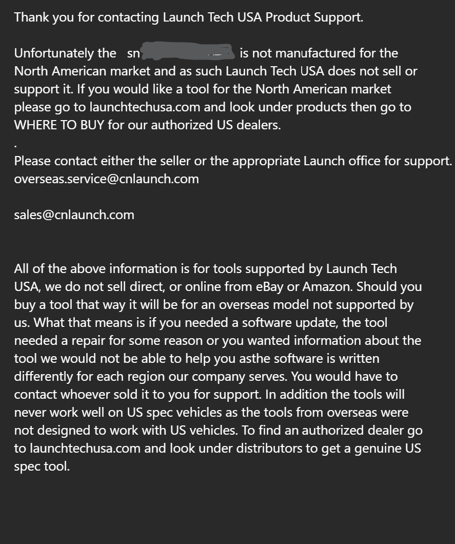

Hey yall, I have the CReader x431 Elite unit from Amazon as well. Unfortunately the GM 49.50 appears to have the ecu communication error (at least with a 2020) when it comes to doing the HSFP. Sent launchtech usa a email in regards to the issue and hopefully someone will respond.
If you haven't updated your GM or Chevrolet diagnostics pack to 49.50 and everything is still working I would say hold for now.

So i tried out some of the other special action for the TCM and they appear to run into the same error. The only one i didn't test was the TCM fast learn since it specifically advises not to touch it unless some internal work was done.
Launch USA just got back with me and buyer beware of the amazon creaders is that you'll have to go to overseas support for any issues. Then there was an ominous underlying that the functionality could possible never work due to some regional differences within the company.
Response back from Launch USA
Sent an email off to overseas service and lets see what they have to say

So I did some testing with some of the other functions for the TCM such as the diagnostic and the leak test and unfortunately they didn't appear to work either and come with either a communication error or invalid vehicle error. The only one I didn't try was the self learn since that's one you don't press unless really needed.
Buyer beware announcement for the CReaders bought off of Amazon. Launch USA told me they don't support units purchased off of Amazon as they most likely are overseas units. The launch rep also hinted that due to regional differences in code for the units that the obdii utility would most likely not be fully compatible for US vehicles. I was given an email for over seas service and will let y'all know of any progress updates.
