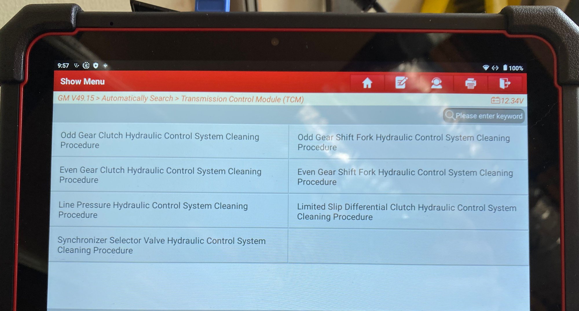

It is likely that the earlier Launch software with the seven individual cleaning steps allows you to perform the equivalent of the automated procedure on 2020 through 2022 Corvettes.

If the hydraulic system flush is running through some or all the above steps you still don't know which ones are performed, in what order they are performed, if one or more is repeated after some others are performed, etc.

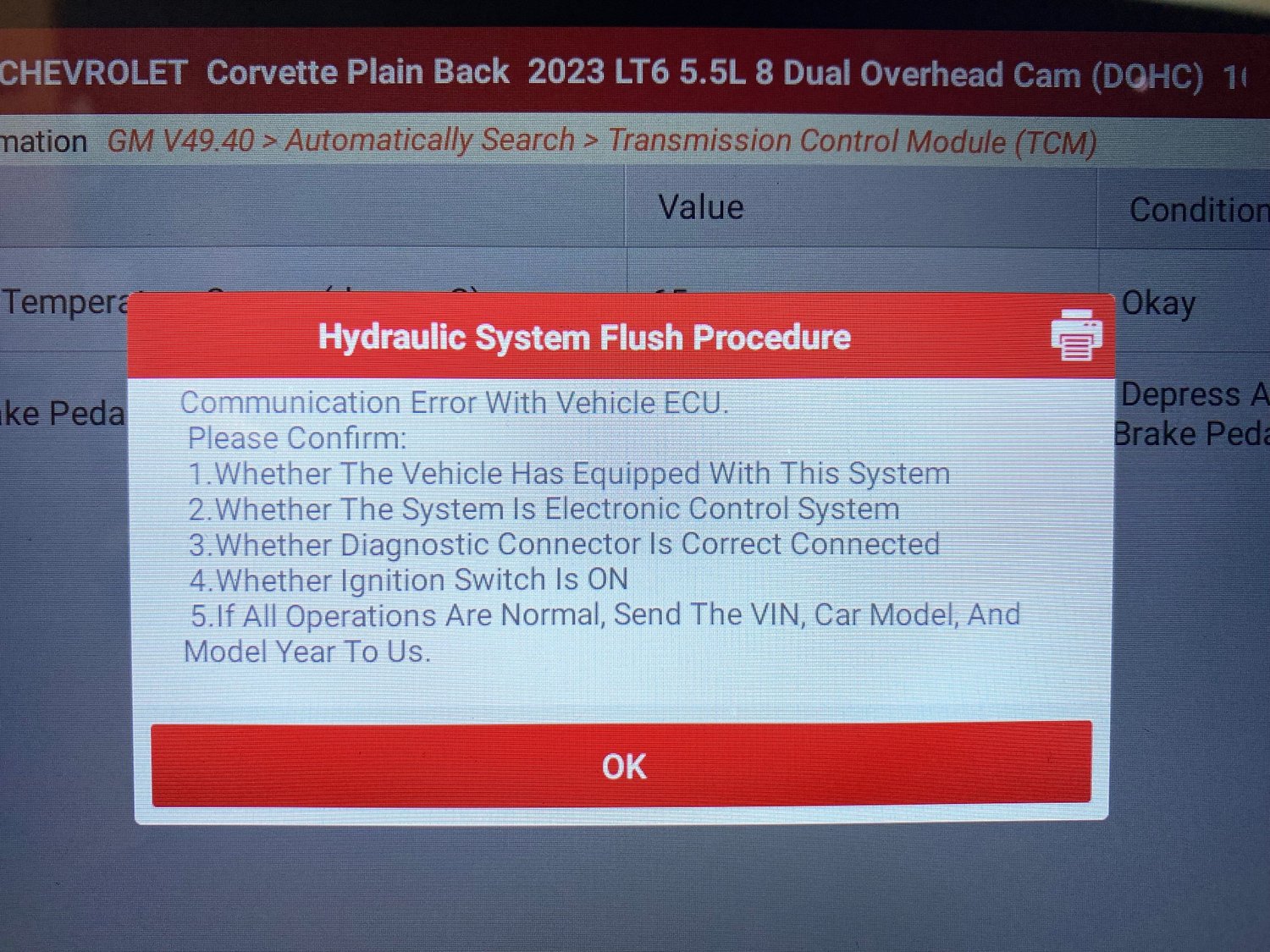

Connected to my car with the Launch and tried running the hydraulic flush procedure. This is what I got:
I am not sure what the issue is. I sent this to Launch for their review.

I interpret this as meaning that the '23 and '24 cars have the HST software code already in the ECU / TCM, and earlier years don't. The Launch model referenced can only execute the built-in procedure, but isn't able to write the procedure into the ECU / TCM like the GM tool can.
The post below would seem to support the above:

Yeah. Except that screen where the failure happens says it was a 2023 car, doesn't it?

The car is a 2023 Z06. The latest software revision 49.45 does have the hydraulic flush procedure, but again, the question is will it work without any error messages. I will try again this coming weekend.
