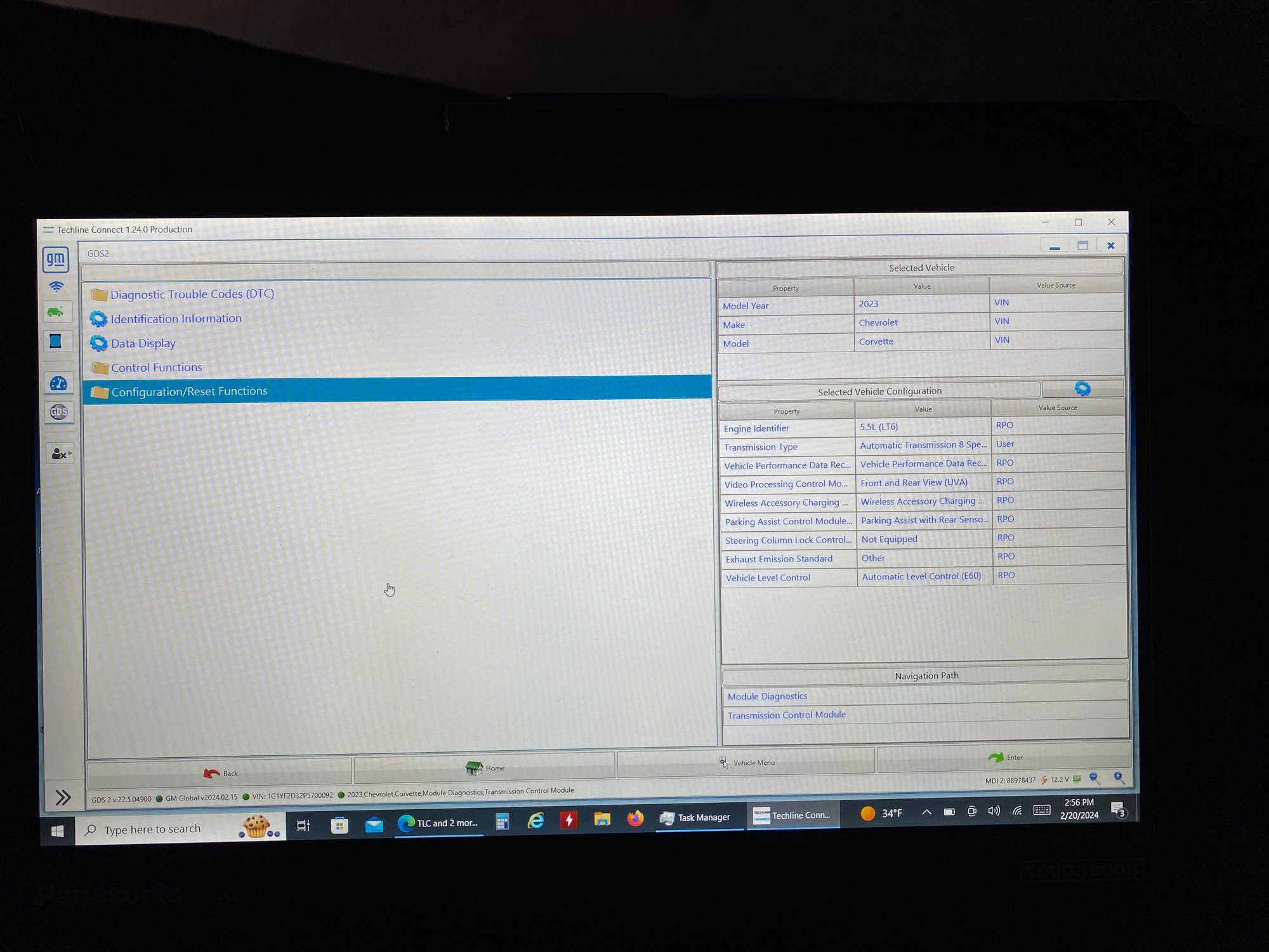

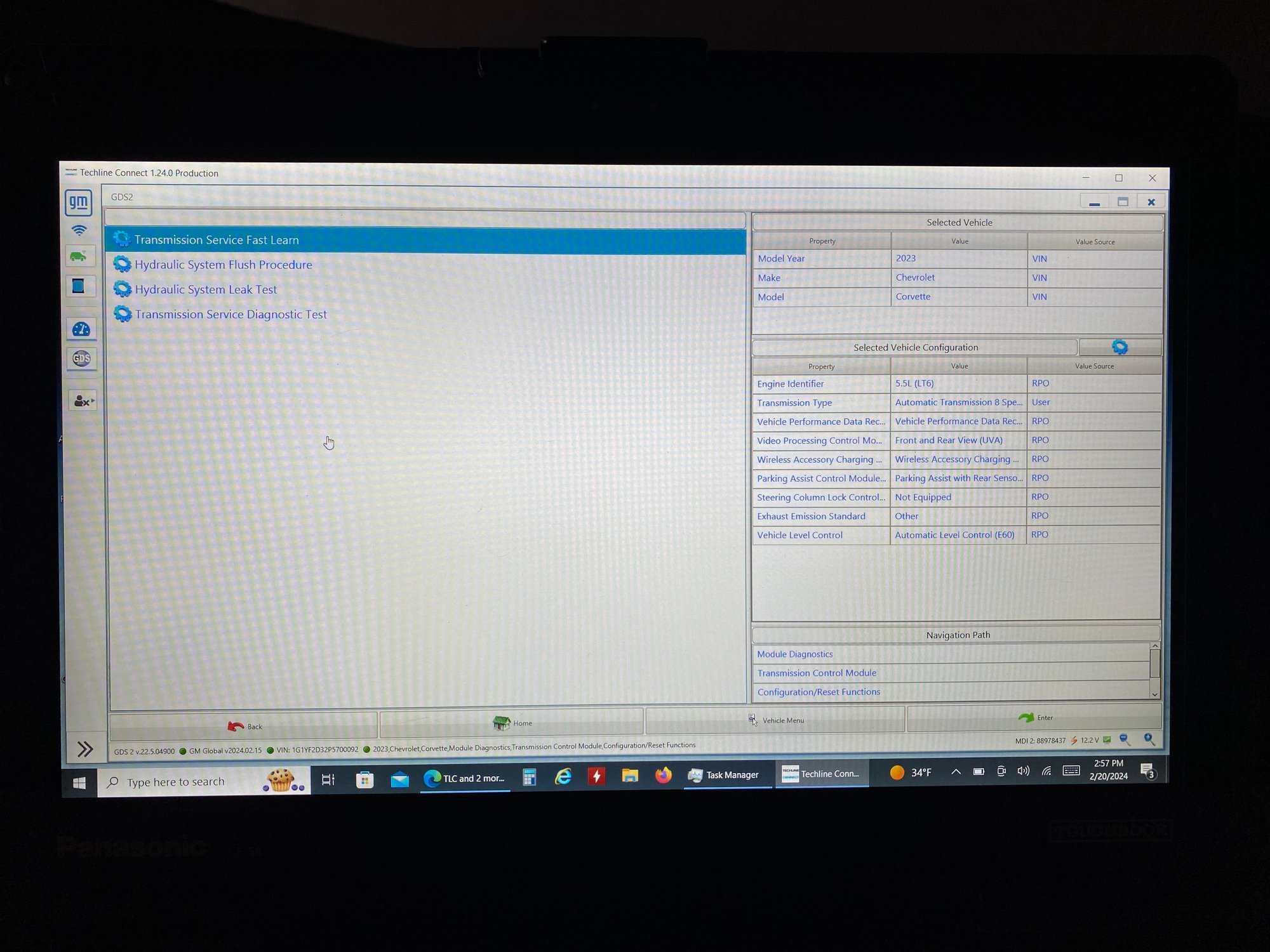

Downloaded, installed and updated the Global Diagnostics software on my laptop and installed the software on the MDI-2. Got it all up and running in about an hour and then connected to my car.
I will not have my car running until I am ready to take it out of hibernation, so I was not able to run the procedures.
Aside from the HSF, there a lot of diagnostic info you can get with the MDI-2 including datalogging and many reset and relearn procedures.
Another thing - ordered online through GM Tools, I was billed $1147.84. However, my account was, in reality, charged $883.62.
$69.68 total buys 72 hours of access to the software.
Inside the transmission control module
Under configuration/reset functions
Hydraulic system flush procedure. All 3 conditions' status red because the car is not running
