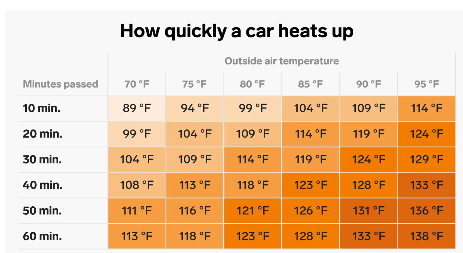

So, if you drive your car for three hours on a 95 degree day with the cabin closed and AC on, then park it in the sun and shut if off, the interior temperature will rise from a comfortable 70 degrees to 114 degrees in 10 minutes and continue to get much, much hotter. And its probably even hotter on the surface of the dash leather if a windshield cover was not used. But underneath of the leather ( what folks are calling a substrate) that part is not nearly has hot. So even if the layers did change at the same rate with temperature, the temperatures are significantly different. It gets perceived as a heat problem because hot days are the ones that will cause this rapid temperature increase.

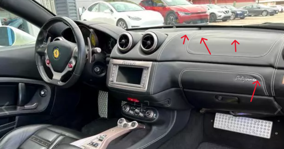

Frankly, I've had cars with, without leather dashes. Leather (animal dead skin) is not something that moves me like it does some people. All the Vettes I've had were without. The playcar I drive now simply doesn't come with anything but leather dash, so did my Bentley CGT, my AMG GTS, etc.
It is interesting to me that with all the dash leather separating there is no match on door cards with leather, consoles, seats (maybe bad example) even steering wheels (mostly), only the dash leather that, coincidentally, has the most environmental exposure in the car.
Just a few other examples - Bentley, Aston, Bentley again, Ferrari, Jaguar:
