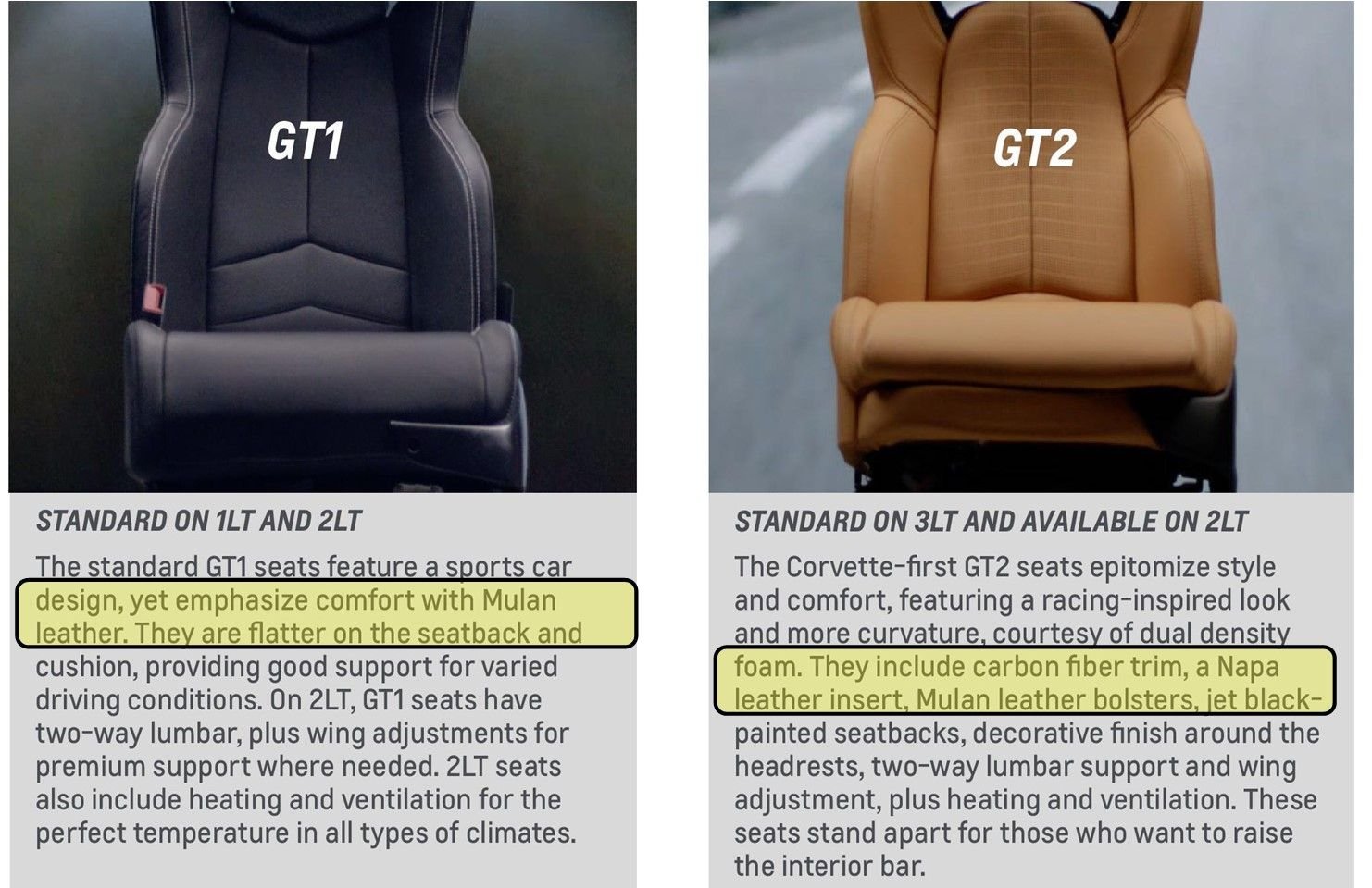

First the Corvette C7 or C8 dash 1LT, 2LT or 3LT is not a tanned animal skin. The ONLY real leather on a C8 is the GT-2 seat (perhaps the 3LT Drive Mode Wrist Rest!) The other material is either GM's coined name Mulan, which like Chrysler's "Corinthian Leather" was a name created by their ad agency for faux leather.
For the C7 it was accepted by most the 3LT Dash was Mulan and had some issues. The 1LT and 2LT dash also looked like leather as well, as the embossing rolls made it look like "leather." It was leaked that it was bonded leather which was for the C7 Vinyl with 10 to 20% finely ground real leather mixed with the vinyl reason as a filler.
The C7 interior designer talked about the "soft touch" interior materials being real Napa Leather, Mulan or Vinyl. So by deduction since the 1 and 2LT dash had no reported issues (or every view) it was assumed it was Vinyl. If you check the furniture Industry, Bonded Leather is commonly used and each manufacture has their ouwn name. It is wanded not to place Bonded Leather chairs in direct run or near floow heat registers. In fact Vinyl proaply streahces no shriks with heat.
For the C8 it's possible the #LT dash in Mulan (whatever faux leather it is) an the 1LT and 2LT Vinyl. It's GM's coind name and can be whatever!
The C8 is the 1st time where they defined the bolsters even on the GT2 seats are NOT Napa tanned animal hideNapa leather reather then are Mulan. Don't say what the bolsters' are on the GT1 seat only the seating serfice is Mulan but Mulan.

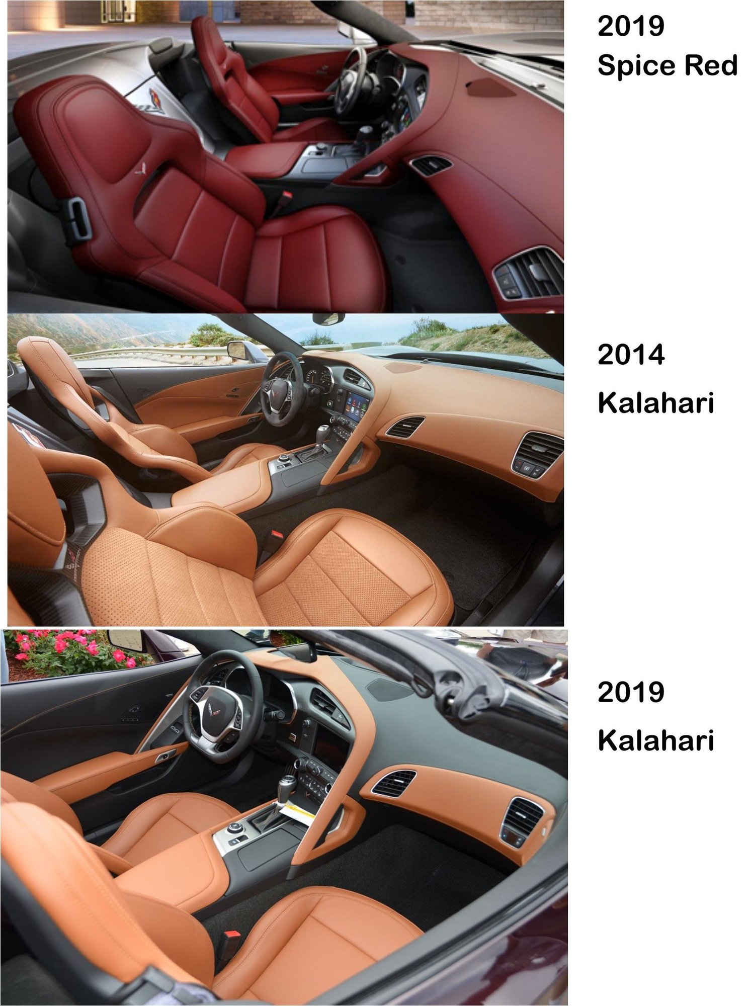

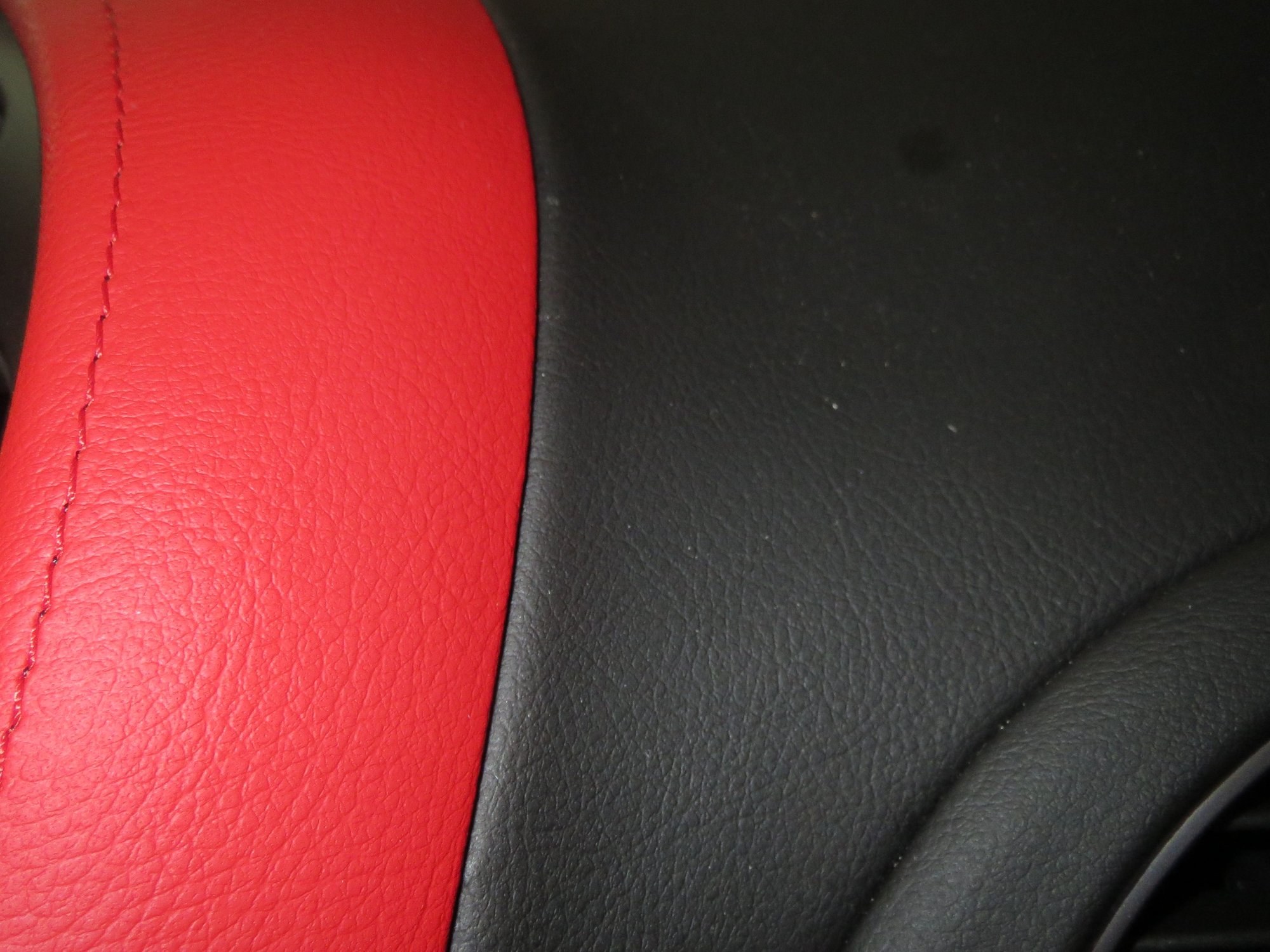

It smells better than Vinyl and may feel somewhat better. But I agree if the 1LT and 2LT don't have an issue why would they not use it beit Vinyl or Polyurethane fabric also like GMs coined name Mulan and Chryslers Corinthian faux leather. All refereed to as "leather" even thought it's faux leather.
BTW, the "Ultraleather" I selected for my street rod is a very high end, Polyurethane faux leather. In my case quoted the same price as real leather but it's as soft as the best Moroccan woman's glove leather. The compony prides themselves as no dead animals used to produce.
Had 3LT, C6 and 3LT 2014 C7 but GM got cheap in 2016 and made the 3LT look like a patchwork quilt, IMO. So bought a 2LT but did like the seat colored upper dash pad above the steering wheel. I was on the 3LT. So bought and installed. i could not tell the difference my Vinyl dash. Felt soft, no doubt due to the backing on the Vinyl.
So I don't know why GM does not used the same material for the dash in all 3!

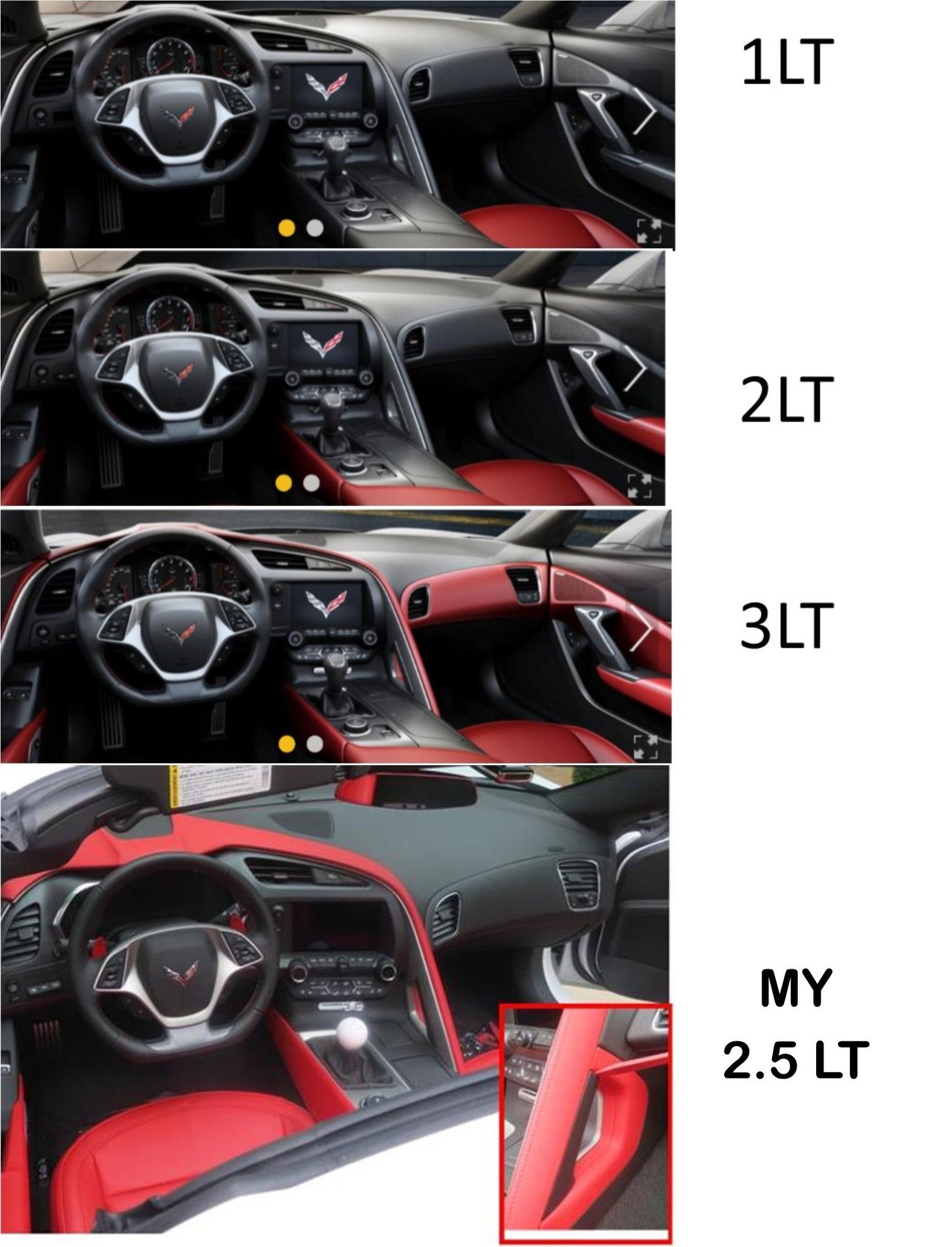

ALL 3 interiors below are 3LT. GM got cheap in 2016 so I bought a 2LT 2017 Grand Sport. Unlike my 2014 3LT had to get a special model after 2016 that came with Spice Red to get what I had in 2014.
I decided to add the Upper Dash Pad to match the seats in my 2LT Grand Sport. So bought a 3LT Red Upper Dash Pad
The Faux leather 3LT Red Upper Dash Pad and 2LT Black Dash looked the same. Can be made to look however specified with proper embossing rolls in manufacture.

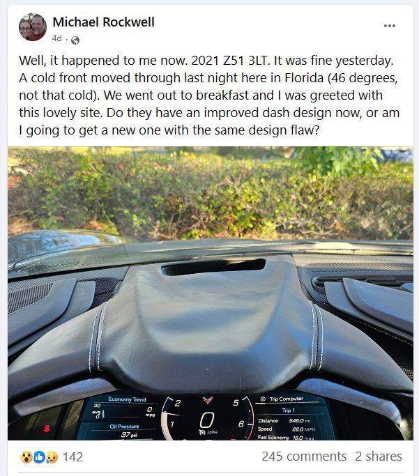

Originally Posted by tadda
Shame. Looks like the glue could not deal with the cold. Different than the C7 that was mostly shrinkage. The C8 appears to be that type failure. That part is a separate piece so expect they will replace,
Jerry, temperature (cold or heat) didn't cause this problem. Adhesive failure isn't caused by temperature cycles. The material is not the problem (yes, I know you are saying that, but this is the erroneous conclusion a lot of people come to). The adhesive is what failed, as you point out.
Either the adhesive or the adhesive application process itself...Per GM these pieces are to be replaced not repaired...

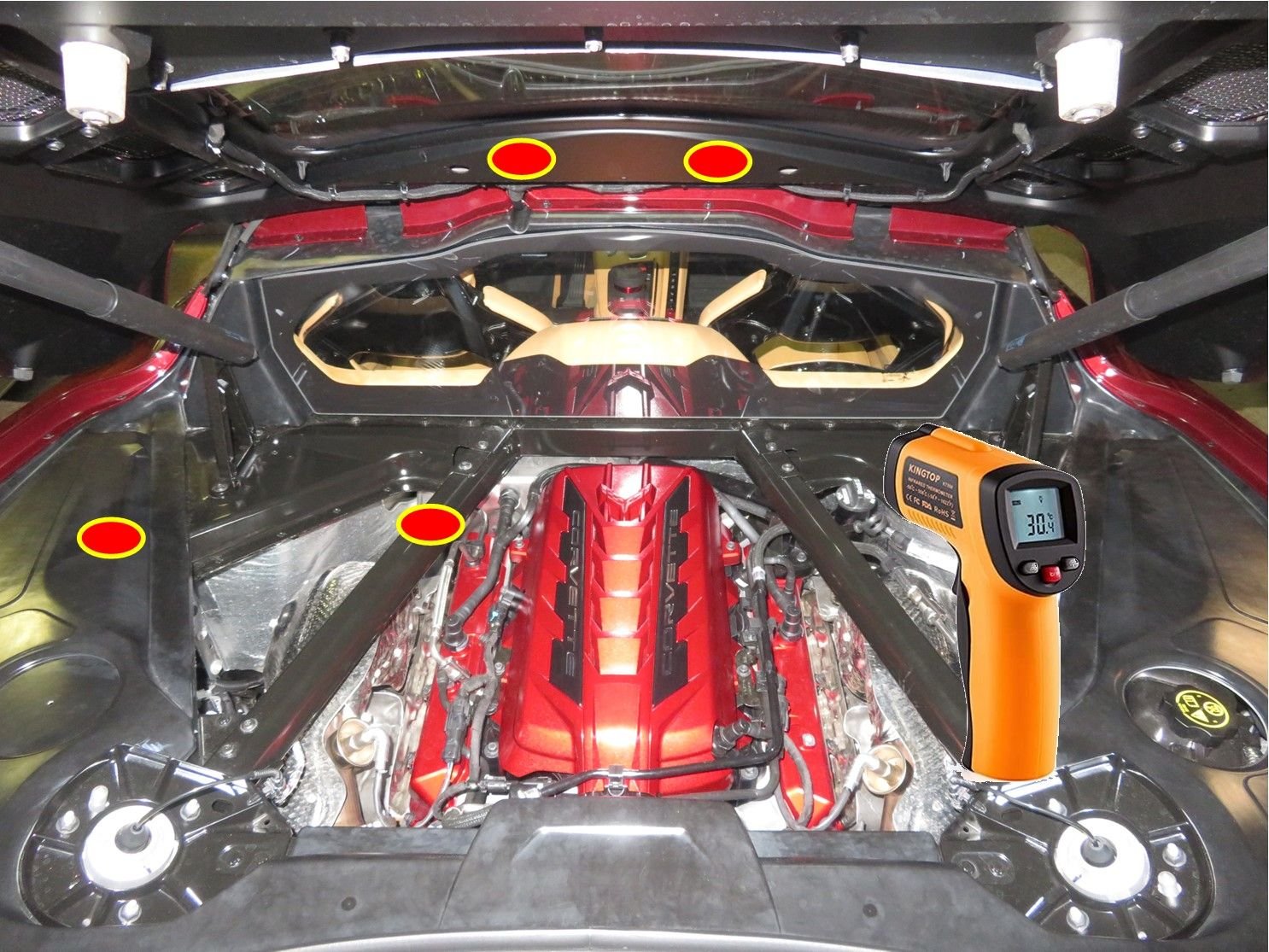

Hmm, adhesives are all different and have various temp ranges. Looked into that when I added lights in my C8 engine compartment.. Checked temps in my engine compartment. The 3M Dual Lock I used is good to 220F.
Some don't do well in cooler temps, quoting:
"Most water-based glues like cross-linking PVAs have a minimum-use temperature (some as high as 60°F)"
Have no idea if it was temp, bad application or like the "Loctite" type product GM used on the side drain plug on my 2017 Grand Sport that required a pipe wrench with pipe extension to remove. Whatever cheap overseas source they used sent some bad product.

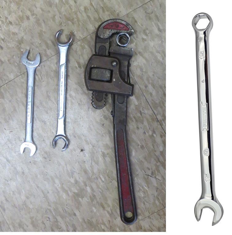

Prepared to change the oil at 500 miles on my 2017 Grand Sport. Thought will bring the same 6 sided socket and 1/2 inch drive breaker bar, just in case. The oil cooler is longer in the Grand Sport and very close to the side drain plug. Can't fit a socket and wrench. Tried wrenches in a 12 point box wrench. It was rounding the sides of the soft steel hex! Had the proper metric flare wrench. Still rounding the hex! Fit the 6 point socket on the hex and used a pipe wrench to grip the sides. Worked! Recommend folks but an somewhat unusual 6 sided box wrench. Snap-On sells for ~$40. I found on net cheaper! Drain plug had a brown residue on the treads. Perhaps a cheap "Loctite type" material gone bad or a bad batch bought from the low cost overseas supplier! Crap Happens!

@JerryU
I spoke specifically about a leather dash that "bubbles" up or detaches from the dashboard surface, as typically depicted when users complain about (or worry about) the 3LT.
An adhesive failure doesn't require heat or cold to cause a failure. If the adhesive is adequate and doing its job, it won't cause the material to separate and bubble or detach from the dash. I will not argue this point since it has often been discussed here. In this thread alone, an example of an adhesive failure in 42-degree weather was posted. 3LT dashes have experienced adhesive failure in dealership showroom floors and people's garages. This is ample proof that temperature cycling has little to do with adhesive failure.
