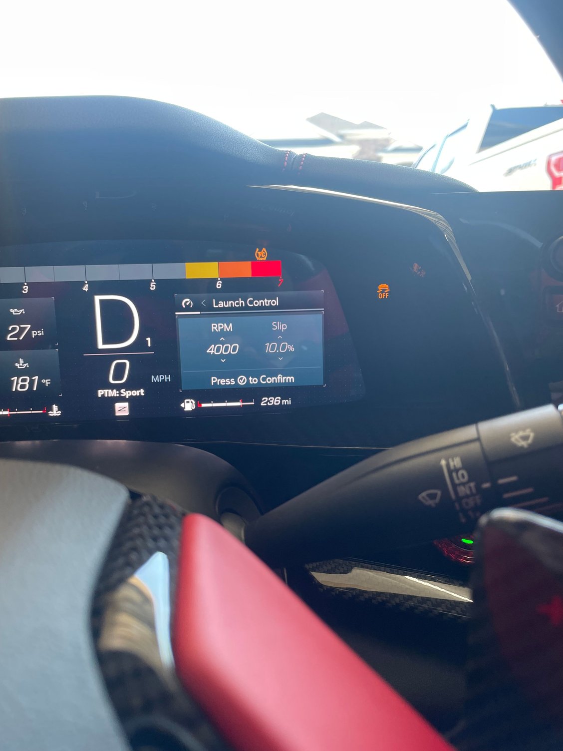

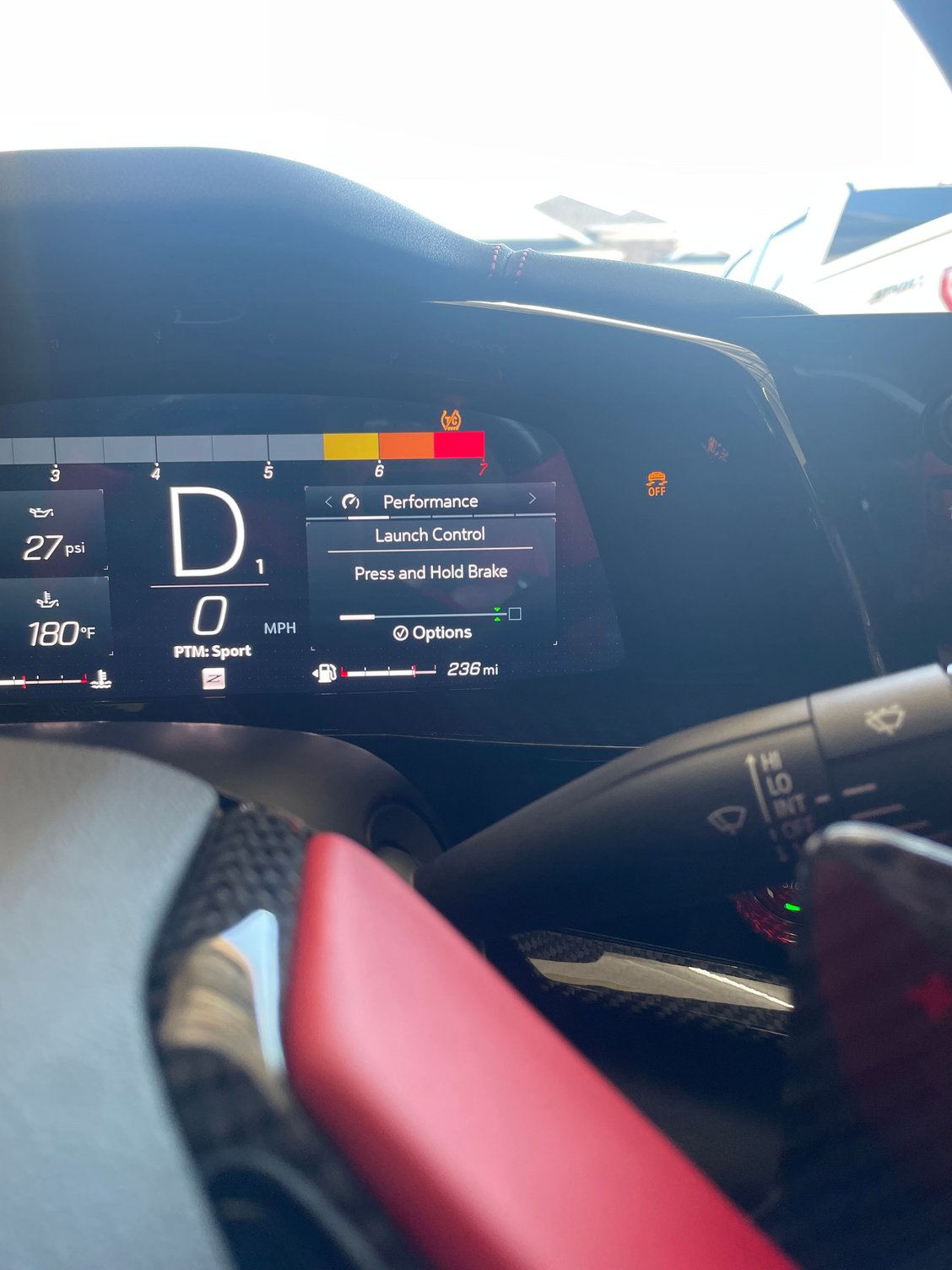

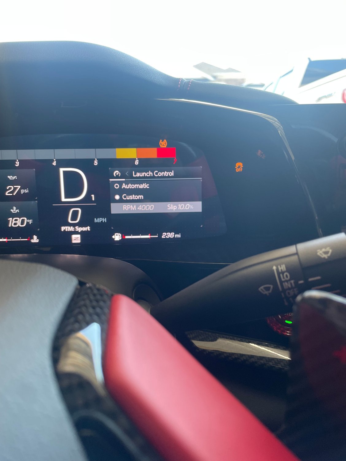

This is my second C8. First one was a 2021.
Did a search on the forum and could not find a previous discussion on the 2024 Launch Control.
Launch control setup is different on the 2024.
Reading through the Owner's Manual it mentions a custom setup and I thought it was referring to the Z06.
Playing with mine the other day and it also has a custom setup. Slightly different from the Z06, which can be set up to a max of 5000 rpm. The stingray goes from 3000 to 4000 rpm in 250 rpm increments and 5% to 15% slippage. I forgot what the increments were on the slippage.
Anyone else noticed or tried this, or is there a discussion I missed?
Did three launches:
3500 @ 10% = 2.9 sec
3500 @ 5% = 2.8 sec
4000 @ 5% = 2.7 sec
Didn't take any pics of the results.

The "Custom Launch Control" feature is on page 217-218 of the 2023 owners manual, but the qualifier is "If Equipped". I believe but not 100% sure that feature was limited to the Z06 in 2023. I need to check.

That's only with a Z51 package with ELS differential...

I do have launch control, but after playing around in all my settings for the past 10 mins, I don’t seem to have the same options as the OP’s Z51…maybe I just saw it when I was reading the manual…I remember seeing it somewhere for my ‘24, so it must’ve been when I was reading the manual…

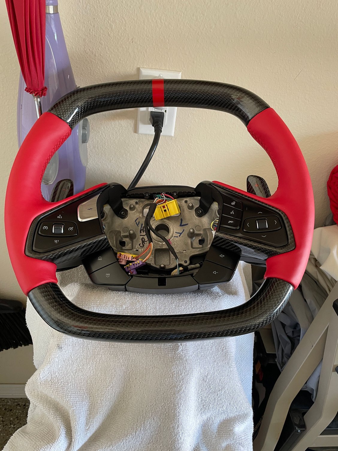

Not related to the launch control, but your steering wheel caught my attention. What steering wheel do you have?

APSIS

Because the ELS can...
