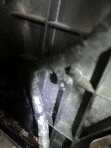

ok, need some help!!!!!! There are two wire harness clips on the back of the air filter box. How do you disconnect them from the box. Sorry for the quality of the pic! I am talking about the round clip that is in the center of the pic. I have everything else disconnected but these two dam wire harness clips. Thanks

You're going from the wrong way... MUCH easier to remove the intake manifold and throttle body as a single unit, vs. trying to go in through the back and removing the airbox (unless you're also taking the opportunity to install an aftermarket intake system).
Regardless, for that clip, you need a pry tool to get under/around it and pop it out of the hole. Plastic ones typically flex too much for that harness so metal is preferable (although I was able to get it out with my plastic one).

The instructions are limited to removing and installing the TB and not all the stuff that is around it. I spend the better part of 2 hours just removing the bolts, electrical connectors, and wiring harnesses. Two of the bolts for the air box on the engine side are nearly impossible to get to and a pain in the axx to remove. There are 6 plastic wiring harnesses that secure the wiring to the air box. 4 on the bottom, front and back and 2 midway up the back of the box "that I haven't removed yet" The 4 on the bottom, I just cut off, because they are impossible to pull out with a trim tool. I will replace them with zip ties, when I put box back together. Once I get those final two harnesses off, the air box will be free "fingers crossed" I am hoping the removal of the TB and install the Soler, will go faster, because it is only 4 bolts. But I am not holding my breath! If I would have known the air box was a complete pain to remove, I probably would not have done the upgrade. The parts inside the trunk are easy and took about 15 minutes to remove with 15 mm Torx bit and a 10 mm rachet wrench. I am actually considering creating a "how to" document, so others know what the hexx they are getting into.

The entire job start to finish can easily be done in under 2 hours with far less effort if you do it from the top rather than the rear. I've done my C8, along with two other local C8s. The only reason to go about it your way is if you're also installing an aftermarket intake system and/or sport cats at the same time.
