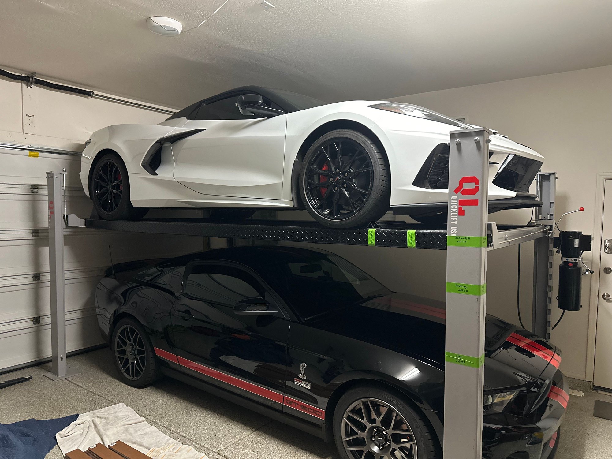

Originally Posted by Red24Vette
Why do you think your quick jack is too dangerous in your garage? I would rather mine be on concrete as opposed to blacktop. Here's mine when I did my 1st oil change and rotated my tires.
this was the best investment I’ve made so far. I use to have a midrise lift which was nice, but nothing beats a 4 post.
