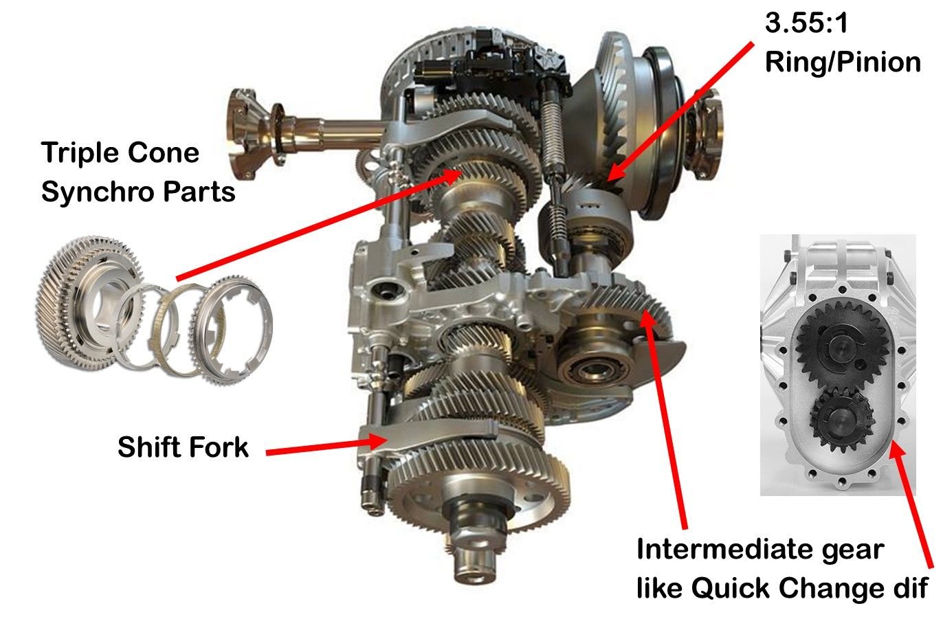

Yep but that was because of straight cut spur gears! No such gears in the DCT. They are all helical cut gears that are quiet. There is nothing in the Transaxle that should click. There are Synchro's for all 8 gears. They could make a clicking sound as the shift forks are moved with hydraulic actuators. I recall the pretty loud "clicks" in my Tremec 7 steed standard trans in my C7 Grand Sport as they clicked into place.
BUT I don't hear them in my E-Ray. Part of the reason is the steps GM used to make the engine noise that is within a foot of your ear insulated from the cabin. They selected the glass partition thickness 3 times that of the windshield. Tadge had said they learned that when stripping a Ferrari mid-engine car. As he noted Ferrari does not use anything that ads weight unless needed!
Nothing in the DCT that should make externally heard "clicks."
