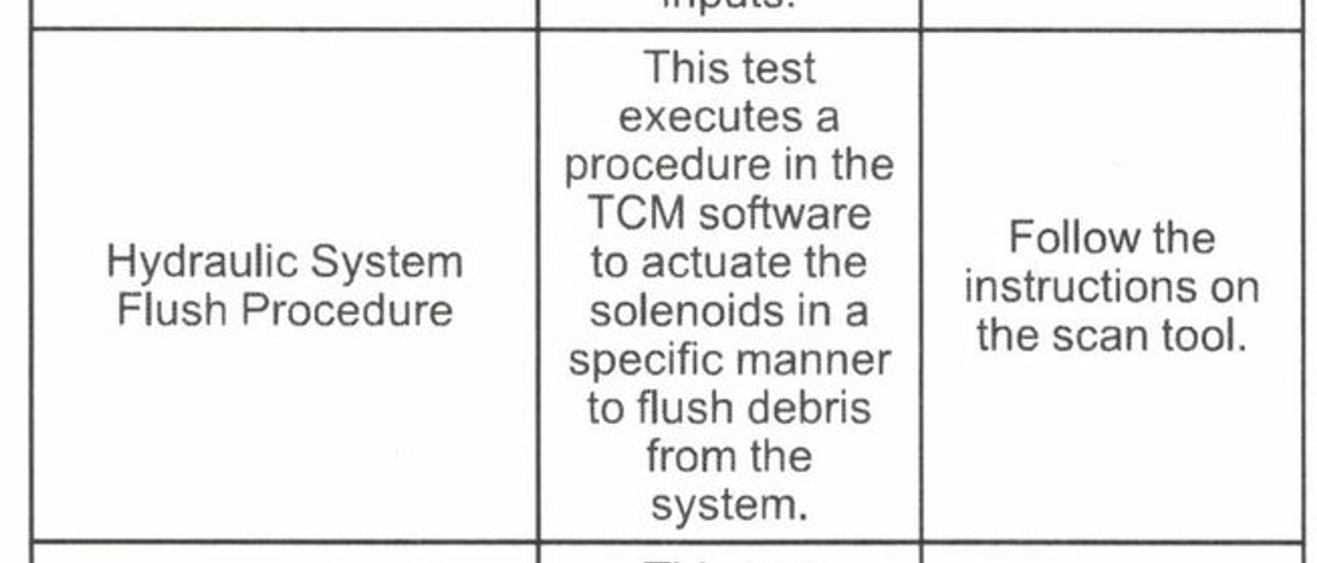

The Hydraulic System Flush is procedure that was added to the Service Manual procedures sometime after the 2020 model year was introduced. It appeared in service bulletins as a procedure that attempted to remedy certain transmission related problems indicate by certain diagnostic trouble codes (DTCs). It was added to the manual as a service procedure, and it was also added as step 1 to the procedure for changing the DTC external canister filter - in addition to being called for in various diagnostic and repair procedures. In a 2021 Service Manual, dated 2023, it is described this way: " This test executes a procedure in the TCM software to actuate the solenoids in a specific manner to flush debris from the system." My sense tell me that something described like that, and called for by multiple service procedures, must not be doing the same thing as simply driving down the highway.
While Josh did say (in that 2024 Bash response) the Hydraulic System Flush procedure "forces transmission fluid through the fine filter", he did not mention that it "executes a procedure in the TCM software to actuate the solenoids in a specific manner to flush debris from the system", although that description appears in the service procedures. And he did not say the HSF executes while driving down the highway. What he said was "when you’re driving steady state like say down the highway, we run a routine in the transmission that will force more of that fluid through the fine filter. " He did not say that the "routine" is the same as the Hydraulic System Flush procedure. He did say that if you are DIYing the DCT filter change, you don't have to run the Hydraulic System Flush - not disputing that.
Here is Josh's complete response during the 2024 Bash:
""The hydraulic system flush does kind’a the way its described. It forces transmission fluid through the fine filter that you replace. So, at a dealership they can hook up the dealer service tool to the and run a routine that will tell the trans control module to do this fluid filter flush. And because the car is already hoisted on the rack, the technician’s already got the panels off, there’s some other work he’s doing, this kinda happens in parallel in the background. So we’re doing it at a dealer visit because we can. And we can take the last bit whatever contamination might be in the oil and get it into the filter before the technician replaces it. Do it yourselfers have become nervous that hey now I can’t do it myself, I don’t have a service tool, I can’t force this routine. You don’t have to do the routine. Like I said we do it because we can, but the fine filtering routine happens during normal driving anyway. In fact, when you’re driving steady state like say down the highway, we run a routine in the transmission that will force more of that fluid through the fine filter. So normal driving is doing this. If you are a do-it-yourselfer, you don’t want anyone else touching your car, you can change the trans filter without running this routine."
