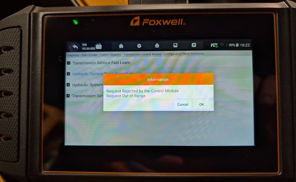

Well, I'm back and posting about the NT710 (again).
I drove my 2021 C8 to work today and in the parking lot tried to conduct the two transmission tests.
tl;dr - The system flush procedure returned an error, but did appear to actually be running & the leak test provides only an error.
Long version below:
First... I own a device which has worked just fine for my C8 and I've tested the NT710 before with neither of these functions working.
Upon trying to start the hydraulic fluid flush, the device returned this error. Yes... all criteria were met (temp, in Neutral, and brake fully applied)
After selecting the "OK" button on the screen, the test *DID* seem to actually start.
I did not let the test complete as I've just recently replaced the fluid and it's not needed to be done. I simply selected "Cancel" and about 30s latter the test ended. I have little reason to believe the test would not complete though.
I then tried to conduct the leak test, but was presented with a similar error screen.
If you look at the picture it appears I did something wrong... BUT I DID NOT. The previous test (hydraulic system flush procedure) is still selected, but the error box comes up when I selected the option below (#3 hydraulic system leak detection). Every time I selected option #3 this error box would appear, and option 3 never turned blue. It's as if the option itself is not able to be selected.
Hitting OK does not proceed to start the test, it simply returned me back to the menu.
Here's the software information from the device:
My take is the NT710 still does not operate as Foxwell states it does. There are other similarly priced options out there that do perform all of the functions (clones of the BOSCH hardware), but it's a user decision as to what is important to them.
Long version below:
Was this done with the car running or off? I'm wondering if it may need to be running?
Yes, the vehicle was running that's why you can see the RPM's at 2,000
