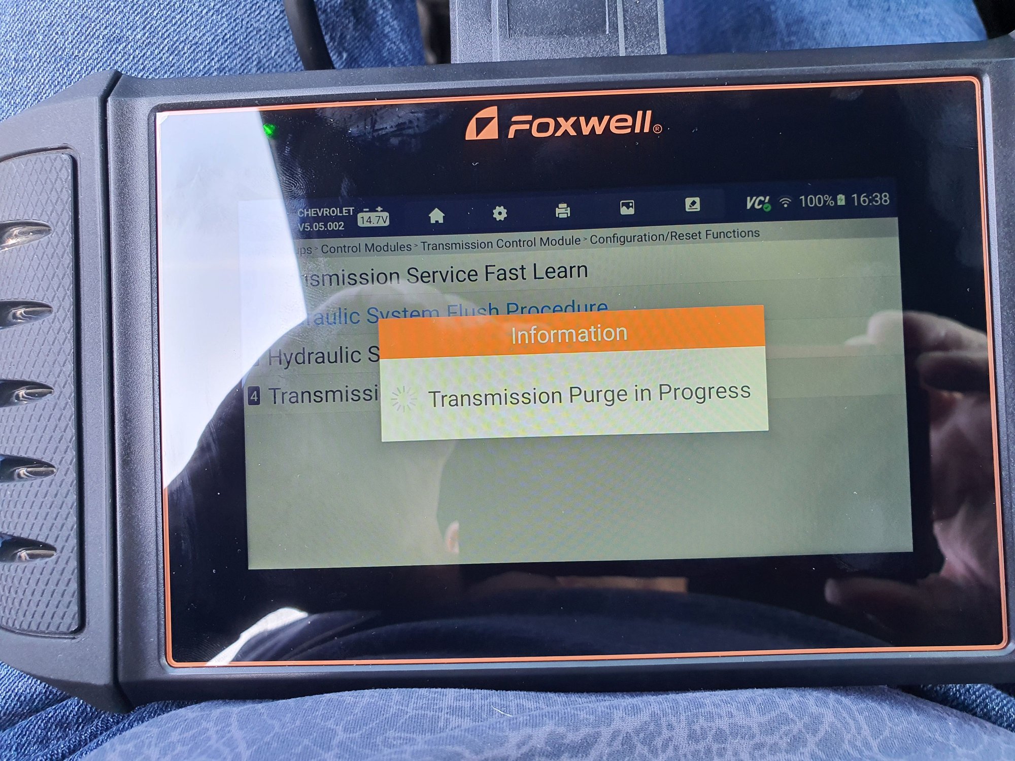

Here's a couple photos of the Foxwell NT710 screen - FYI
This is the NT 710 software version, etc. that was used to perform the System Hydraulic Flush on my 2020 Corvette C8 Z51.
This is the NT 710 software version, etc. that was used to perform the Hydraulic System Flush on my 2020 Corvette C8 Z51 - DCT
These are the auto manufacturers available for use on my Foxwell NT710.  I selected the GM option.
The scanner has a number of screens that will show up & are displayed when connected to an OBD port. It can automatically determine your car's VIN number and then proceeds to offer appropriate screens to perform selected services for your specific car model.
Since I'm already done & finished with the DCT service I'll have to remember to take those screen photos next time.... maybe!
Select the transmission module (#2) and access services presented.
Select the transmission control module (#2) and access services presented for the DCT. Unfortunately, the leak test was one that didn't work on my 2020 C8.

I verified today the Foxwell NT7100 works with my 2022 Z51 HTC. I ran the flush test successfully after the oil temp got up to 170 deg.
I ran the leak test prior and it worked but after running the flush it wouldn't work. I wonder if it is because the oil needs to be cool?

Both of you guys that did the DCT flush with the NT710.....would you mind describing the flush procedure......exactly what you did and how long it took? Thx!
I have a video but it's to large to upload.
I had to wait until the oil temp got to 170 then ran the Hudrolic system flush procedure holding the brake down.
RPMs went up to 2000 for 10 minutes and then said complete.

That is the correct flush procedure. That it works on MY2022 and earlier C8's is puzzling. I need to do some research on Foxwell and understand how they are somehow running GM CAN-FD processes in a third party tool.
