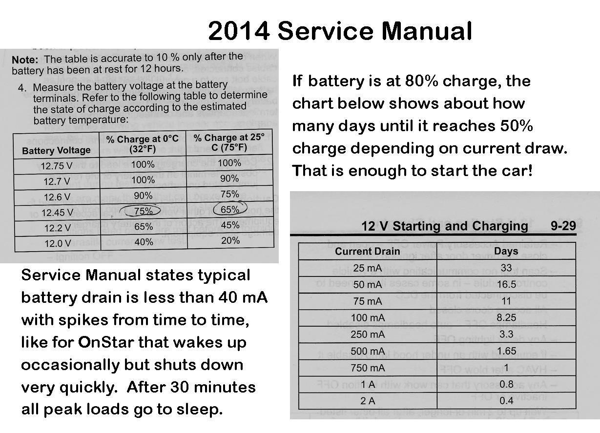

As Andy notes "with DATA" the battery drain as the OP asked "Goes To Sleep" if you check his post after ~15 minutes or less. Want to check yourself without an ammeter, open the frunk, Truck and turn on the interior Map Lights. Wait 5 to 10 minutes and watch them all turn off.
To put Andy's 10 milliamps in perspective an LED Night light, this one consumes 0.5 Watts. 10 milliamps on a 12 volts system is 0.01 x 12 volts = 0.12 Watts! Heck a single AAA penlight LED flashlight uses a much higher wattage bulb!
Here is data on the length of time a car battery can sit STARTING at 80% charge (all the alternator will typically charge to save energy.) This is from my 4 volume 2014 C7 GM Service Manual (the C7 also had battery saving circuits, but not as low a current draw as the C8. As shown with 25 milliamp current draw an 80% charged battery can sit 33 days. With 10 milliamps easily 6 weeks. BUT agree with Andy after 4 weeks I would put on a charger.
MY EXPERIENCE WITH TWO C7s STARTING WITH A 2014, TWO C8s STARTING WITH A 2020.
I have, but seldom use a GM charger. I was on vacation for 3 weeks with my C7s many times. Never installed my GM charger. Why? In SC we have many thrundertsomas in late summer days. I have replaced a number of things plugged into the garage because of lightning. NO reason to use a charger and why risk! Was on a number of 3 week vacations with the 2020 C8. Car started fine.
Now with my E-Ray and it's Li-ion battery can easily go 6 weeks. Was an a river cruise in Portugal last September and going on a 3 week cruise in Scandinavia June. Will not use a charger- NO NEED.
Your car your choice BUT NOT NEEDED.
