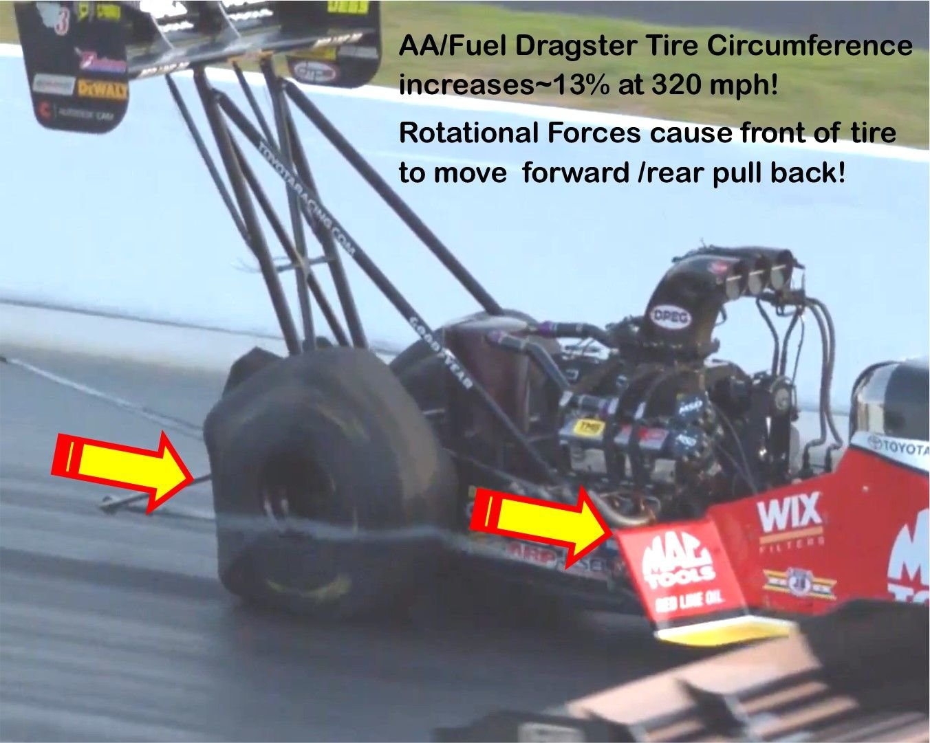

Hmm, that is what gears are all about! Torque multiplication. Could of used torque and hp equation but didn't want to confuse you!
OK 5% more torque would be 5% X C8 max toque of 479 ft-lbs = 24 more foot lbs.
Now: HP = Torque x RPM ÷ 5252
I'd go through the derivation but don't want to lose you! We'll use the gain at max torque rpm which is @ 5150 RPM
So extra hp (a derived value) is 24 ft-lbs = 23.5 hp!
Yep John Force (who is almost as old as I am) knew that when he was a Freshman in High School! By the way he is well aware he can only use a 3.20:1 dif ratio by rules. He doesn't use any gears! Now his tires do grown ~13% at 320 mph so could consider that a gear!
PS: Yep next to Paul Newman who won an SCCA race at ~81 John Force is one of my hero's. Of course the best is Kris Karamesines who went over 300 mph in his 10,000 hp plus AA Fuel Dragster at a National Meet this year at 87!
