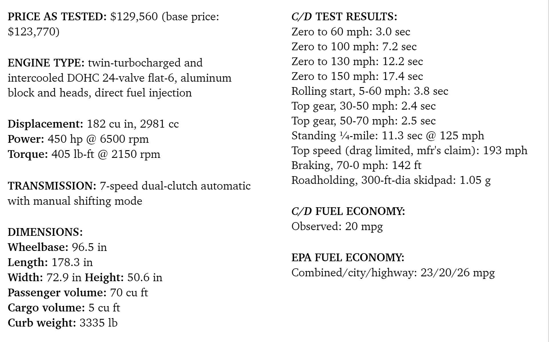

Here is the the data for a 911 GTS with 450HP and 405TQ and exactly the same size tires.
911 GTS 0-60MPH was 3.0s and 1/4 was 11.3s.
It's 0-60 times and 1/4 mile times basically identical to the C8 times leaked in the document in the other thread.

Originally Posted by baron95
I think you are assuming that there is a difference in performance (bought into the GM/fan hype) when in fact there is no difference.
And that car costs more than twice than the C8.... lol....
