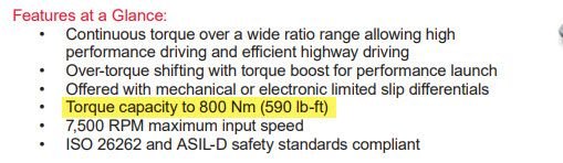

590 lb-ft is how much torque the clutches can handle. I bet if they changed the gear ratio for 1st gear it will be more. No different than the tall first gear in the C7 Z06 manual allowing the 6070 to handle more torque than the shorter gear in the C7 Z51.
Taller gearing actually puts more strain on the clutch, the taller gearing has a higher torque rating because the teeth of gears are thicker being there are less of them in a taller numeric ratio.
