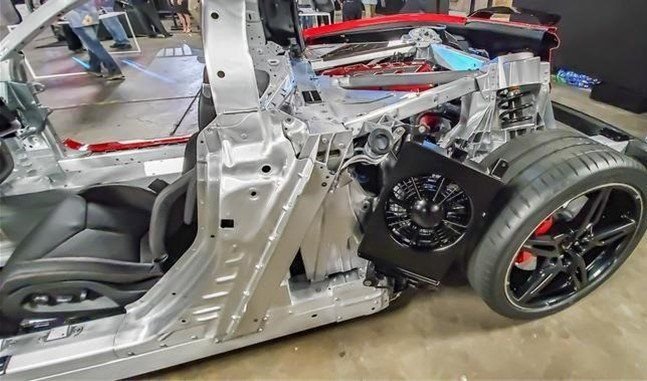

I saw online somewhere.
A Chevy engineer was talking about have a extra fan behind the driver's side vent for cars going to the middle east.
Does anyone have any more information about this extra cooling?
Thought it would be a good idea since AZ & NV are just as hot.

Originally Posted by Ragtop 99
I've thought wrapping my cooler for the winter too.
I forgot about the cooling needs for the transmission. what's the ideal temp for a DCT? I put an external cooler on my Camaro when I put a high stall in it. IIRC, the ideal temp (160 - 180*) was much lower than ideal engine oil .
Lots of cooling. These are some pics:
Z51 added Liquid/Air heat exchanger. Coolant from front rads gets extra cool and goes to DCT Heat Exchanger and Engine:
Liquid/Liquid DCT Heat Exchanger
LT2 Liquid Engine Coolant/Liquid Engine Oil Heat Exchanger- Similar to LT1 BUT Larger
That's the driver side.... that is only a fan used to push air through the engine compartment to keep engine bay cool in summer traffic. Front engine cars have the radiator fan to blow air over the engine whereas a ME car doesn't. The Z51 radiator is on the other side. Base cars have fans on each side.

Yep, when looking at the weight of the DCT versus the C7 M7 have to remember the M7 Trans cooler was a separate air to fluid cooler with a fan and the eLSD hydrilic pump included an electric motor with valves, hoses etc all separate from the Trans. With the DCT it's all together. That liquid/liquid heat exchanger is also more efficient than air/liquid.
Someone pointed out that the Z51 extra air/fluid cooler is on the other side of the car and what I showed was just the fan blowing air through the hot engine compartment when it gets too hot.
