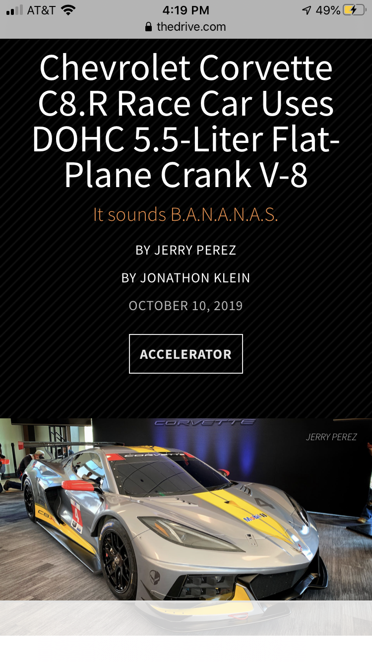

https://media.chevrolet.com/media/us.../1010-c8r.html We will get our first look at the durability of the flat plane architecture from the race engine variant. Admittedly, this engine will have been heavily massaged by Pratt & Miller but it has the same “roots”. This will be a challenging year for Team Corvette: ”NEW EVERYTHING”... (including one driver, albeit a damn good one). But since the IMSA BoP rules seem to penalize everything good except reliability, lets just say TC has tough sledding ahead. If we go back a few years to Chip Gnassi’s switch from BMW power to Ecoboost in his DP cars (to sort the engine out for the later to come GTLM Ford GT race car), it had many hiccups over a 2 year period. The previous BMW’s were virtually bullet proof.... the early Ecoboosts had every possible failure imaginable. I really hope I’m wrong on this score, but IMO anybody thinking this new flat plane DOHC engine will be even remotely as reliable out of the gate as its venerable push rod predecessor, is smoking something strong.

I have read that article 4 times. I still where it says it is a flat plane crank engine. “the C8.R will feature a 5.5L naturally-aspirated V8 engine, producing 500 hp and 480 ft.-lb. of torque”. Is there another GM article that says it is a flat plane crank?

[QUOTE=Racer X;1600732708]I have read that article 4 times. I still where it says it is a flat plane crank engine. “the C8.R will feature a 5.5L naturally-aspirated V8 engine, producing 500 hp and 480 ft.-lb. of torque”. Is there another GM article that says it is a flat plane crank? [/https://www.thedrive.com/accelerator/30317/chevrolets-corvette-c8-r-race-car-uses-a-dohc-5-5-liter-flat-plane-crank-v-8.

why do you think you are smarter than the gm engineers? they are putting a very solid contending engine forward and just because YOU think old SB chevy tech is more reliable than this engine, I think YOU might be the one hitting the stash
Honestly, this car will not hit the track without significant development time and testing and represents what GM is competing with backed by a pretty solid engineering team. You want old tech, look at other platforms.
Corvette is making some big strides in engineering capability and you probably should watch the race before you throw brick bats at the new engine.
I also don't believe we'll see a FPC in a NA engine in the STREET car. This is a C8R race engine. While FPC has advantages for a race engine, it's a bit expensive to implement in production street engines with a marginal advantage relative to cost.
Old Jan 3, 2020 | 05:34 AM
Rinaldo Catria's Avatar
Rinaldo Catria
Posts: 1,541
Likes: 729
I don’t think I’m at all smarter than GM engineers. To the contrary, I cited an example of some pretty smart people (Ford and Gnassi) who took several years to sort out their new engine. If you a want a GM example, go back several years to when Team Corvette had to drop to 5.5L on the pushrod engine. The higher rpms required to make needed hp resulted in cam shafts twisting and the valves and piston making contact in cyl 8 at Le Mans. Who ever heard of a cam shaft twisting? Only racing trial and error unveiled the problem. I’m just saying it takes time to sort out things in engines that are getting wrung out to near their max. Oh, and my money is on us seeing a flat plane V8 in the production car. You can buy one right now from Ford in the Shelby GT350.

Pictures of the motor in the C8.R don’t appear to show DOHC cylinder heads. Or am I missing something?
