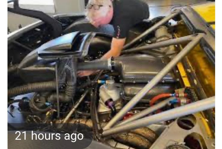

Originally Posted by Dominic Sorresso
I just a pic of the engine bay w what looked like an LT-2 valve cover, not one housing DOHC. I suppose they could do a FPC OHV motor.
They have been deliberately “blacking out” the window over engine bay of the C8.R.. if it was a pushrod engine, why would they need to do that? We will know for sure soon. I’m hoping tomorrow(1/4/20) with the running of the Roar.
I just found this pic. As you said it is definitely an OHV (not DOHC) engine. So why the erroneous articles claiming they were using a DOHC flat plane? No sense to using a flat plane in a pushrod engine. If they are using OHV, its almost certainly a cross plane.

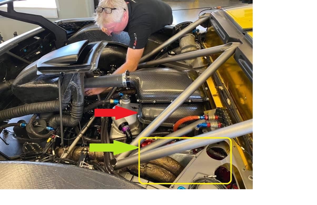

Pictures of the motor in the C8.R don’t appear to show DOHC cylinder heads. Or am I missing something?
looks like a DOHC size valve cover to me. Green yellow arrow and yellow outline indicate the red valve cover. Look in the back thru the chassis holes can see the back lower portion of the wide red valve cover and see where the exhaust headers come from.
Old Jan 4, 2020 | 11:58 AM
BJ67's Avatar
BJ67
Joined: Nov 2012
Posts: 3,163
Likes: 686
From: SUFFIELD CONNECTICUT
Look how big the dohc red valve cover is. yellow arrow and outline
Every DOHC I’ve ever seen have the spark plugs in the center of the cams (covers) and visible from the top. Not here.
Old Jan 4, 2020 | 01:06 PM
  #33
BJ67's Avatar
BJ67
Joined: Nov 2012
Posts: 3,163
Likes: 686
There are only small areas of the red cam cover exposed, plugs or wires would be totally hidden in this picture.
Thx. I was confusing the CF intake for the cam covers. And of course there are no “plug wires”, just wiring harness for the coils.
I was looking at pics of the Blackwing to see if the cam covers are the same.
Old Jan 4, 2020 | 02:07 PM
  #35
Rinaldo Catria's Avatar
Rinaldo Catria
Posts: 1,541
Likes: 729
I finally see the DOHC VALVE cover. I guess I need new glasses. What I was looking at was part of the intake. Da.. reassessing the scale to the guys arm, it would have been a 2.0 L V8 max if that carbon cover was a valve cover. Haha.
We are back to TC having to sort out everything INCLUDING a new power plant. Oh boy... long season.
