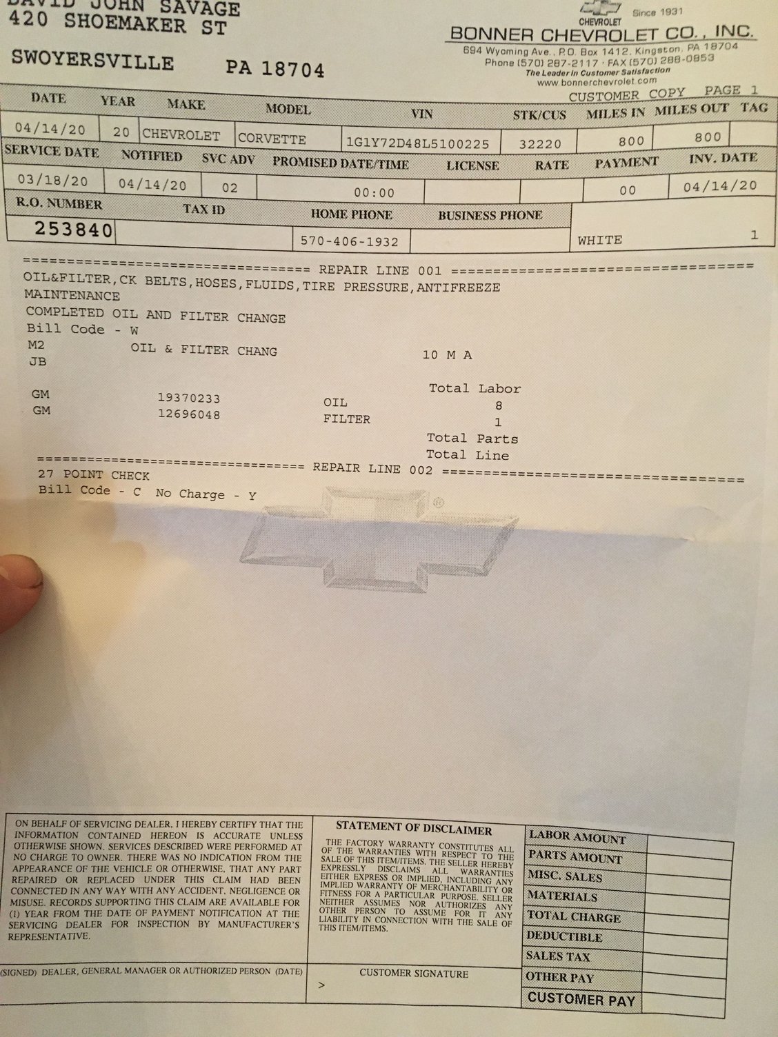

Did mine at 800 miles and I actually slept better afterwards, my two liters of transmission fluid is going in this weekend.
Oil is pretty cheap really. Did you get a chance to see / examine the old oil?
yes I’m someone who stands under the car everywhere it goes , too bad if dealership doesn’t approve and track alignment shop rolls their eyes at me too . Oil looked like I could have put it back in and I did not see metal shavings in oil filter, if I cut oil filter in half maybe I would ? Have seen something? Also the dealership mechanic told me the c8 does need a 500 oil change ( I was 300 late) and he told me he has a video on c8 to prove it , i didn’t see video I was changing it before 1k no matter what anyway.
it took 7 and 3/4 quarts of oil
Well worth the price for peace of mind.

I’m not sure why a 500 mile first oil change triggers so many guys ? I personally feel better knowing if their was any metal shavings from break in they are now history . From this point on I will be getting yearly oil changes in the spring before autocross/ tracking season I only average 4,000 miles a year .
I wasn't commenting on it being wrong to change at 500 miles, only the mechanic saying there was a C8 video that showed it was necessary!
In fact, although my September 2013 built C7 Z51 did not have the 500 miles change requirement and since I change my own oil, I did at 1500 miles "just in case" AND to install two magnetic drain plugs. In fact until about mid 2014 dealers WOULD NOT CHANGE oil for FREE until the OLM said less than ~20%. They had a good reason since we were to get 4 free oil changes (remember this was before the GM bulletin in November 2014 which added a 5th) BUT that had to be within 2 years. So if driven less than about 7500 miles/year we would only be entitled to two FREE changes. Dealers were concerned they would NOT be reimbursed. It fact there are forum posts where dealers where not reimbursed and made the owner pay!
ALL THAT SAID, SINCE THE C8 WARRANTY SAYS 2 FREE SERVICE IN THE FIRST YEAR, DID YOU GET THE 500 MILE CHANGE FOR FREE???
