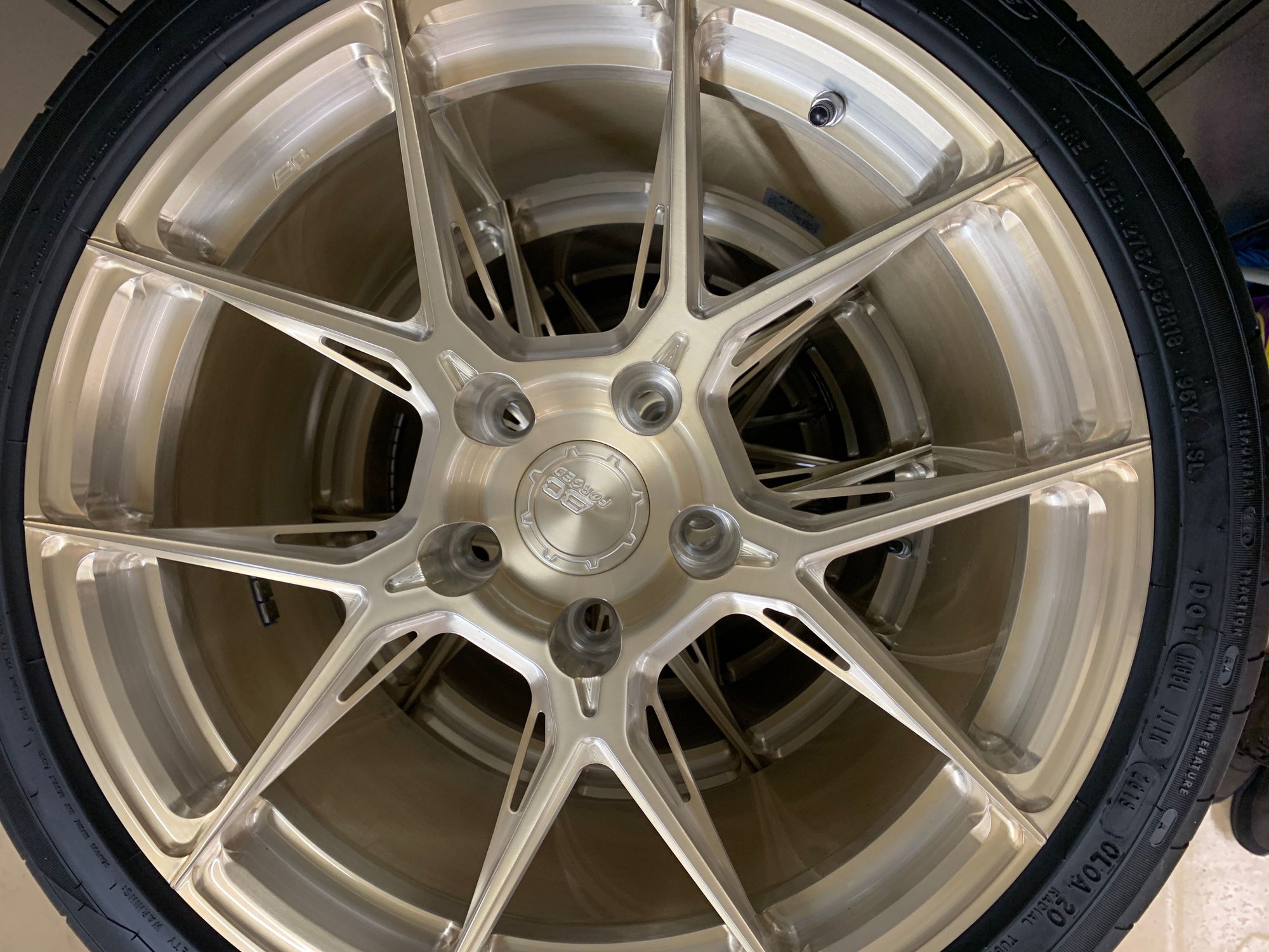

Thank you sir! Sensors and nuts ordered.

Sensors installed in the new wheels and tires mounted. Apparently the nuts that go with the C8's sensors are a different part number Wildhammer didn't have yet, I had them send me the Camaro nuts, which worked fine.
Thanks again Zymurgy for the link. Now if the car would just get here!
