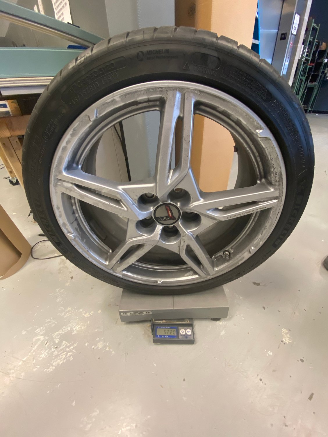

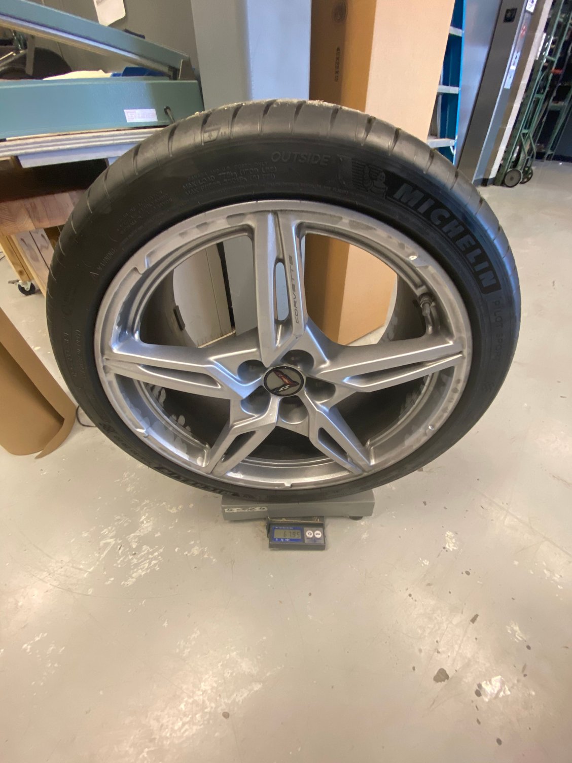

Wheels
Front Wheel w/ Tire 52.20 lbs
Rear Wheel w/ Tire 67.95 lbs

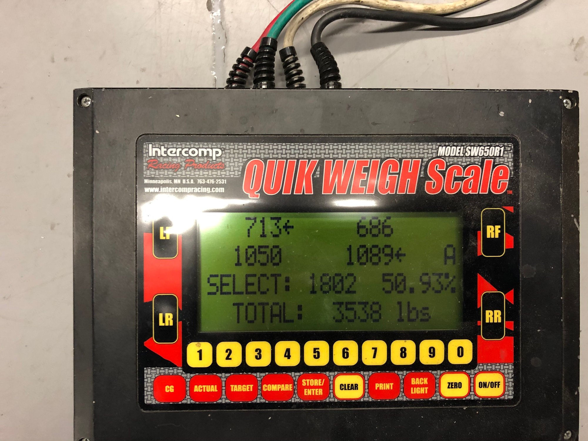

Yeah ours was 3,538 on an empty tank

Dane, can you please post the corner weights?
Thank you

This is with no driver?
Old Mar 18, 2020 | 04:41 PM
Dane@LGmotorsports's Avatar
Dane@LGmotorsports
Premium Supporting Vendor
Joined: Sep 2017
Posts: 1,457
Likes: 657
From: DFW Texas
No driver on empty.

Originally Posted by jrhoades
What's the car's spec (1, 2, 3LT)? Does it have front lift?
2LT Z51 no front end lift

For reference. A nickel plated c7z wheel weighs 63.5 lbs with a 335/25r20 runflat.

Thanks. Can you jack the back up as high as you can while on the scales. Record load transfer. Measure the angle or height difference difference at the axle. You can calculate the exact location of the CG. Give me the numbers and I will do it. All chassis tuning starts at this point.
