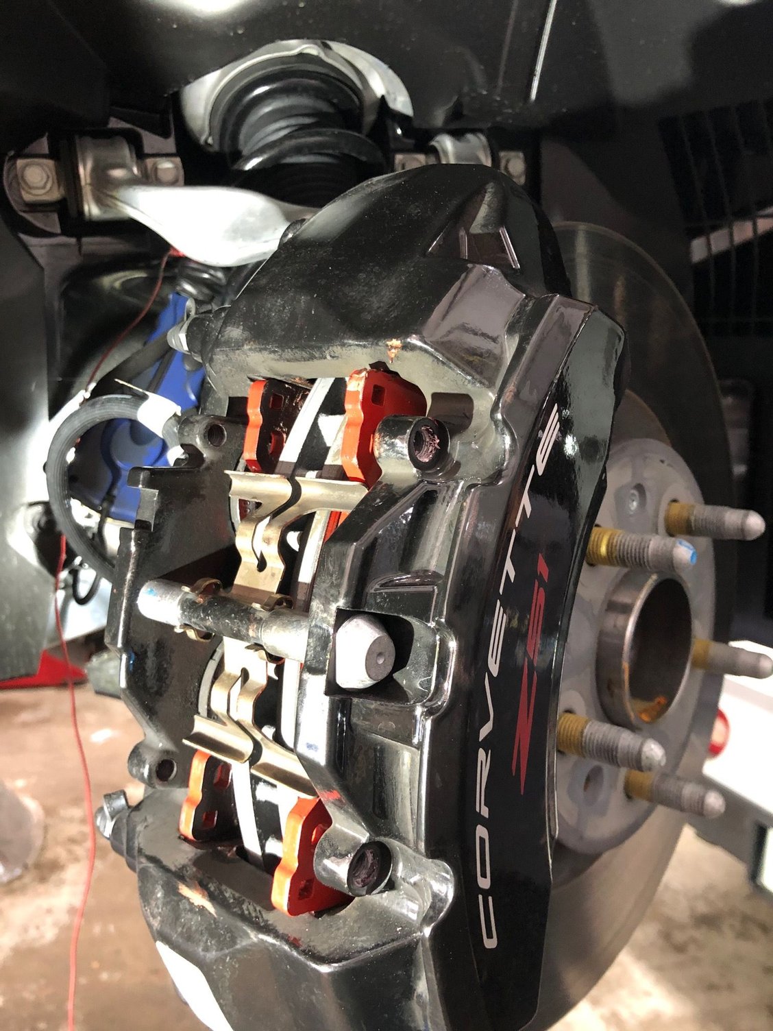

Had the C8 up on the lift today to install the new ceramic pads. I know it was said earlier that you had to disconnect the battery. That is not the case, I would have the ignition turned off and don't step on the brake pedal while doing this, but that was the case with any model year prior as well. The point is, even with the C8 having brake by wire, it will not blow the pistons out by removing the pads even with the battery connected. Here is a pic of the rear brake.

We are going to do one. Right now the front caliper had to come off to replace the pads in it. We will be doing a video soon on replacing the pad with the caliper in place and where you will need to get the tools from.

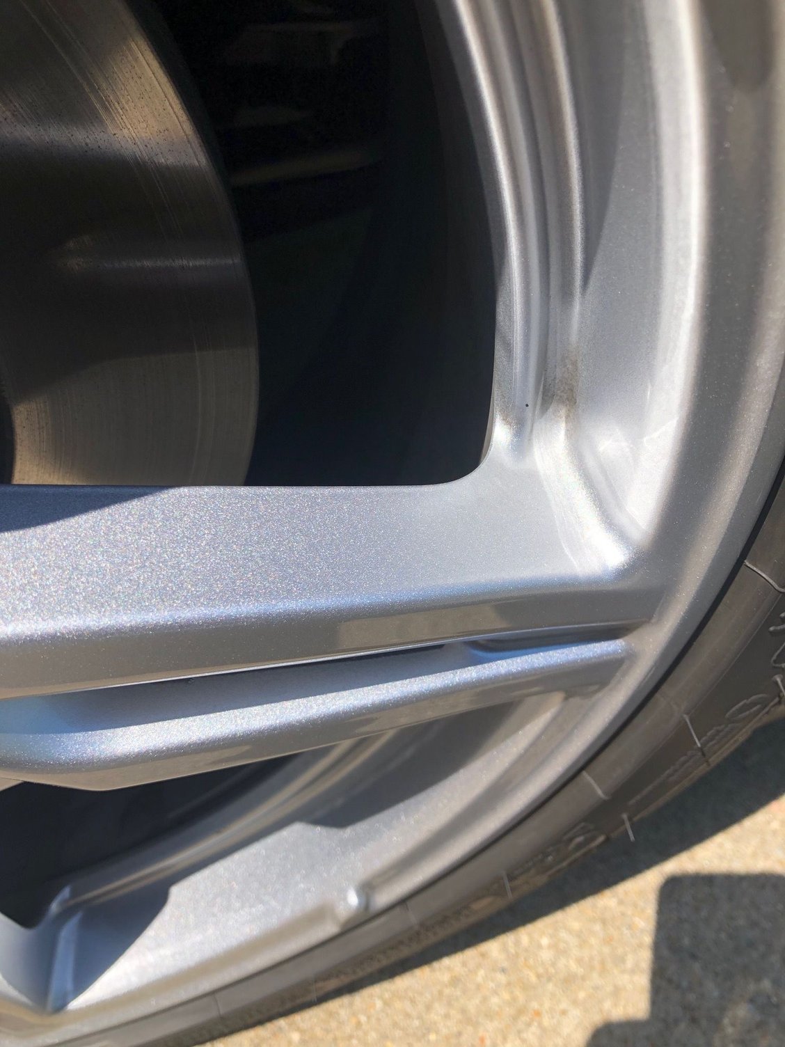

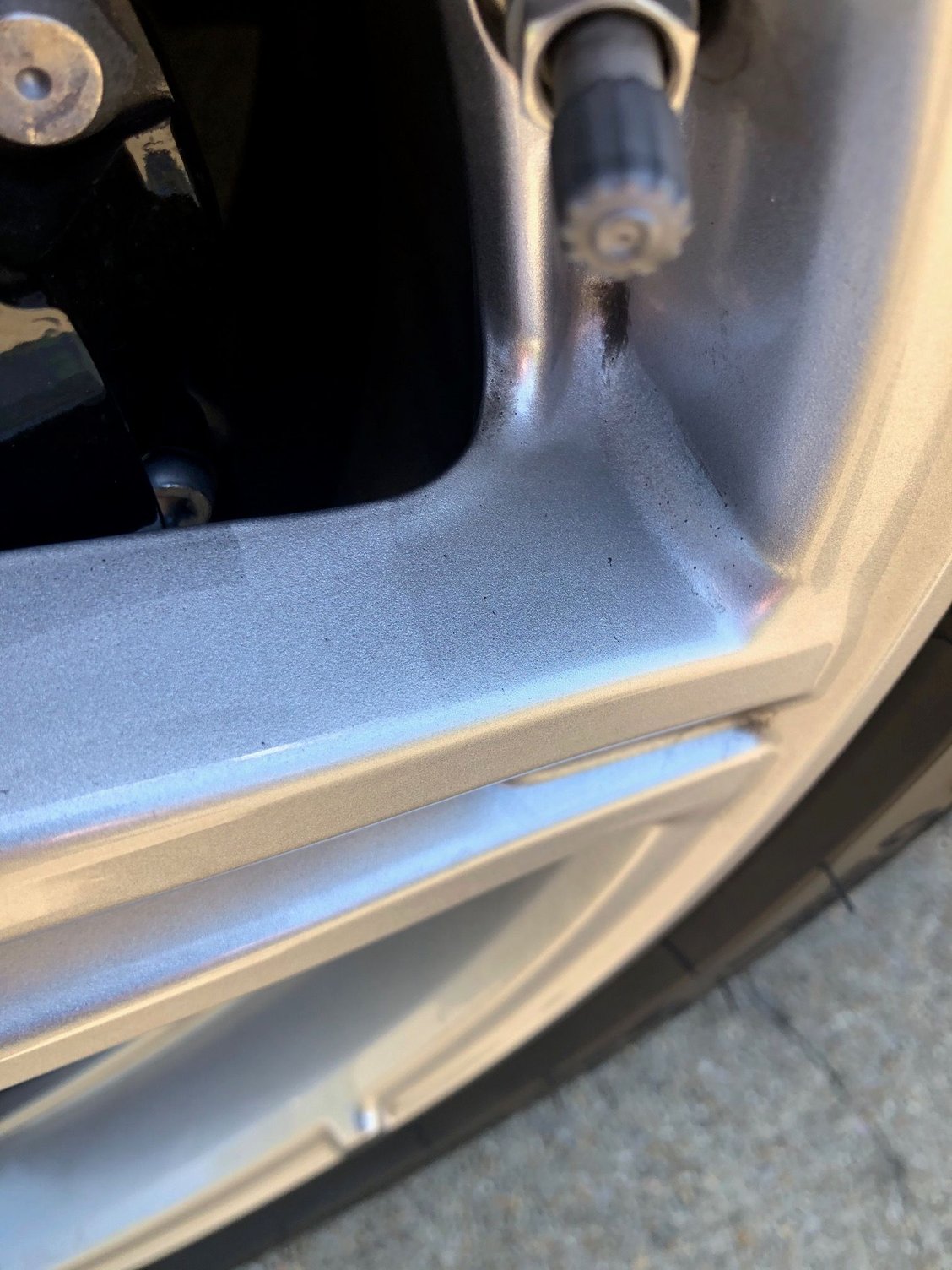

Ok here is just a quick picture. We had some rain yesterday so we didn't drive the car. We are going to do this test for 100 miles but I wanted to show you a quick pic of where we are at just 30 miles into this. The dust is not bad yet but it is getting there and I might add it was a easy drive home and back to work.
To C8 ceramic brake pads

Why did you have to remove the caliper? What tools will be needed?.

The bridge bolt on the new caliper is non servicable. It is also a new fastner design, it looks like a spline but it isn't and it is not the Volvo 11 point. So far Kent-Moore or Snap-On have anything that will fit it. When I looked it up through GM you can't even purchase the bridge bolt, it is part of the caliper. I may make it, not sure yet but for now you will have to remove the front caliper to replace the pads. The rear caliper can stay on since it does not have a bridge bolt and just has retaining pins.

[QUOTE=J.Abbott;1601337363]The bridge bolt on the new caliper is non servicable. It is also a new fastner design, it looks like a spline but it isn't and it is not the Volvo 11 point. So far Kent-Moore or Snap-On have anything that will fit it. When I looked it up through GM you can't even purchase the bridge bolt, it is part of the caliper. I may make it, not sure yet but for now you will have to remove the front caliper to replace the pads. The rear caliper can stay on since it does not have a bridge bolt and just has retaining pins.[/I
Thanks for the reply. I sure some tool company will have a tool soon. Taking off the caliper is not a big deal, just more work. Keep up posted
