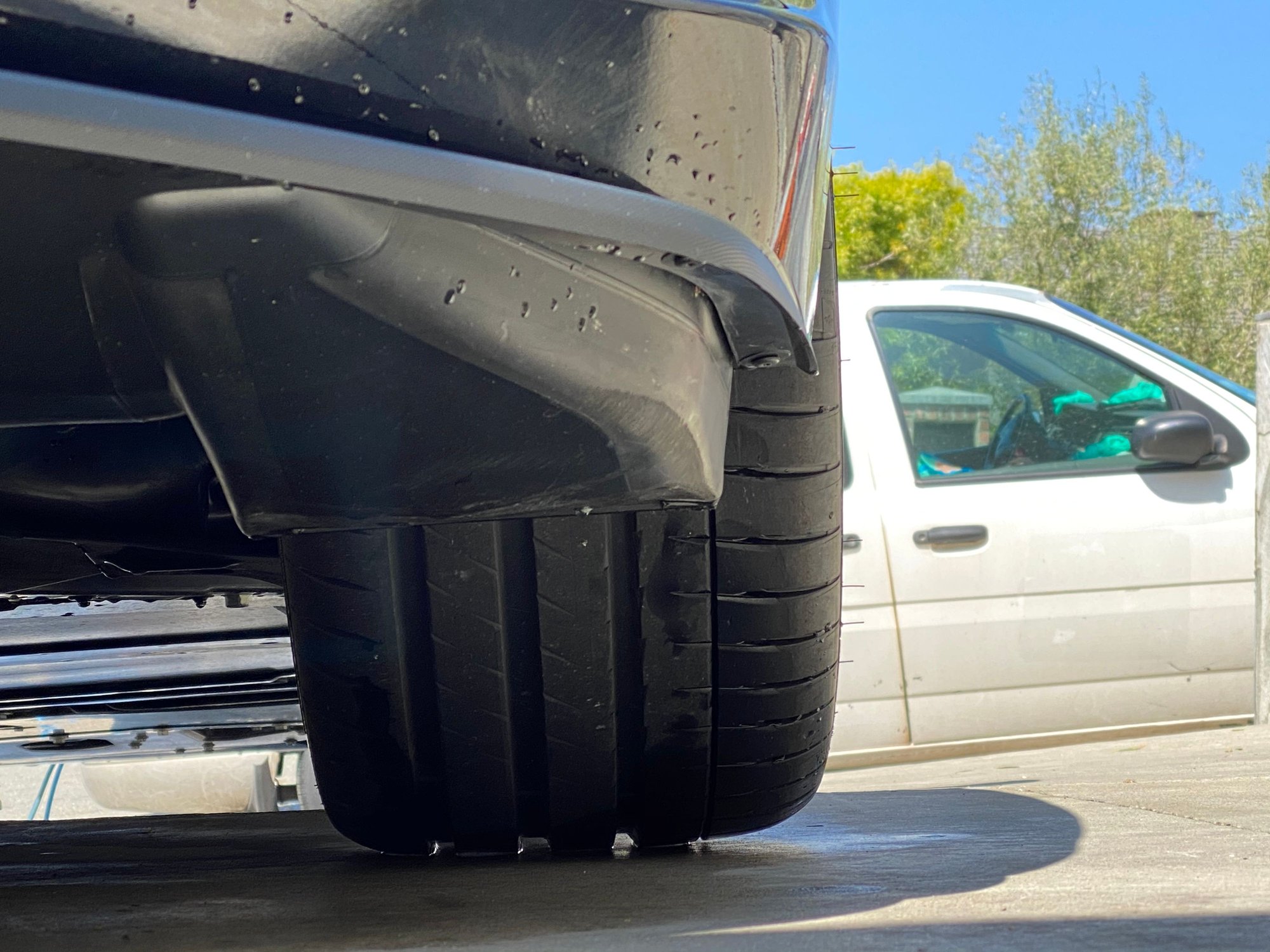

Thought you may want to see what’s GM’s
track camber spec actually lookalike on the ground

A number of guys have run up to -3 degrees on their C7s. A large number set their camber to -2.2 to -2.5 so the GM C8 recommendation isn't that far off from what people have been using on previous generation cars.

Call me crazy, but I have noticed that having the track alignment, has negatively affected the handling dynamics on the street. In spirited cornering on the street, the cornering sensation seems more sedate. It feels like I’m not pulling the same lateral load, but the G meter says I am. I think what’s happening is that with the standard camber, the tire is rolling over on the shoulder, and you get a nice road feel from this. The stiff sidewall of the run flats only accentuates this, and it really is a nice sensation. I don’t feel this with the track alignment, because the tire is flatter in the corner. Of course this works to your advantage on the track, and will allow for higher speed cornering, but it lessens the experience on the street, at least that’s what I’m experiencing. So in addition to accelerated inside tire wear, this might be another liability of running a track alignment on the street.

G Force is G Force it doesn't feel any different on the street or the track. Go around the same radius turn at the same speed on the street as on the track and the force on your body is the same and feels the same.
