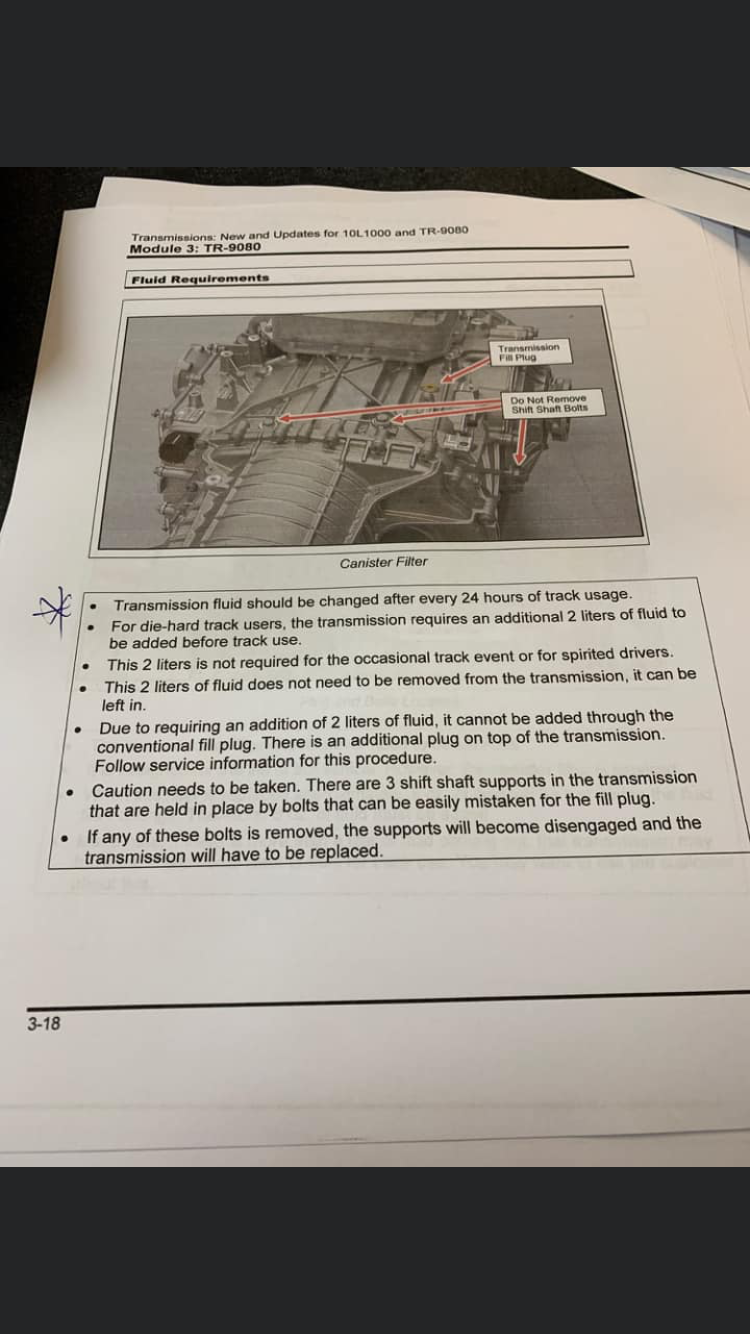

Originally Posted by savage
I gave this to mechanic and he said thanks ! Lol
@savage , can you share what/where this document came from? Would love to see what's included in the rest of the doc. Thanks in advance!

Took mine over to my trusty suspension guy a few weeks back and he agreed that the GM track setting would be a bit harsh on tires for street driving so he gave me a setting pretty much in the middle/in-line with what Rapid posted above. I had the car at Nurburgring this past weekend and there was ZERO understeer, the car felt great everywhere at the 75-80% I was pushing it. Tracks good on the highway too, didn't seem darty or floaty at speeds over 150-160ish.
As for the DCT fluid, I did that myself. It looked and felt sketchy as hell jacking that rear corner up so high but everything went in and seems fine so far. When I first took the plug out, I didn't have the car lifted high enough and lost a few ounces before I could get a few extra pumps on the jack. When I started filling, I had a buddy standing by to give me a few extra pumps when it started to get too full. At the end of the day, I measured 42cm from ground to bottom of rotor to be able to fill it with the extra 2ltrs.
