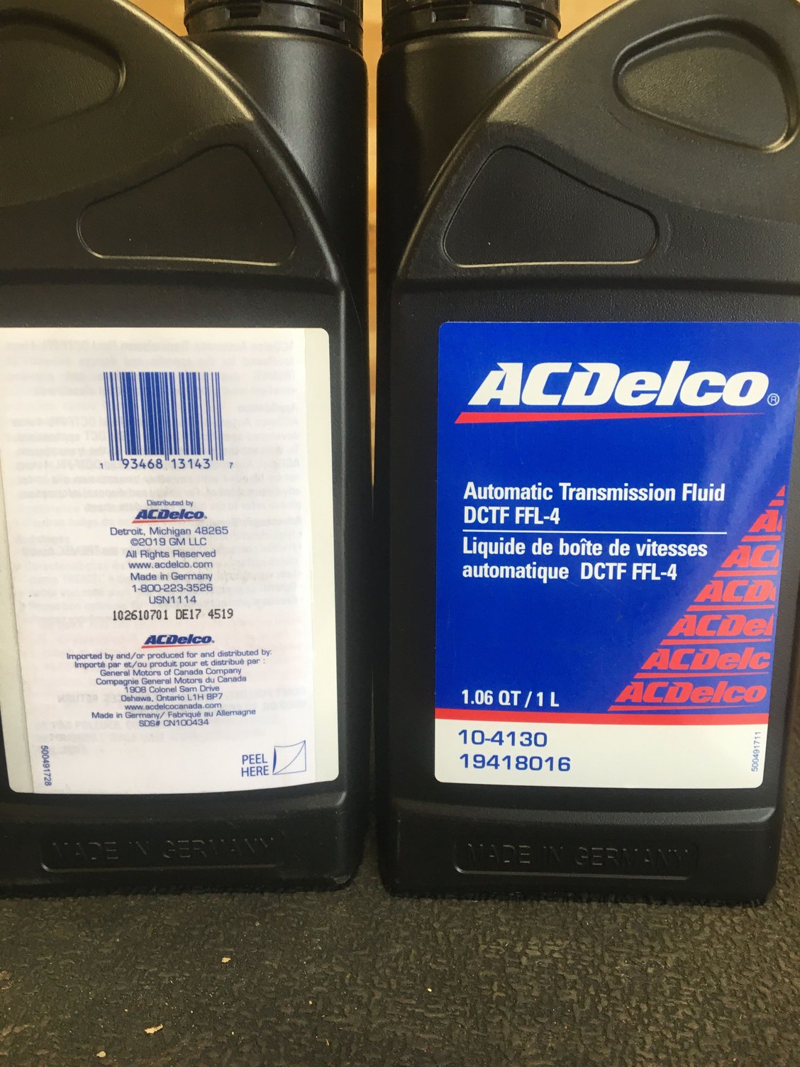

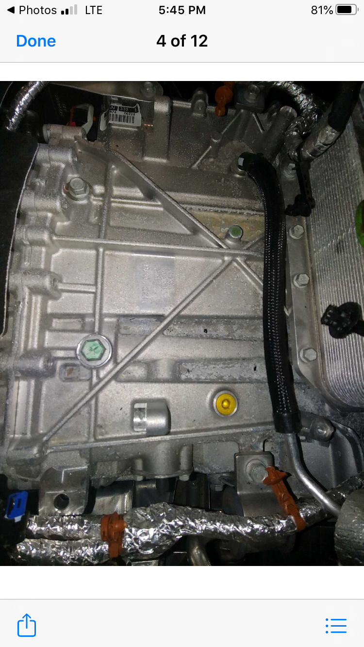

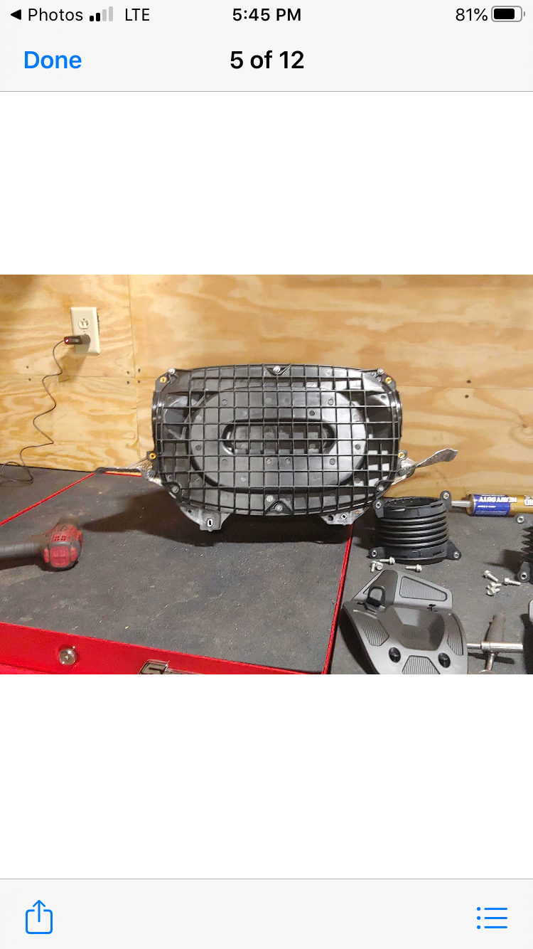

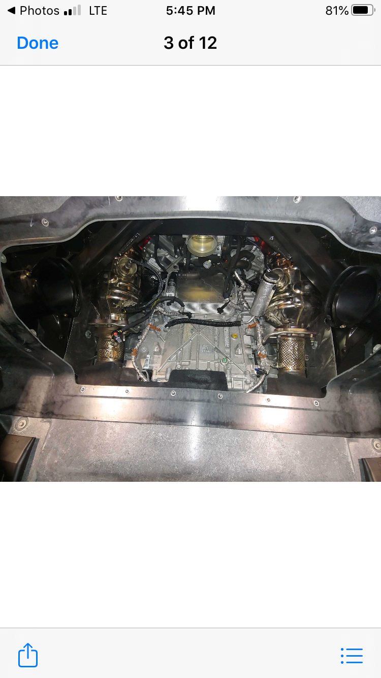

Dealer had the fluid and the know how so I paid the dealership mechanic to do mine at his house
I gave this to mechanic and he said thanks ! Lol
He said this needed to come off
Picture he sent me
I was told it took two hours start to finish
