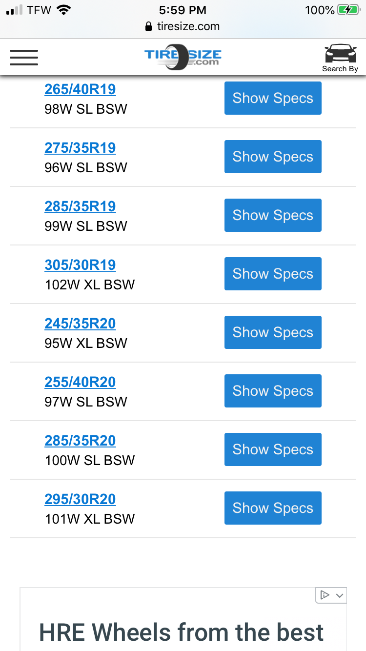

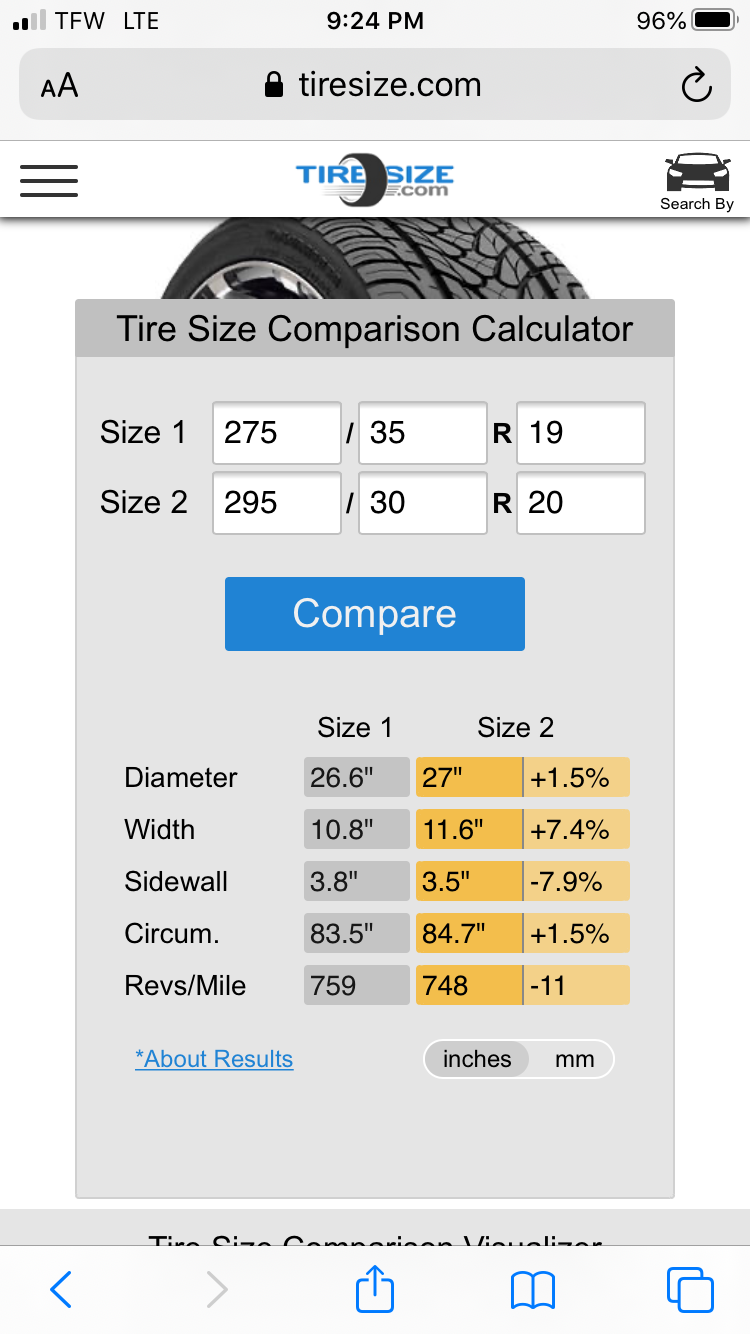

Ok this is just a FYI to help anyone who might be changing tire size, I happy with my results and can’t wait to autocross this car . Ok (I) wanted R71R’s on ( my) car and the biggest I felt would be safe on factory wheel was a 275/35/19 up front on the 8.5 wheel needed to stay in SS class ,the concern was the biggest 20 inch is 295/30/20’s for the rear which are only .4 inches taller and with my front wheels pinched I feel they are pinched a little taller than normal? I could have went with the 285/35/20 rears but going to a 295 from a 305 was hurting me enough , ok let me get to the point of post , not every key cycle but every now and then when i first start car and start driving the T/C light on the dash flash’s and the brakes apply themselves this actually happened with my c7 zo6 when I went 18’s front and back and the fix is the same as c7 - all I need to do is push the T/C button off for a few seconds while driving and when I put the T/C back on ( push button) the car is fine and doesn’t happen again on that key cycle. Ok that it I’m posting to help people that’s all , maybe the R71R’s will come in taller/ wider sizes in the future? But until then this is my fix , actually any type of tracking/ autocross I will be doing I will double click anyway. Thanks for reading and personally I think square will work on this car .

the 18/19 was initial plan but I wanted exactly the factory offsets without spending 5k per set for one piece wheels , I stole this 2nd set of factory wheels ( cheap) , what is your plan for wheels and cost? With the 18/19’s your after you can go with 275/35/18 front and 305/30/19 rears with the R71R’s and definitely won’t have issues.

In general, a square setup is one where the front and rear tire widths are the same. All of your complications have to do with the car's unhappiness at the change in circumference ratio from front to rear. Certainly given the range of choices available, there probably existed a square tire combination that wouldn't upset the TC but given the rear wheels are 2.5" wider than front, it would have been a mess to try.

One thing that we have to remember is the issues with TC, stability control etc if you are to far off the factory dia front to rear.
when you say it protest and you can make it go away, you might turn light off but your stability track program , TC etc. will struggle on track ?
Rule of thumb on C6 and C7 was not to exceed 5%, and the further away from that 5% difference the less chance of overworking and getting a car that fights the forces during a track event...
I always tried to find tire combo that put me less than 2%.
Not sure if that's still the case, but something to keep in mind ?
