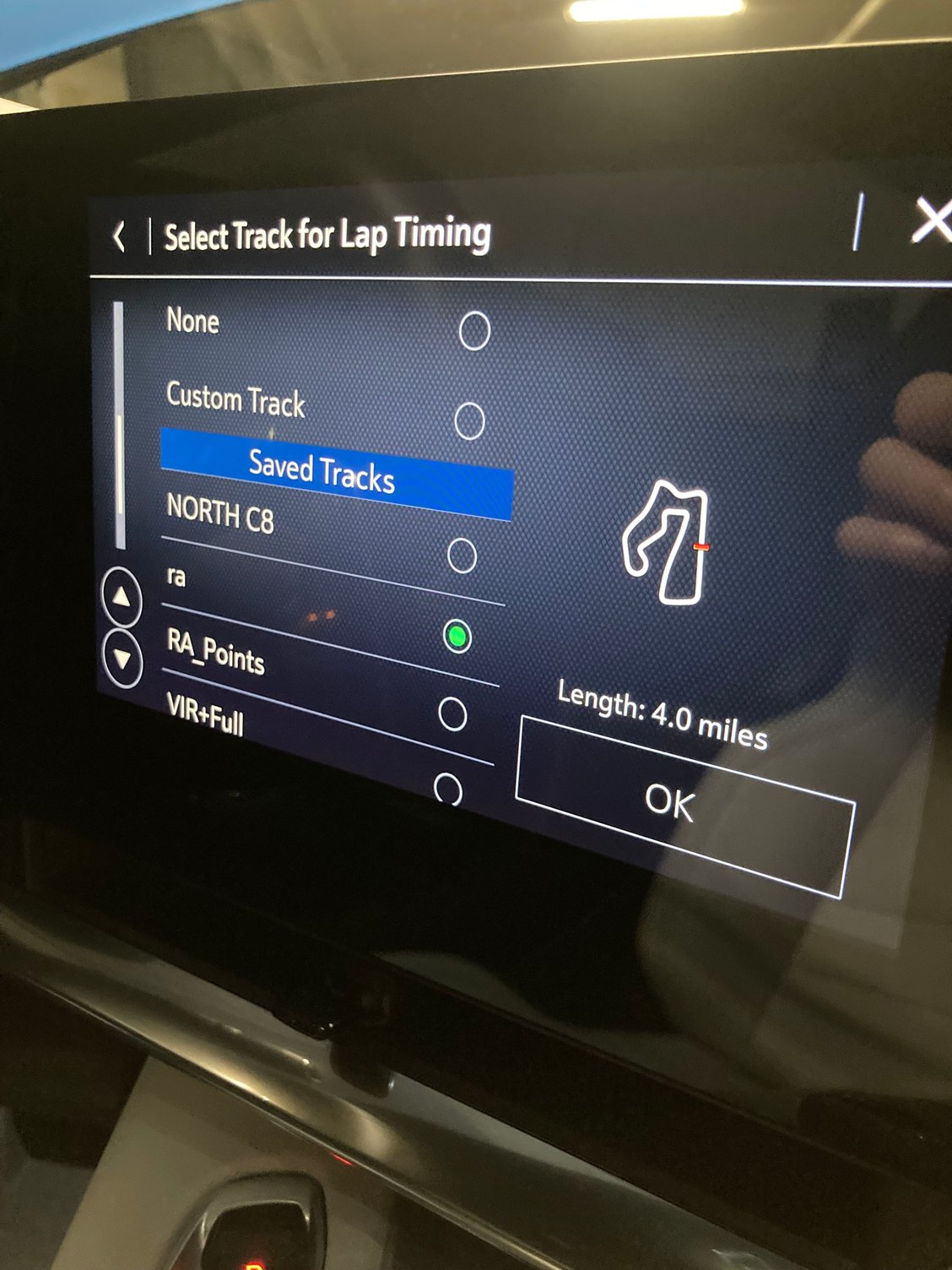

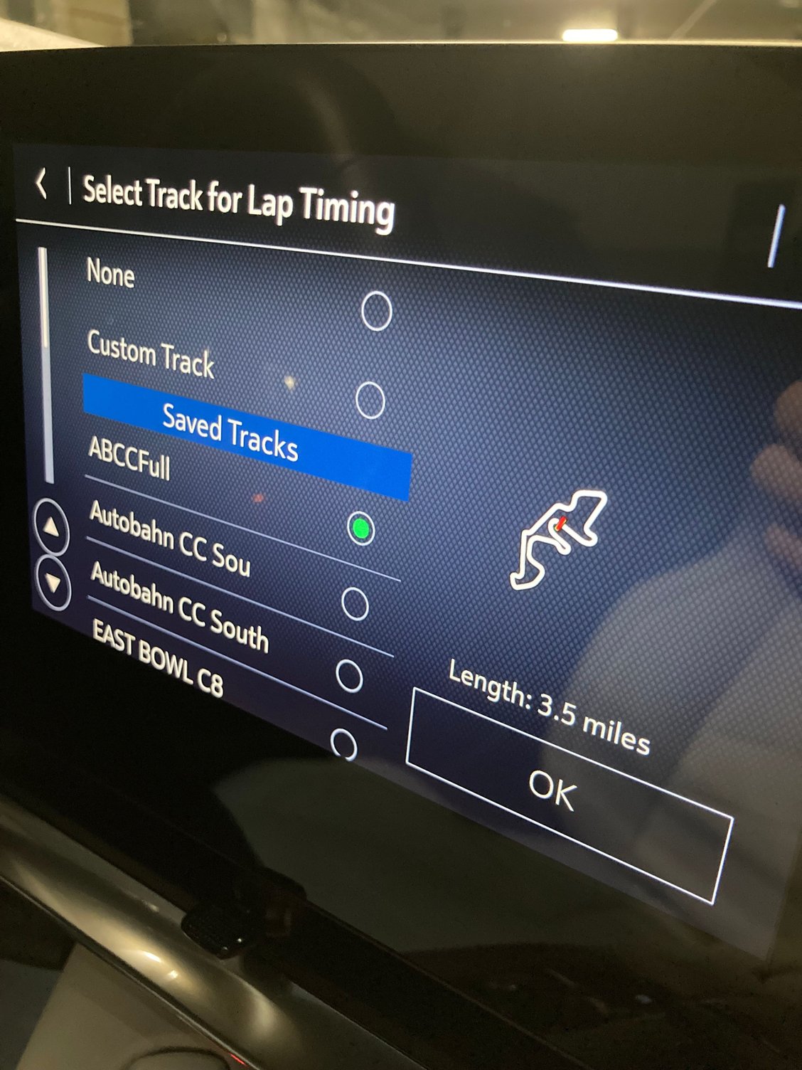

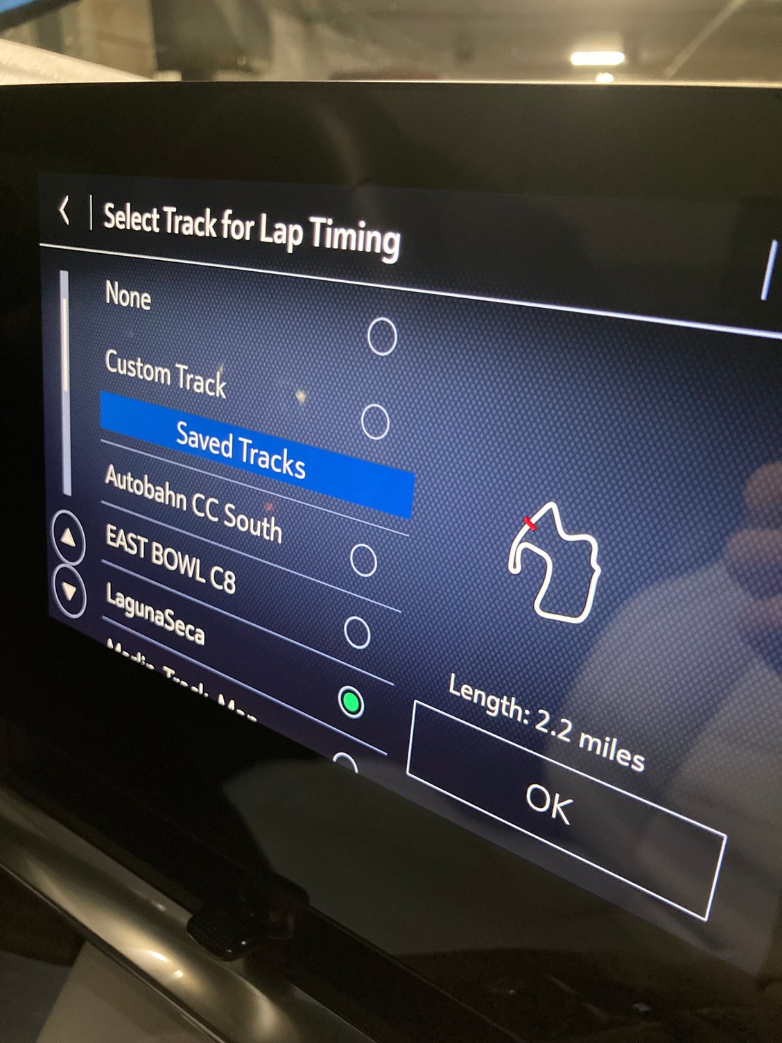

Hi @Poor-sha - I was fiddling with some C7 map files for Road America and ABCC Full Course from this thread https://www.corvetteforum.com/forums...-thread-3.html by trying to convert the C7 file to Google Earth MAPS and back to GPX using an online tool. Then, I copy the files to my SD card to plug in the C8 PDR. If it shows a map like these pictures here, does it mean that it is working and PDR is recognizing the tracks?
Thanks!
