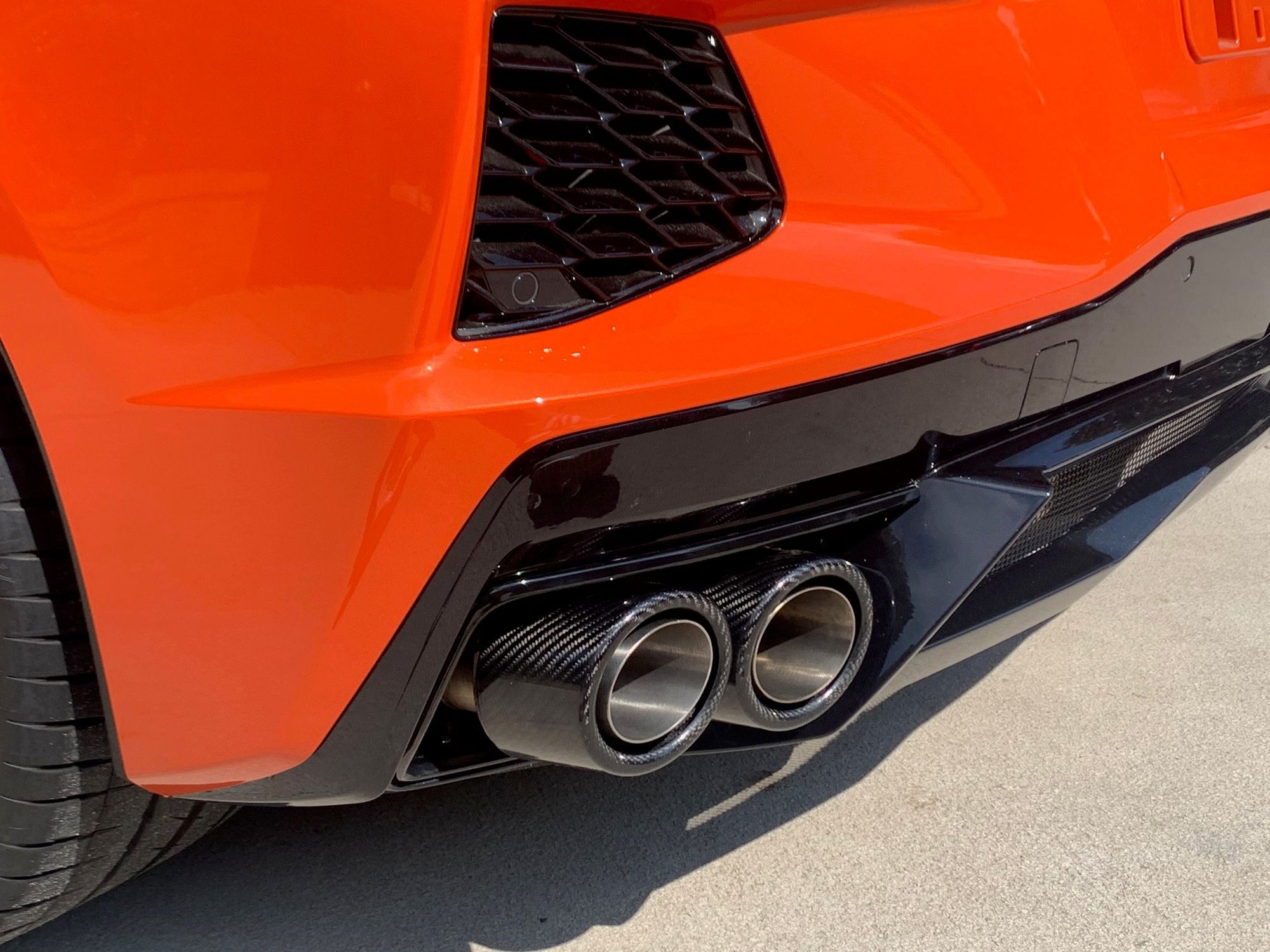

For the majority of passionate enthusiasts, OEM systems don't quite scratch the itch - whether it's the "base" option or the NPP.
Our Supersport X-Pipe has been our best seller for the C8 - and our carbon fiber tips have been the most popular way to finish the system off (we can all agree the stock tips are pretty awful):
