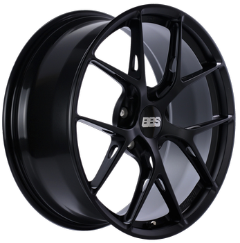

A lot of our dedicated track guys love Forgeline.
BBS has a flawless reputation as well, but I'm not sure if they offer C8 fitment yet. A set of FI-Rs would look great:

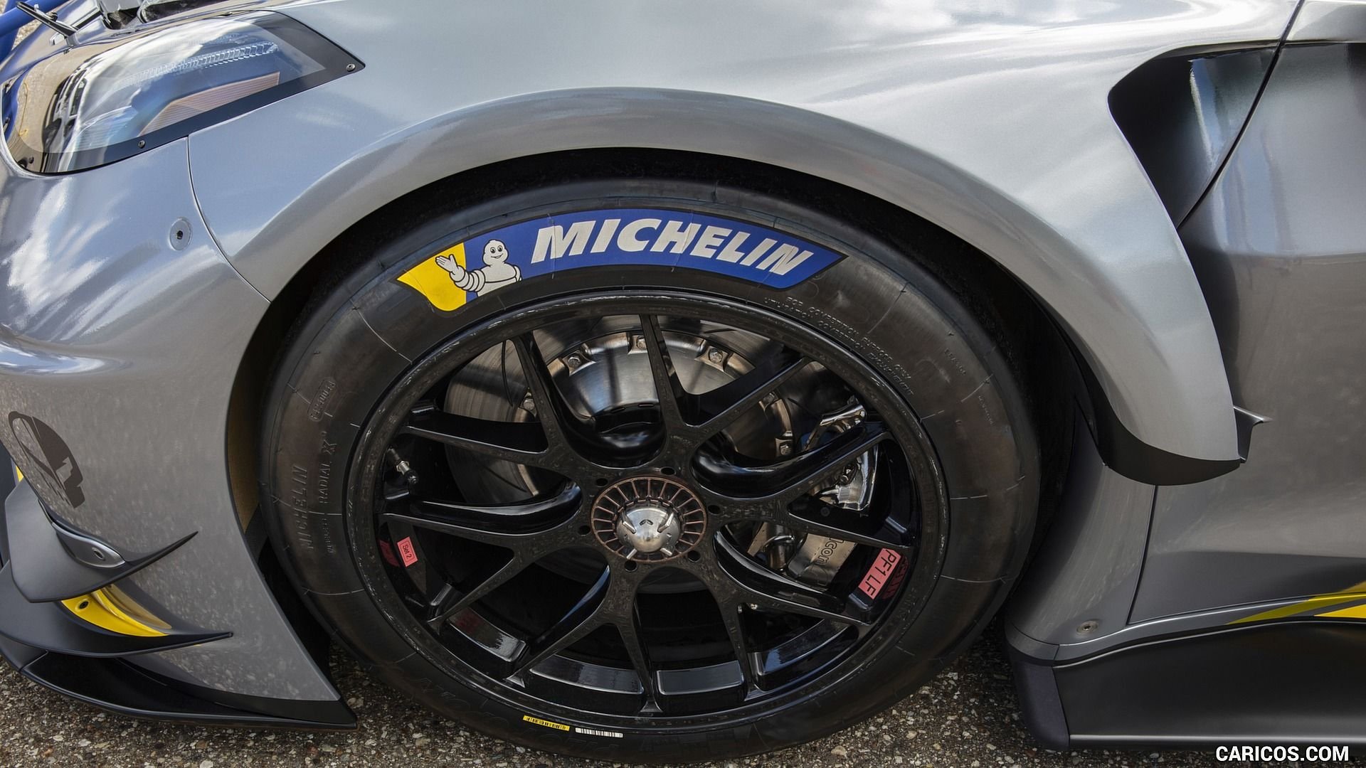

The C8-R definitely appears to have BBS fitted:

Judging by the Michelins pictured in the C8-R picture above, the advantages over alternate manufacturers appear to be just as relevant today as they were 20 years ago.
We deal with the most exceptional performance vehicles on the planet, and I'm not aware of any of them leaving the factory with Goodyears (including domestics). If the argument for purchase is for patriotic ties to country of manufacture, or budget, that's a different story, but the data seems to be clear that Goodyear isn't the fastest way around the track.
