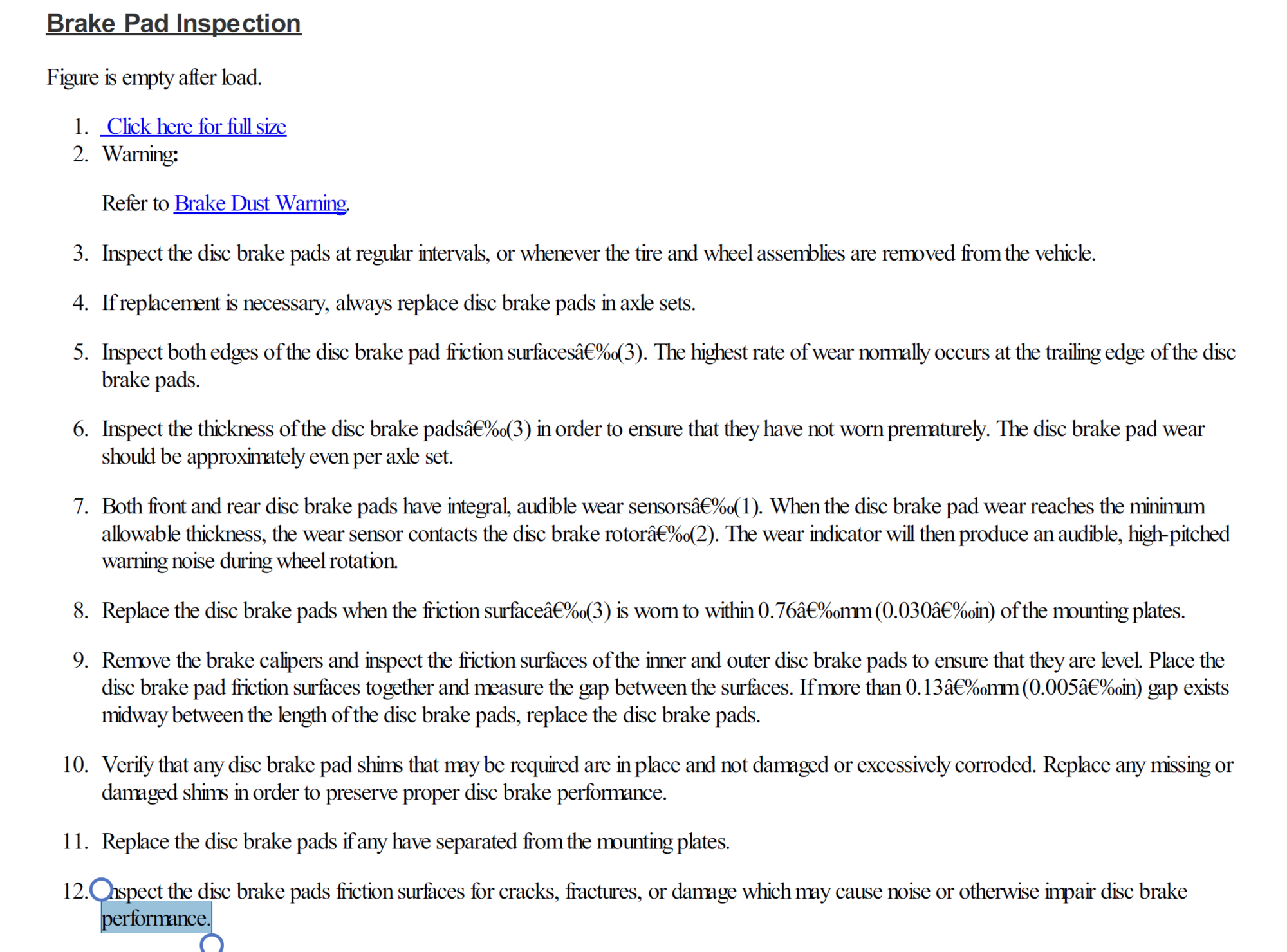

These numbers seem small to me. Too small. Edit: attached is the 2020 service manual on Brake Pads. I think the number are too small, perhaps a typo. A search for typical numbers, not specific to C8 is 1/8 inch.

I agree. .76mm (.030 in.) is pretty thin indeed!

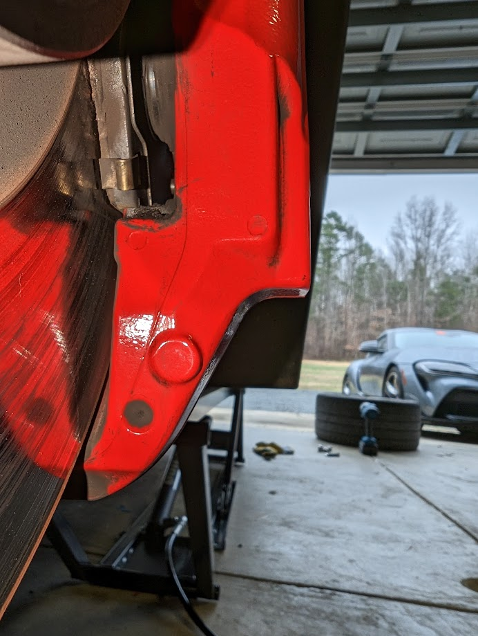

That's a surprising amount of meat left given the usage -- about half that thickness is wear you'll hit the wear indicator and they are completely done. In my experience the rears wear at about 60% relative to the front. Once you start progressing in pace the pad life gets exponentially shorter. I get about 6-7 sessions best out of a set of front pads (down from ~10). I'm a big fan of the OEM pads; super easy on rotors, zero shudder issues, cheap takeoffs are abundant. Only downside is the abysmal life.
about 0.030 before contact:
