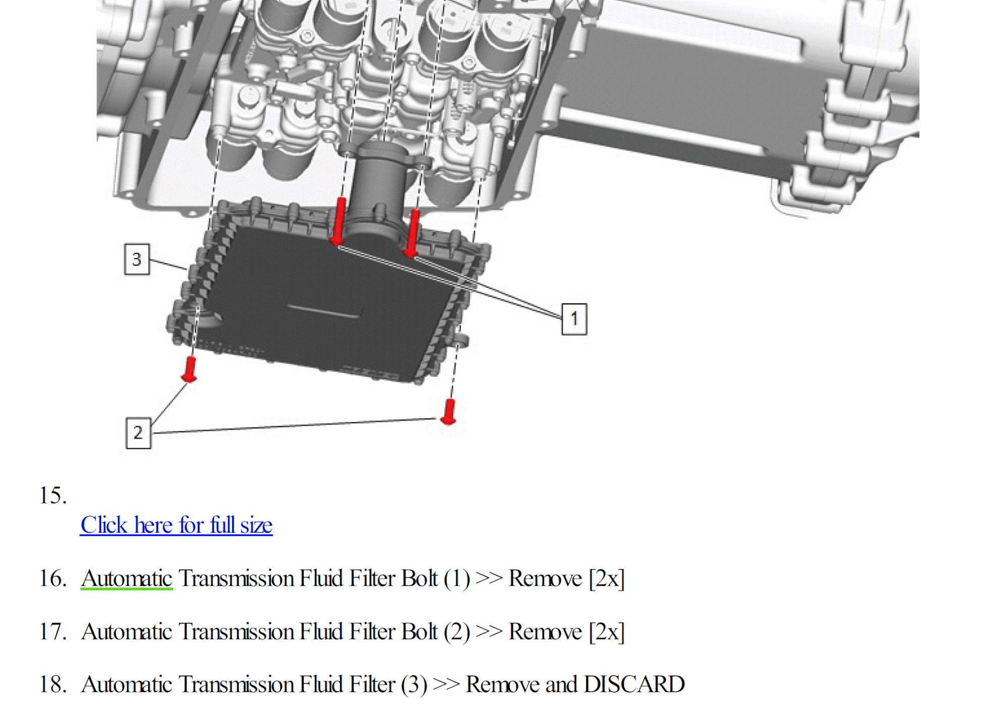

You may have missed the distinction I made between the internal filter and the external canister filter. There is an internal filter in the transmission that resides in the pan and serves at the pick-up for the fluid. That internal filter does not get identified in the Owner's Manual as ever needing to be changed. I attached an illustration of it. It is very likely a coarse filter and so it will not remove all the material that is removed by the external canister filter. The filter that is changed at specified mileage intervals in the Owner's Manual is the external canister filter. That is a fine filter. It was speculation (and I identified it as such) that the dislodged debris would end up back in the fluid pan, then be drawn though the internal filter, make its way to the external canister filter where it is filtered out before it gets to the lines and valve bodies. And I agree completely with @RKCRLR posts 27 and 28. That what matters whether GM accepts it - and that there may be other explanations for exactly how the hydraulic system flush clear the debris and moves it to the external canister filter.
The following, by the way, is the exact description of the purpose of the hydraulic system flush taken from the hydraulic system flush procedure posted by in another thread a while back:
"DescriptionThis procedure is used to flush the transmission fluid through the filtration system before a repair is performed that may have been caused by debris in the fluid."
Interesting that it says "through the filtration system". The steps to replace the external canister filter occur after the hydraulic system flush is complete, and are not actually part of the hydraulic system flush procedure. And, the procedure is not only called out as a step in the DCT external canister filter replacement, it is also called out by other procedures. Attached is an interesting service bulletin that also invokes the hydraulic system flush procedure as step 9.

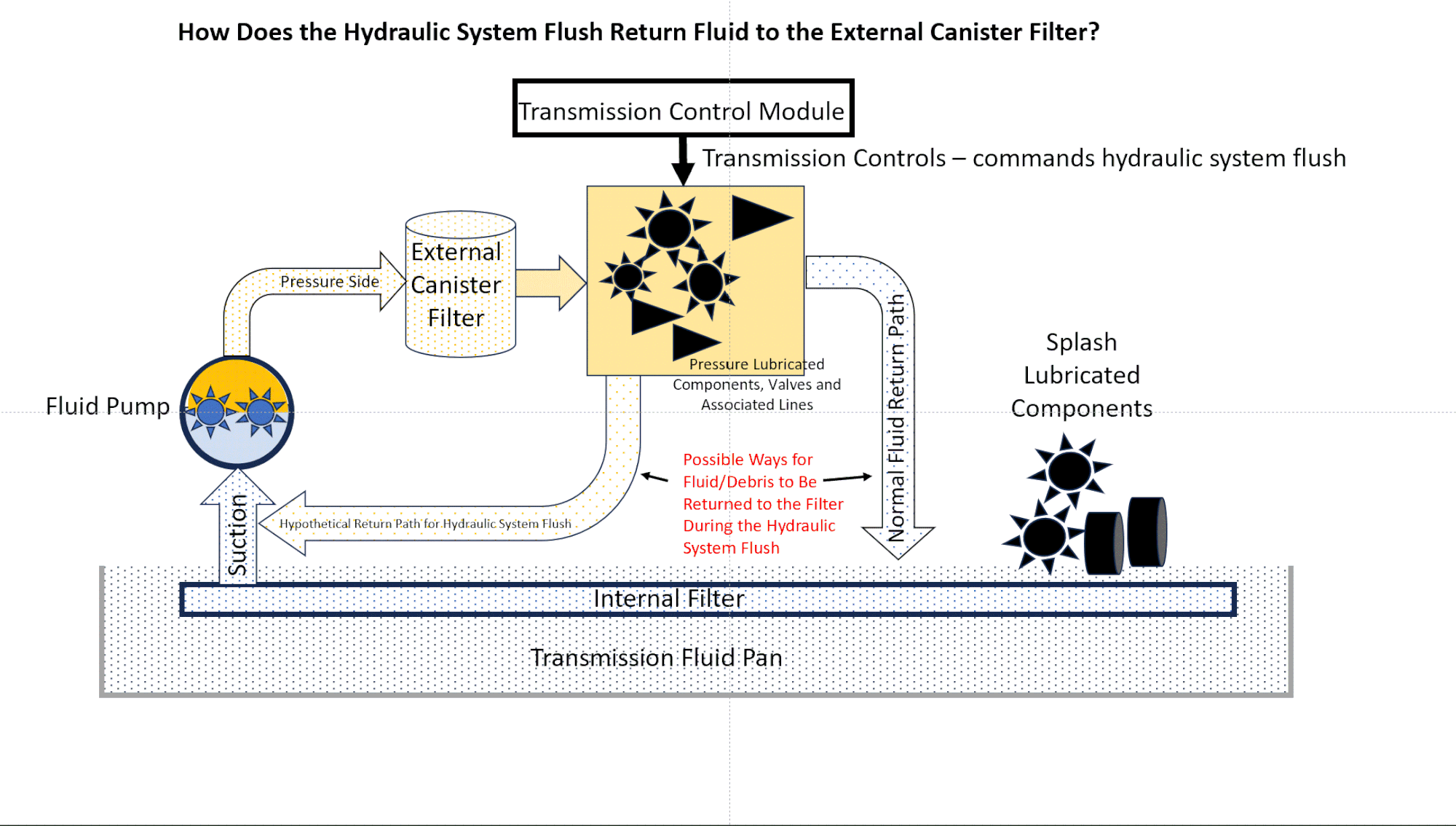

Default How is debris returned to the filter during the hydraulic system flush
Originally Posted by RKCRLR
I don't think we have enough information to say that the hydraulic system flush returns contaminated fluid to the pan. It is quite possible that the fluid is redirected to the canister filter without passing through the sump filter.
All that follow is hypothetical/speculation.
So, I gave this some further thought - and to do so would require extra valves to open and close a separate fluid return path from the pressure lubricated components to a point that is between the internal filter and the fluid pump, would it not? Attached figure 1 is my simple minded illustration of how the fluid flow my normally work. I have been called out before other threads for assuming how this flow works - so I want to be clear is hypothetical. In the first figure fluid is drawn up through the internal filter by the fluid pump, then sent to the external canister filter, and after that it flows to pressure lubricated components and the valve bodies, after which that fluid is returned to the pan. The first figure is based on an assumption that all pressure lubricated components receive fluid that has passed through the external canister filter, and that all that fluid is returned to the pan after it passes through the valves and lines. It also shows the there are some splash lubricated components (gears, clutches, etc) that ride in oil from the pan. The second picture allows for the possibility that there are other pressure lubricated components that do not receive fluid that has been through the external canister filter. As if it were a bypass filter rather than a full flow filter. I do not know if there are any such components. The third figure illustrates what might happen during the hydraulic system flush. The fluid/debris could still be returned to the pan, then makes it way back to the filter though the normal flow path. Or, it could be returned directly to the pump. To do would require an extra path, and some extra valving. It looks a little complex, which is the reason I first suggested it just returned via the normal path. I do not believe it could be returned to the filter at a point after the pump - the pressure differential would not allow that flow path.
Without having a hydraulic schematic we don't know the system operates. But it may be possible to have a circuit that returns fluid to the inlet side of the cannister filter by operating the valves in a sequence or putting them in a position that isn't seen during normal driving. And it uncommon for systems to have valve(s) that are strictly for servicing. The reason I question it going through the main filter is that is a lot of fluid to filter in a relatively short time and it would take many passes to capture a majority of the particles because of the dilution that occurs.

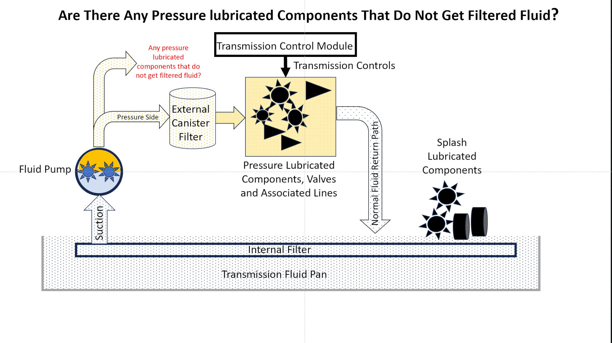

I think I see what you mean. Normally, the highest pressure in the system is going to be between the pump and filter, so it might be difficult to return something from downstream, on the other side of a valve because the pressure will be lower there. But I suppose there could be a way - I'm still having trouble picturing it. A valve that re-directs the pump pressure maybe? Anyway, this is just a discussion of how the contaminated oil gets back to the filter - but we know it does get that there - and that recently posted updated procedure drives that home by making the point that the filter must not already be overloaded when the hydraulic system flush is initiated.
I
If there is an electronically controlled pressure regulation circuit between the pump and the canister filter it wouldn't be that hard to incorporate a circuit that returns fluid to the inlet side of the cannister.
