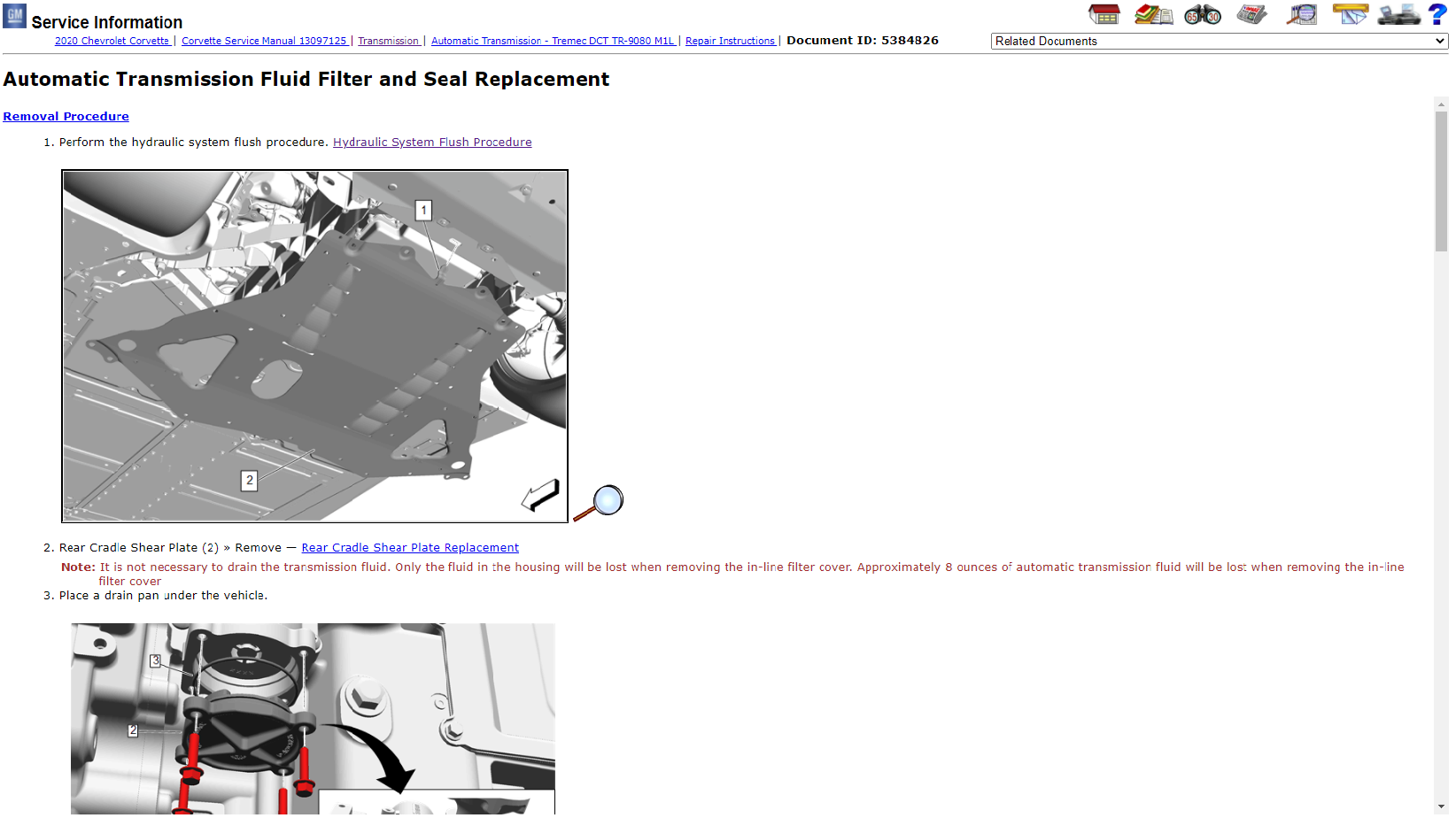

Step 1 of the filter change procedure per the service manual (Doc ID 5384826) is to perform a hydraulic system flush procedure:
It isn't contingent on if debris is suspected in the system.
The full procedure can be found in post #9 of this link:
https://www.corvetteforum.com/forums...ct-filter.html

I'll believe the procedure in the service manual over a YouTube video. The system flush only takes 8 minutes if you have the proper tool. According to @ChiTownVetteTech the system flush was added in the last few months. There was also a GM memo floating around (I don't know where it is now) that increased the labor reimbursement for the first filter change.

Flush procedure reads:
​​​​​​This procedure is used to flush the transmission fluid through the filtration system before a repair is performed that may have been caused by debris in the fluid.

I have some experience in technical writing.
If I had made the statement "Perform the hydraulic system flush procedure"; and then made the statement within the flush procedure "Description This procedure is used to flush the transmission fluid through the filtration system before a repair is performed that may have been caused by debris in the fluid" with the intent of the second statement to relieve the technician from the requirement to do the flush if just performing a maintenance filter change I would have been torn a new one.
The first statement is a direction statement with supersedes a general description statement. Also, if there are any conditions on performing a procedure they should be stated in the initiating procedure. You don't want a tech to have to branch to another procedure only to find out it isn't necessary.
While I agree the procedure may not be necessary from a technical standpoint we just don't know at this time with the documentation available. The only documentation I've seen from GM states it is necessary.
Don't get me wrong, I was hoping to do DCT filter changes myself. However, unless I see a superseding document from GM, I'm going to bring my car to the dealer do DCT filter changes and make sure they follow the procedure.

Let's look at some facts:
1) The service manual (at least the copy of the version posted) requires a pre-flush if it is interpreted using standard practices of technical writing.
2) @ChiTownVetteTech follows this procedure when he does a filter change. Some other people have reported that the flush was performed when they had their filter changed. Also, @ChiTownVetteTech stated that the flush was a recent addition to the procedure within the last few months. Coincidentally, there was a memo from GM about the same time that increased the labor rate reimbursement from 1.7 to 2.3 hours (see attachment).
3) The service interval for the filter is required more often than usual when compared to other transmissions. In fact, I haven't seen a situation before where a transmission filter change is required at twice the interval of a fluid change. This suggests that GM is very concerned about contamination in the DCT.
4) A flush procedure is commonly performed when operational issues are encountered.
There could be valid reasons why a pre-flush is directed per the procedures. I have some experience in filtration systems. Below are a couple of reasons I can think of but there are probably more:
1) There could be residual contamination in the system. Over time, this contamination could make it's way into the filter and impede its operation. Flushing this contamination into the filter before replacement may be required for the new filter to last until the next required interval. This could be especially true if the concern is silting where the individual particles are small enough to pass through the filter mesh holes but congeal on the filter.
2) Congealed particles trapped in a filter can break down over time and pass through the filter. These fine particles may cause problems with sensitive components. Flushing to remove as much of these as possible may be necessary to maintain proper operation between the required service intervals.
It's possible that the scan tool commands the transmission valves to perform operations not encountered during driving. It could sequence valves in such a manner that the passages have increased fluid velocity (perhaps even reverse flow) that could dislodge trapped contaminants and direct them to the filter. There may even be a specific service valve in the transmission that is only operated during servicing (this isn't uncommon in industry). It would be interesting to find out what the flush procedure actually does.
Its also possible that the flush procedure is intended to remove residual contamination from manufacturing and self-generated contamination during break-in. If that is the case, the flush at the first service would be the most important one.
As I see it, there are several potential reasons for the flush in the DCT filter change procedure:
1) It is a mistake to have it in the procedure.
2) It was always intended to be in the procedure but mistakenly left out and subsequently added.
3) There is another area in the service manual that gives relief on performing the flush but we haven't seen it.
4 It is only intended for the first service but the manual errantly requires it at every service.
5) Some initial problems with the DCT were traced to contamination issues and GM determined that the flush should be done at every filter service.
I'm just trying to get to the bottom of this.
