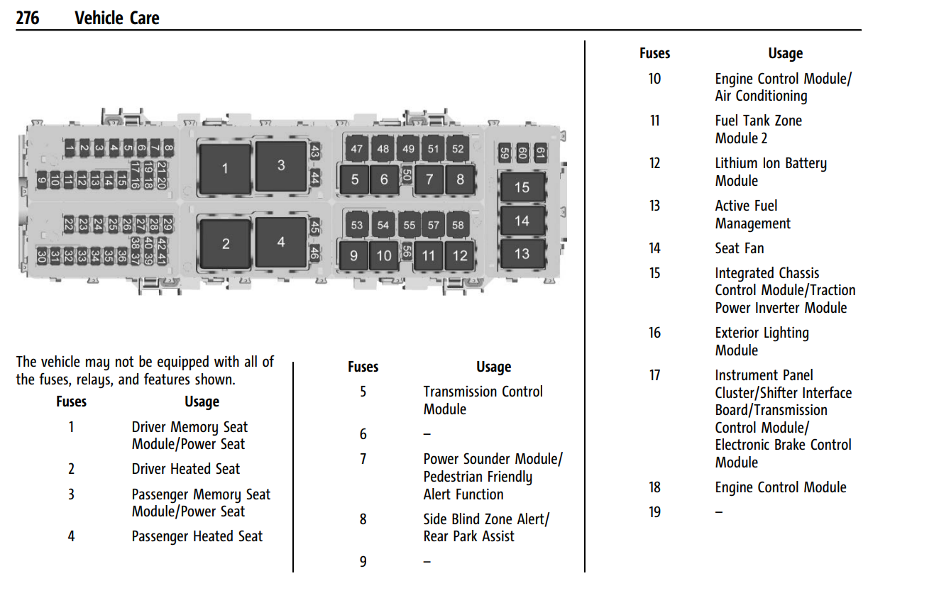

So, you're saying the 2024 Owners Manual is incorrect?
Page 276 of the downloadable version shows it as
Better let GM/Chevrolet know, then?
Is there a thread on removing it will throw a code?
If many have reported it, I'd guess there is?

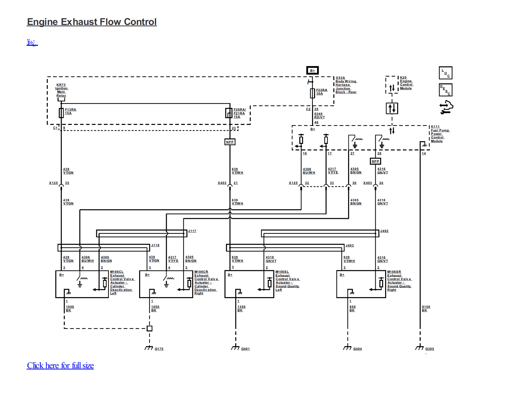

No, the manual is not incorrect. But what he said is correct. Fuse 13 in the rear fuse panel is for the cylinder deactivation exhaust flow control valves (the AFM valves in the muffler). And yes, pulling it will set a DTC. The other fuse that controls the "tailpipe exhaust flow control valves" is a double fuse 20/21 also in the rear fuse panel. Pulling it will also set a DTC. And it will also disable some inside rearview mirror functions because that is what the other half of the fuse protects. Neither one will directly disable the actual cylinder deactivation functions.
When AFM activates, it closes the AFM valves in the muffler (and also the tailpipe flow control valves). It also activates the soleniods that cause the valve lifters to collapse, as well as introducing some micros slip in the clutch (reference the MidEngine Revolution book), and shuts off the fuel injectors to the deactivated cylinders. No single fuse disables all of that. The fuse for valve lifter solenoids is 31 in the rear fuse panel. It might cause AFM to be disable (folks have speculated) but you can see from its description in the Owners Manual, it also will shut down other things - and very likely set a DTC as well.
