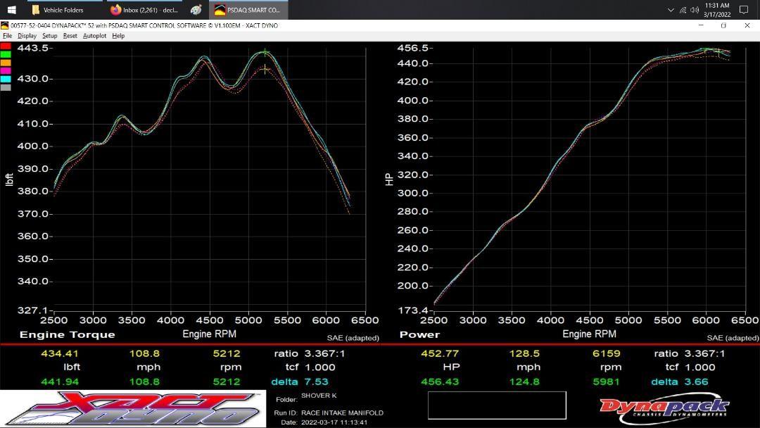

Dyno numbers from 3 weeks ago with the following mods:
Halltech Hornet Cold Air Intake
Gwatney 95mm Intake Manifold
Soler 95/100mm LT5/ZR1 Throttle Body
Soler Throttle Controller
Fabspeed HJS 200 Cell Cats
RWHP 453.53
RWTQ 437.44
Comparison Dyno numbers from today with the following mods:
Lingenfelter pTR Carbon Intake Manifold
RWHP 456.43
RWTQ 441.94

Well... Crap man. I'm sure those weren't the results you were hoping for. Think you swap back or just leave well enough alone? Gains are gains at least!

How does this compare against stock z51?

Being absolutely robbed of power based on that curve. They need to crack the ecu so bad

It didn't surprise me at all. History has shown that the stock ported manifold Intake makes similar horsepower than both MSD and this lingenfelter Intake as well. That is probably one of the reasons Lingenfelter is highly recommending the 95mm TB....to show even additional gains if any. So without the 95mm TB we have no idea. Thanks for posting Arizona Z06.

NA mods are a tuff game. Especially with no tuning. Thanks for the follow up.

Yes agree our nature is we all can't get enough HP/TQ.
However, still pleased as compared to C8 stock numbers of 429/410, this particular C8 has seen an improvement of 27.4 RWHP/32 RWTQ along with a reduced curb weight, I'm good with it.

That's what counts.....as long as you are good with it. But you sure did opened up some eyes. Members now can make a wise choice regarding those two application. For probably a comparison......Matt the youtuber, installed the AWE Exhaust system which claimed 19 rwhp, ported 87mm TB to 91mm, ported intake manifold by Carlos RIOS, Blue Attack Filter, Michilen 4s and the soler Throttle controller. Drag strip numbers results in good air 10.93@122.51. Done at Bradenton Motorsport Florida. He eventually went with the ported 95mm to 100mm but it appeared that the car went slower certainly didn't not improve his ET. Hence should have stayed with the 91mm. Or maybe the track conditions were different. His latest dyno results was 435 rwhp....not even close to your results. Bone Stock C8 same dyno and time 424rwhp. I hope that makes you feel even much better.

So virtually no horsepower gain on the ptR from a ported stock intake. Glad I didn't drop the coin on one.

I'm happy with the pTR. One difference between the two Dyno's I failed to mentioned is that the temperature was 20 degrees cooler on the first Dyno. Not sure if it means anything.

Dam.Having a car stuck at around 450 rwhp would blow. The most enjoyable part about having a fairly quick car is the ability to make it faster about every year. But really all that matters is that YOUR happy. Enjoy it.
