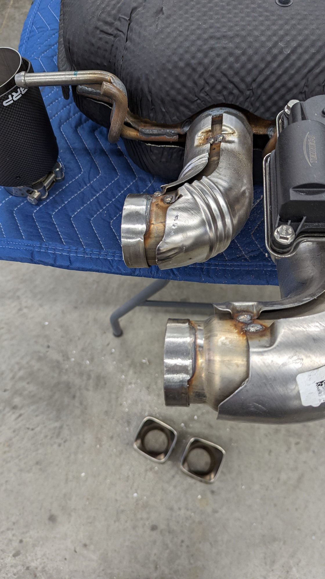

hi @EC145pilot: thanks for your time on taking the pic, the photo address my concern about that hole may send heat to the surrounding plastics during harddriving......

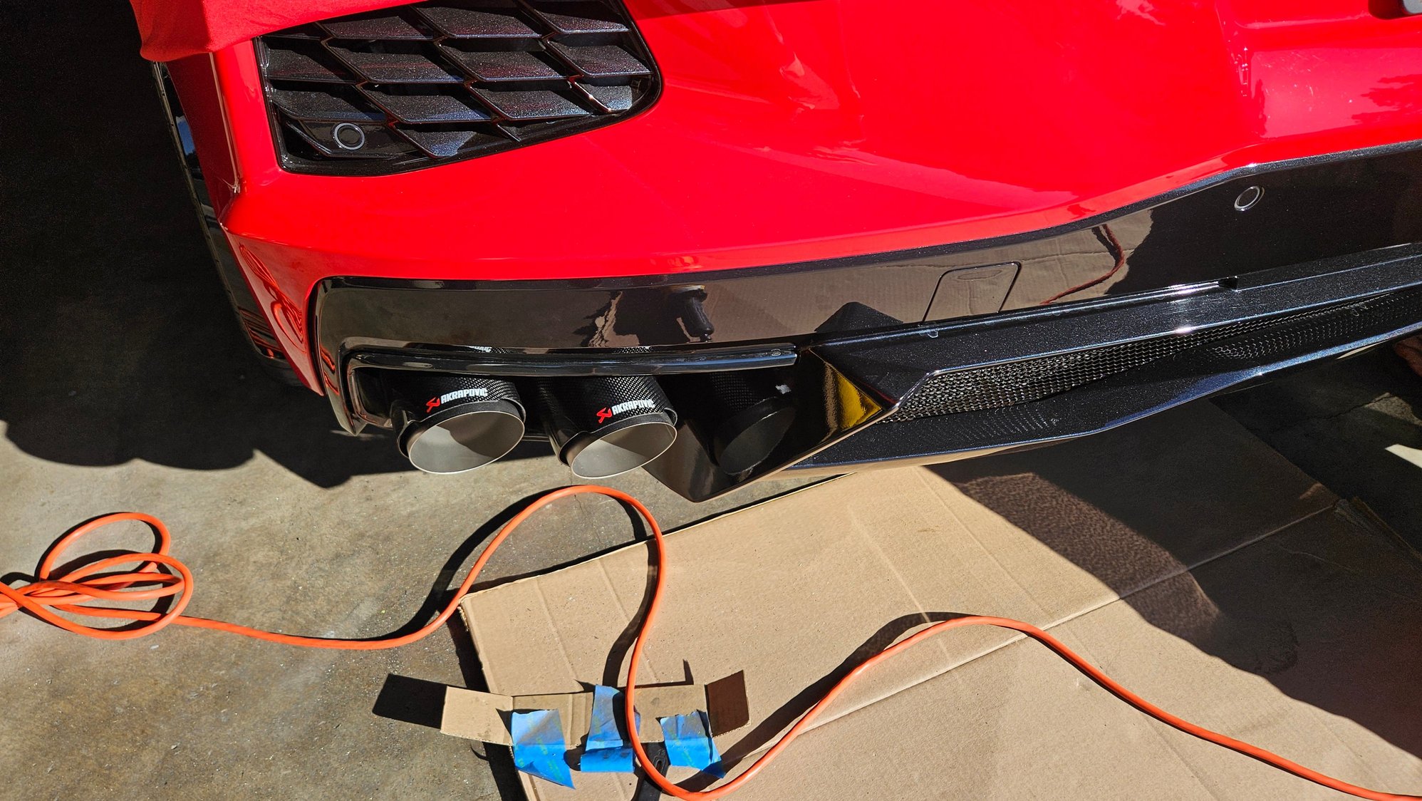

I installed my tips yesterday. I used my 20V DeWalt die grinder with 2 inch cutoff wheels. It took about 10 minutes to cut off the tips. Another 5 or so to grind the factory welds a bit. Another 15 to install the tips. No bumper removal, and very easy. Cost was $177.00 complete. Ebay tips.
