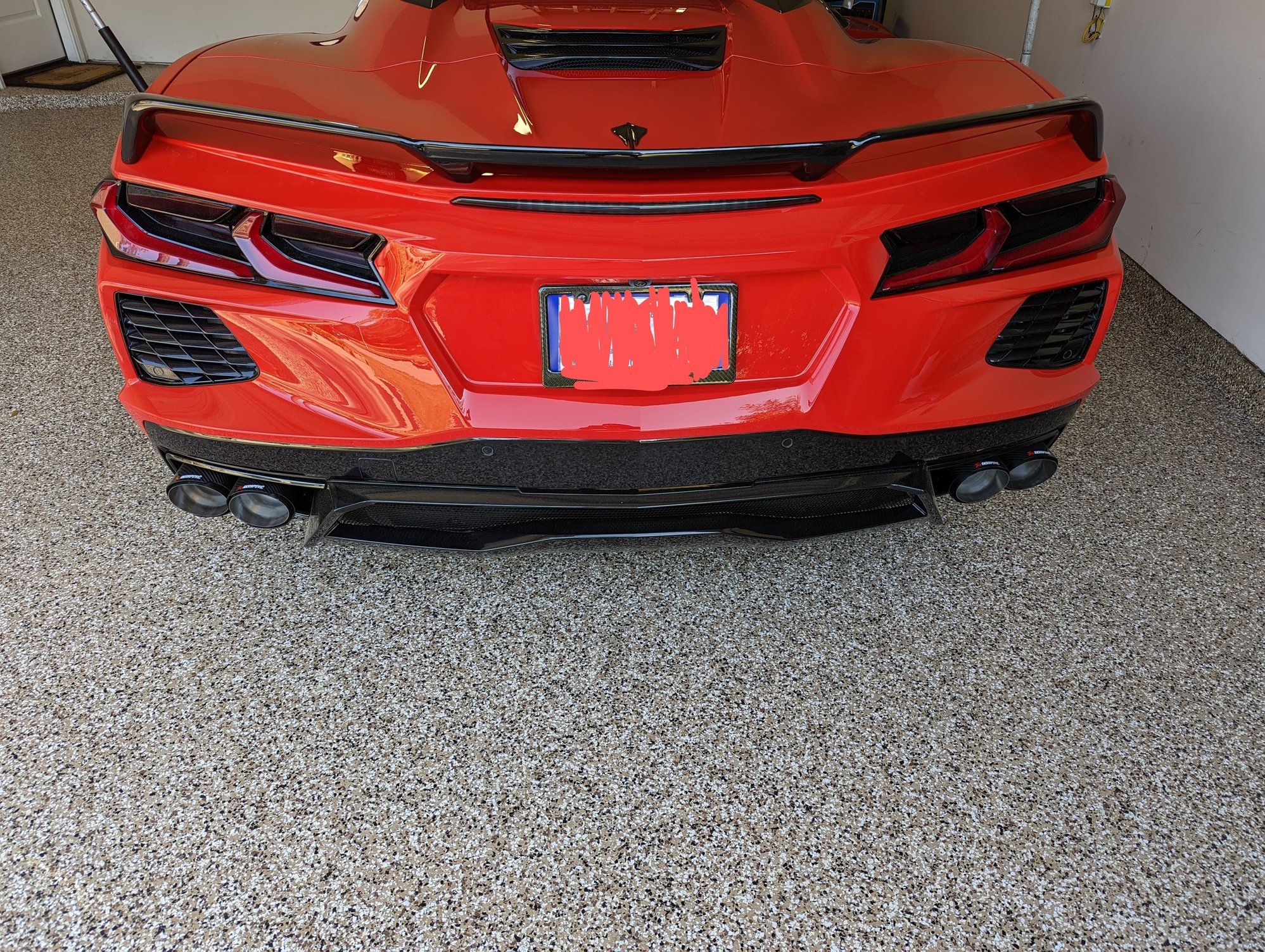

I got my C8 home from the PPF shop yesterday and decided to do my first project. Replacing the square tips. There isn't too much info out there on how to do it so I thought I'd start a thread in case people had questions.

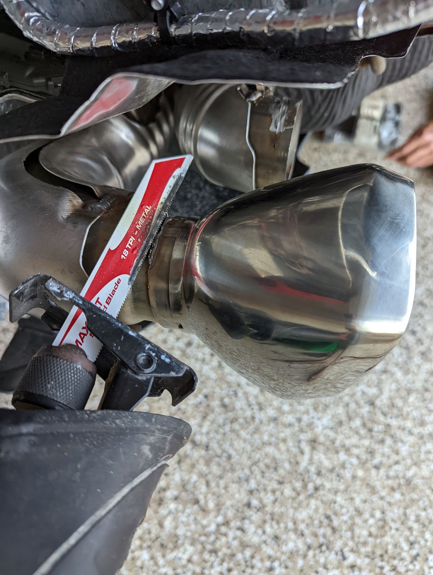

The best tool to cut the tips off is actually not a Dremel. It's actually a jigsaw with a good metal blade or 4. What you want to do is cut parallel to the exhaust pipe as shown in the pic below. There are 2 welds about an inch in length on each pipe. I cut the weld on the top and bottom on the first tip and slid it off. On the rest of the tips, I cut the weld on the top off and then bent to tip up and down a few times and that broke the bottom weld off. Then I used a 4" grinder to smooth out the weld line. I bought 60MM Inner diameter for the inlet and 110MM (4.5") for the outlet. They fit perfectly and really filled out the space. Hope this helps someone else that's trying to tackle this project. It took about 3 hours to do. I'd say 45 minutes was wasted on using a Dremel without any good results. Once I got the jigsaw out it was WAY easier.
The angle was actually flatter than in this pic. Pretty much flat against the pipe.
There's about a 1/16" of an inch gap between the pipes with 4.5" tips.

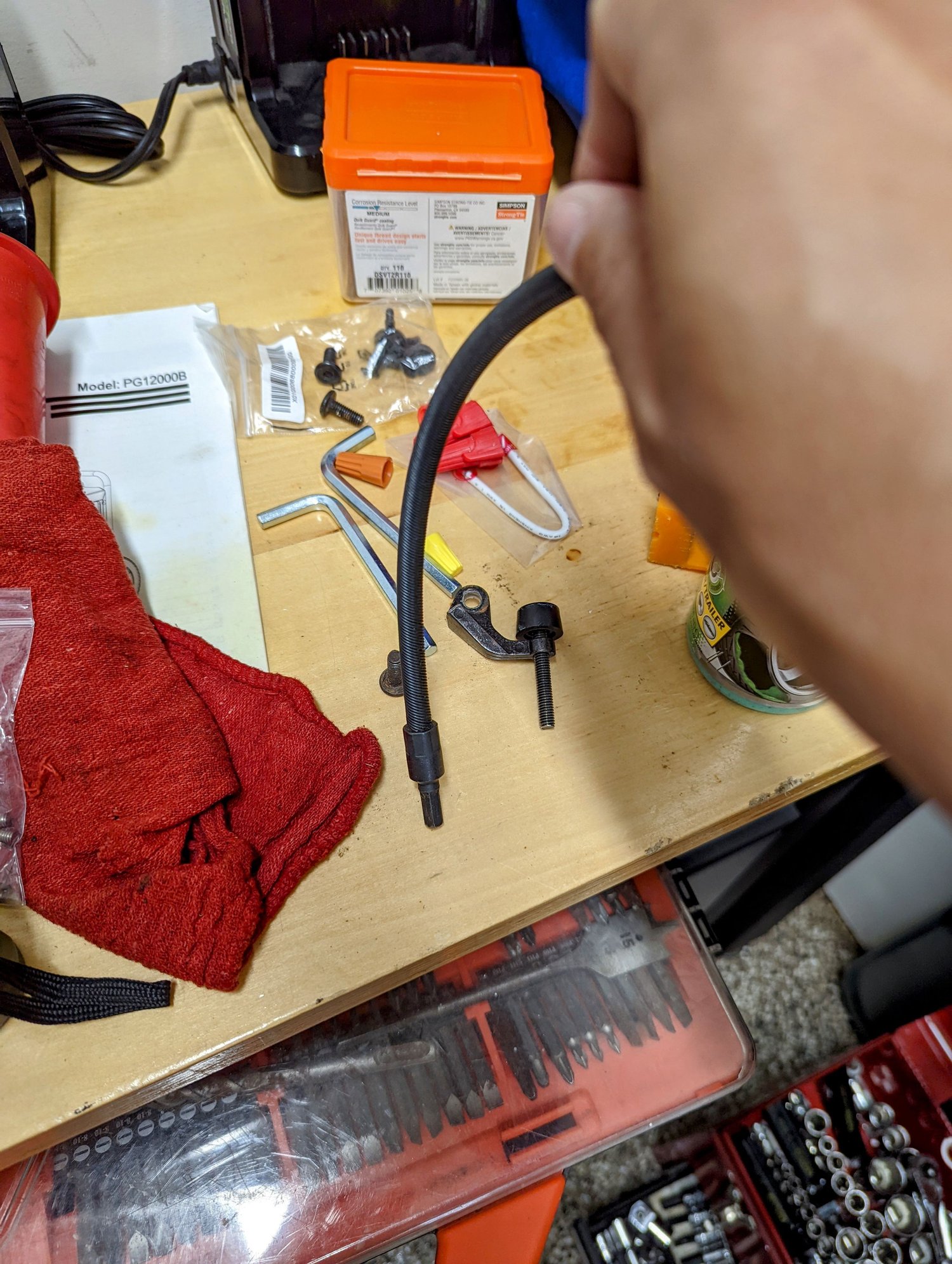

This is the tool I used for that nut on the right side of the car. Made the job really easy.

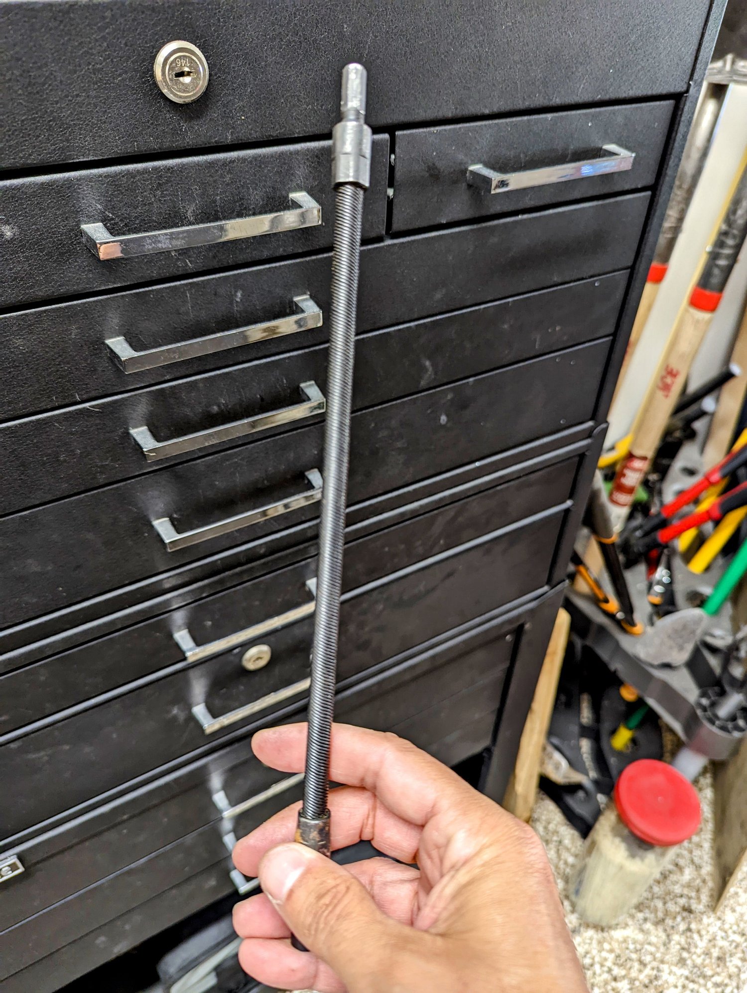

Just showing how it bends.

what is the length of your flexible extension? did you need the full length? i left that bloodclot nut off when i re-installed the rear bumper because it was such a PITA

They look great.
How are the Akrapovics attached? Did not see that info…unless I somehow missed it.

What an improvement on the exhaust; I do not like the factory tips either.
I think it's 12" but I added non flexible metal socket extensions to get it to reach.
They're installed with clamps. I'll add the link to the ones I bought from eBay.
https://www.ebay.com/itm/Glossy-Carb...-127632-2357-0
Thanks everyone. Between that and the tinted tail light inserts from paragon I'm really liking the back end a lot better.

The pipes themselves are 2 1/4" so you want something that's 2.35" inner diameter. It looks like what these are based on the description. I wanted to go the all black route but it was almost impossible to come by. The only place I found is in the link below but they were out of stock at the time and said it would be weeks before they got more. They're also about double the price but they have 100% reviews so the quality will be good.
https://www.ebay.com/itm/2-GLOSS-BLA...-127635-2958-0
These are from what looks to be the same seller as my tips for a little less than the ones on Amazon and they are USA stocked so you'll get them way faster if you decide to go the 4" route.
https://www.ebay.com/itm/2x-Glossy-C...-127632-2357-0
Hope this helps.

@IRpilot.....how you align the tips, so when installing back the bumper, they do not touch the bumper?

If you look at my pic with the saw blade, you'll see that the outer pipe flares out as it goes back. I just pushed the tip all the way back until it rested against the flare. That flare makes it perfectly aligned.Then I adjusted the inner tip to match the outer. Once all the tips were on I eyeballed both sides against each other to make sure everything was lined up before tightening them all the way. Good question, I should of mentioned that in my first post.
Thanks for the info!

Yeah the 4.5" tips pretty much cover up all the reflective heat shield that's behind them. I was initially going to paint that area but the 4.5" tips filled the space really well.
