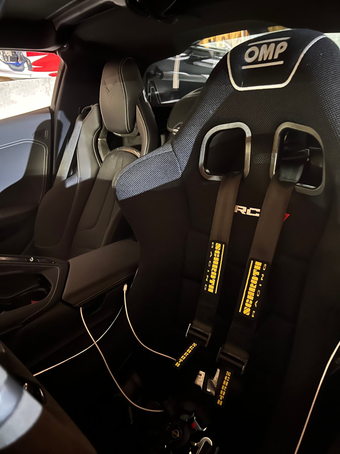

you will get the following errors
1. “Service Airbag System”
2. “Service Safety Restraint System”
both of which you can use the right steering wheel button to ignore.
the airbag light will be illuminated
im using an OMP WRCR. AMT mounts

What are the safety implications of putting in a race seat that disables all airbags while not having a welded in roll cage?

AFAIK, whatever airbag is remaining still works. So only the seat airbag would be missing. The race seat provides better protection for that scenario, but it's obviously not tested by the car manufacturer.

Correct, the remaining air bags still function as normal

In theory, you could disconnect all of the wiring underneath the seat and plug it back into the harness and stuff it under the seat. This would have to include the seatbelt buckle. Seems like a waste of time for two error notifications that can simply be ignored with the push of a button

as far as we know, the airbag system is unaffected by installing race seats. It doesn’t disable all the air bags just the ones that aren’t connected anymore.

And is that just the side curtain airbag attached to the seat? Not sure of any others connected to seat harness but could be.

correct

I’ve had my race seat in for about 8 months, John probably has his in there for two years at least.
neither of us have had any issues.
you will get a dash error message, which you just click to ignore the box pop up. Then you’ll see the red airbag light which is on constantly. Also the seat belt light will be on constantly. Oddly it doesn’t chime which would be super annoying so I’m grateful for that lol.
you’ll also get notifications through onstar that there is an airbag issue but that’s to be expected
