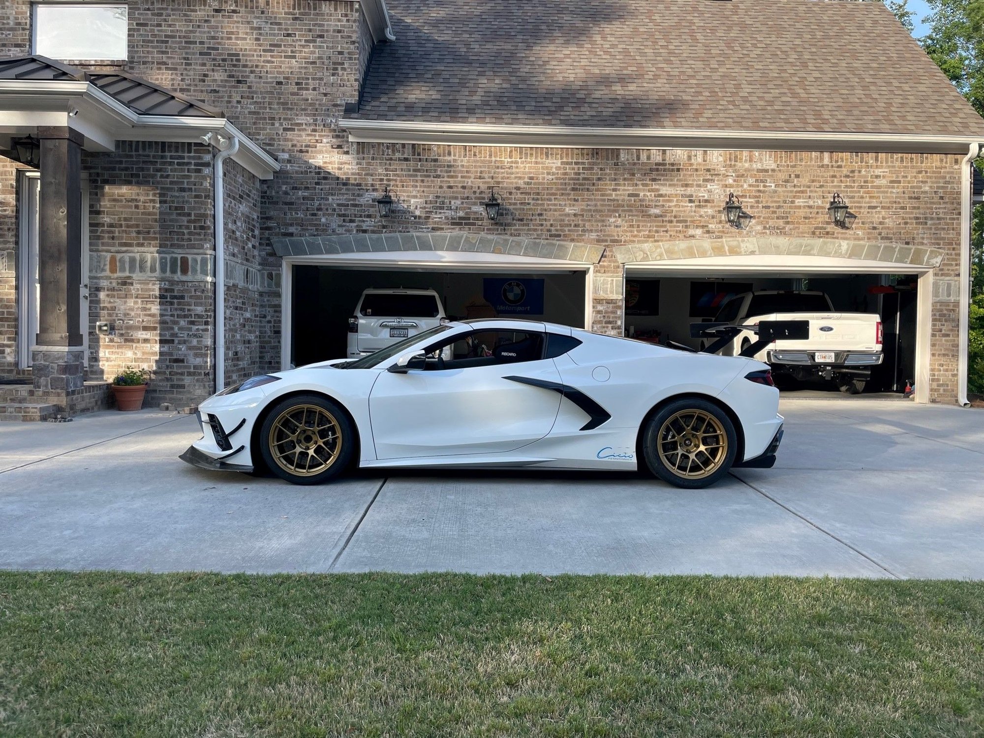

If you are on Facebook you may have seen some of the below pics already; i tried to expand on some things because its much easier here than on Facebook.
I have a fairly robust post in the track section of the forum about the development of the car, admittedly I do need to do an update to that thread but I have seen that many people from the C8 community don’t venture into that section of the forum so thought it would be cool to show those how the other side lives 😉 This has been a project for a couple years now, its really getting good at this point and we have learned a ton along the way. A lot I have shared with the community and some I haven’t. The uproar from people as we pointed out the shortfalls and compromises made in the car when it was first released were very fun to deal with… the corvette community is certainly a special group of people, haha.
Feel free to go read some of what we learned here: https://www.corvetteforum.com/forums...-modified.html
Wanted to give some update some updates on the car since we have made some cool changes in the past few weeks that people may be intrigued by.
First, thanks to MRR for producing their new track wheel Forged FR43, its an 18x10 / 18x12 wheel with the perfect offsets. Months ago Carlos and I traded messages and notes with regards to the right offsets for 18s, using what I had learned and what Carlos had gathered after producing 1000s of sets of wheels he really hit a home run on these wheels. Fit is great. They are lightweight, and include an uncoated knurled bead to help hold the tire in place. I love my forgeline wheels but I was a little sick of running spacers to get the offset perfect so I’m pumped to get these on the car. Here are some pics….
The next update I have been working on was an intake update. I had been seeing some interesting data from track sessions; as we continue to push the car and shoot for laptimes we started to notice the car fall off after a lap or 2. I leaned on Cicio Performance a little bit to help diagnose but it didn’t take much, he knew the issue, IATs & the car pulling timing. The car is VERY sensitive to MAF readings. The car is completely over engineered from an engine cooling perspective, much better than the C7 in nearly every regard however the intake on the car is a bit of a compromise… It’s the perfect intake to maintain trunk space (Gotta fit those golf bags!) and be completely unobtrusive. My car being a track car affords me the chance to make some changes here and use some space to our advantage. Now before everyone claims I’m wrong here and starts preaching to me that “The cars at Ron Fellows don’t pull power” or “My C5 track car from 15 years ago makes me an expert”; please keep in mind I am not trying to sell you anything, I’m only documenting my journey, We didn’t get here by guessing either. Trying to extract every last 10th out of the car you start to micro analyze the data and things become apparent.
What I did was modify a K&N intake; the K&N intake comes with a heat shield that blocks it off from the engine bay and more or less seals the intake compartment from the engine bay… I took this design a step further, put more heat shielding on it, modified the MAF tube because the one that comes with K&N’s kit sucks… I sourced a MAF tube with proper air straightener to ensure the MAF gets a clean signal. You may recall in Paragons intake shootout they mentioned that the K&N had the worst MAF signal, this is because the MAF tube is right after a radius bend, I switched this out to a straight MAF tube with air straightener, works perfectly and idle trims and other fuel trims appear to be very happy.
The next piece of the puzzle was COLD air, we didn’t want any of the air from the side blades, the air from the side blades isn’t ambient… again, I’m not trying to start a war here with this comment… Sorry to burst everyone’s bubble, its not cold air coming into the side blades. I leaned on some friends here to help me solve this problem, I think we came up with a pretty trick solution. Taking a page out of the C8 Racecars play book we came up with a hatch scoop. 5 3D printed prototypes later we have a nice piece that I spent the weekend doing some body work on to make it look good enough. Still fine tuning it in the trunk, I’m using the scoop to provide cool air to both the intake and to keep my remote reservoirs on the MCS 3 Way shocks cool, without the scoop these would get so hot in the trunk that they couldn’t be touched until they cooled down after a track session. I’ll be building a full custom airbox but as it is right now the scoop is functioning quite well and doing what it was designed to do.
Here is what I used for motivation:
Here is the result:
Heading to Road Atlanta on Tuesday of next week. We have gone 1:29’s on a 200TW tire, we are hoping to dip into the 1:28s on a similar tire. Once someone comes out and says they have also run a 1:29 at RA in a C8 we’ll throw a slick on the car and really put down a time… so someone please come chase the time to give me an excuse to buy some slicks. HAHAHA.

OK, very interesting. I appreciate the hard work and tedious testing that you are doing. I assume this is primarily a track car. The added scoop doesn't affect the street look too much. As designed, I am guessing you do not drive in the rain. How did you come up with the inlet size and shape? What is the inlet area versus the MAF or MAF tube area? How did you choose the inlet height off the deck? Is in the laminar flow or clear of it. Are you an engineer by trade, or are you kind of wing it? Not that winging it is a bad thing, many very successful racers have done great things just by trying different things. Smokey Yunick comes to mind.
Good Luck!
Nice artwork on the driveway!

I'd like to take credit for the artwork but there again; had to bring in a ringer for that work. My 7 year old daughter.
